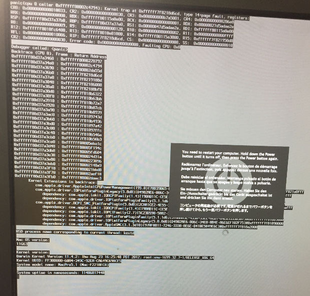

2009 firmware updated to 2010. Delided w3670 xeons to upgraded 8 core to 12 core. Each new cpu will boot up in cpu A with fast fan, but when either one installed in cpu A and B I get a kernel panic.
Suggestions please.
I may be wrong, but you need "X" Xeons for paired use. "W" processors will not work.
So you need a pair of X5680 or X5690s to work (or 5650, etc).
OMG 🙁 I hope your are wrong, but if you're right = what a BIG dumb mistake. Can anyone else "chime" in on this please?
Ouch because I have never done a delid process but sounds like a bit of a pain in the arse! Yea you delid on CPUs that cannot run in a dual CPU system. So that work was in vain. Unfortunately this looks like an important detail you missed. Give this thread a real good look over on the whole topic. You need two CPUs that have "Dual Xeon" capability. W3670 is just "Xeon" so only works in a single CPU system
https://forums.macrumors.com/threads/mac-pro-cpu-compatibility-list.1954766/
Ok! 🙁 Thanks to all who responded. I guess I'll try to sell them on Craigslist; don't know if there's a market for these delided. Worth a shot anyway. At least I know I can delid without a problem, but what an expensive "testing method." I put the the originals back in and booted without issue.
