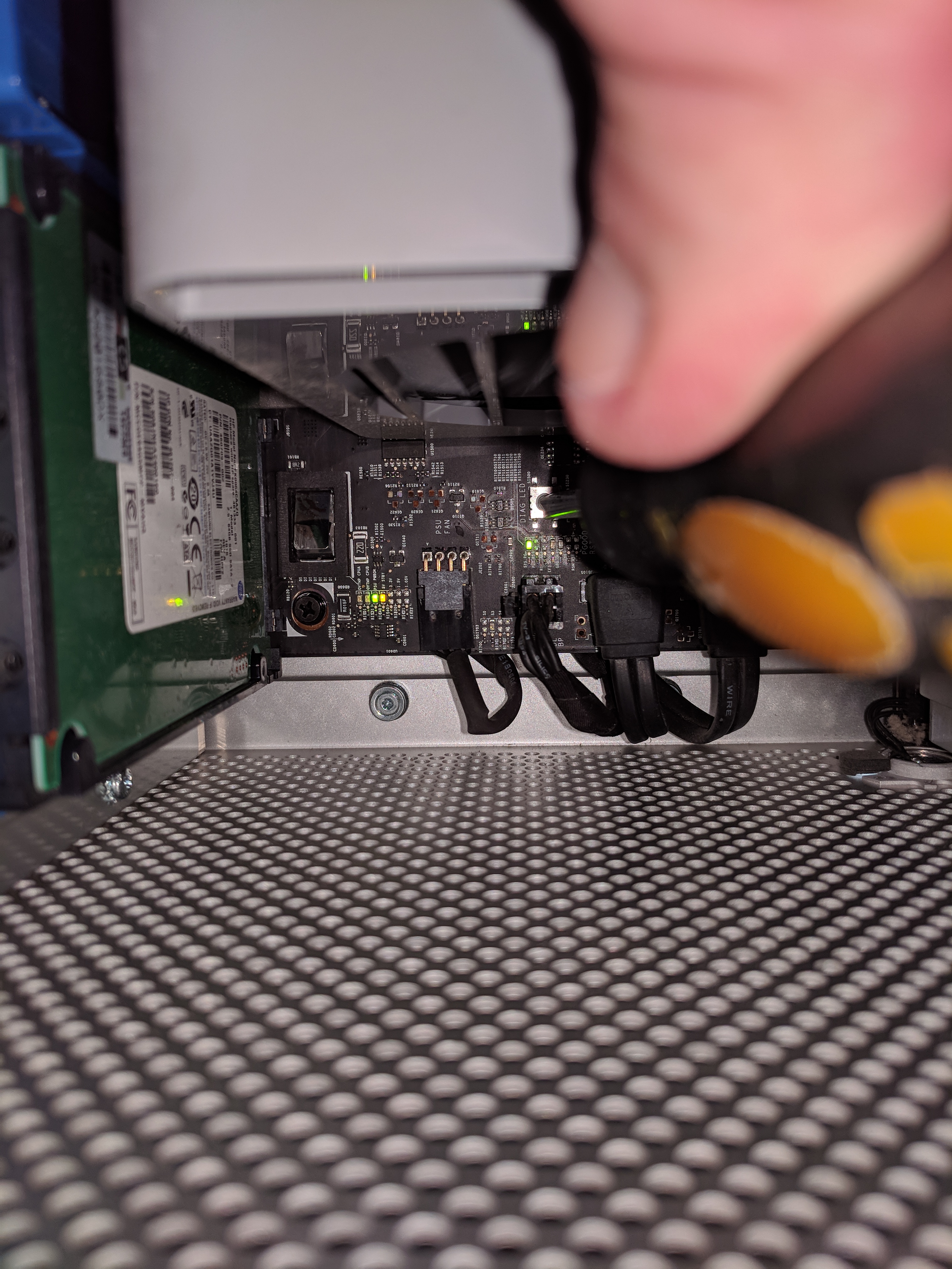

[doublepost=1539422014][/doublepost]did some extended testing, the diagnostic leds see on the picture.
I changed all the parts from a working 4.1 still 0 success.
Tried the restoration dvd but when I hold the power button and it starts blinking it does not give the beeeeeep nor open the tray.
If i open it myself or insert the DVD before does not work either.
Tried all the PCI-E slots with a confirmed working Graphics card, 2 of them both Apple riginal GT120 and 5770.
Running out of ideas🙂
The CPU tray works 100% also with original CPUS.
I tried a working DVD rom from an other mac which I used to burn the restoration DVD.
Any suggestion?
Any suggestion?
If you tested all parts, your backplane is the problem. Probably your BootROM is corrupted or you have a hardware problem. The next step is desoldering the SPI flash memory, reprogram it with a external programmer and soldering again.
