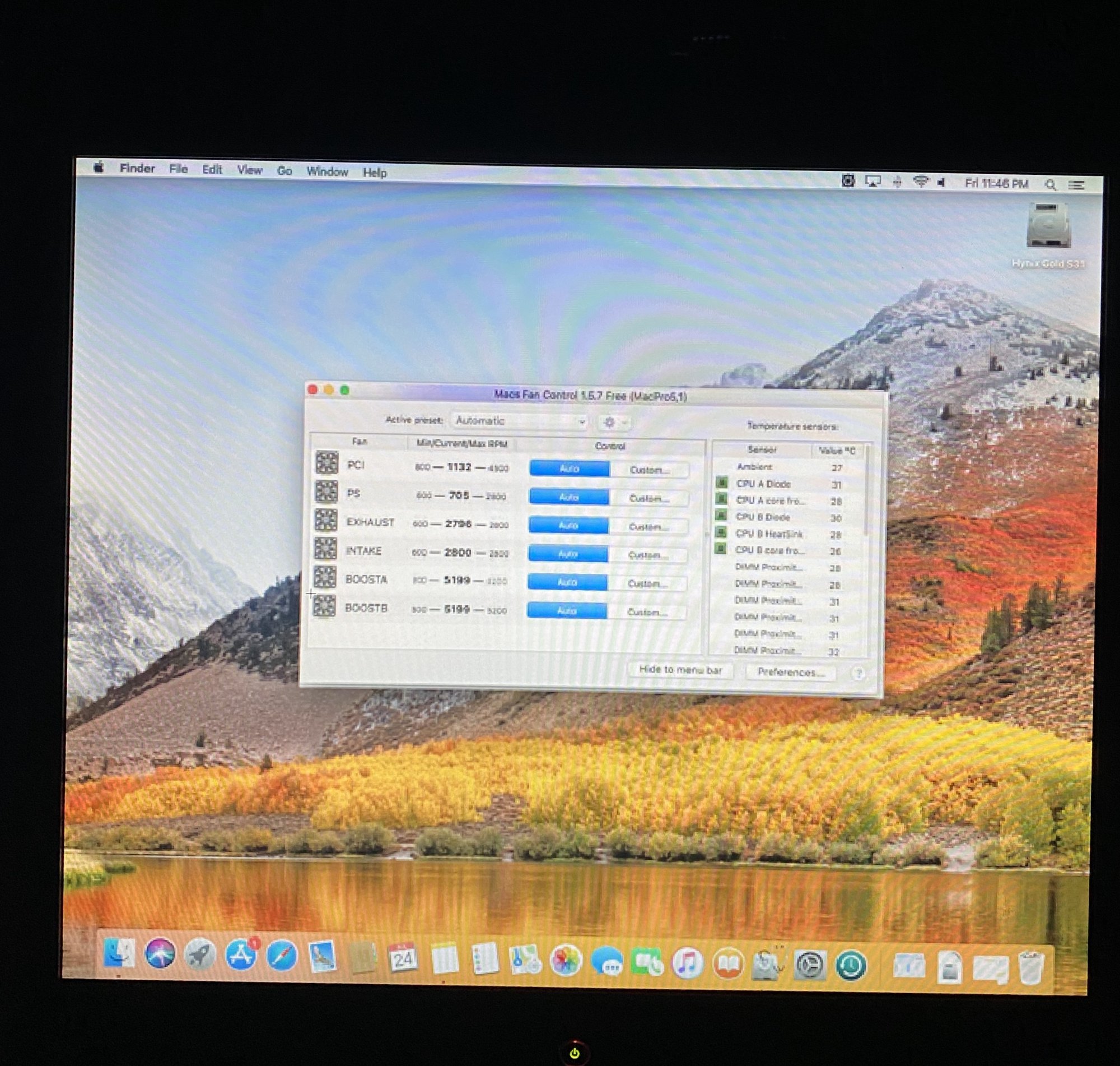

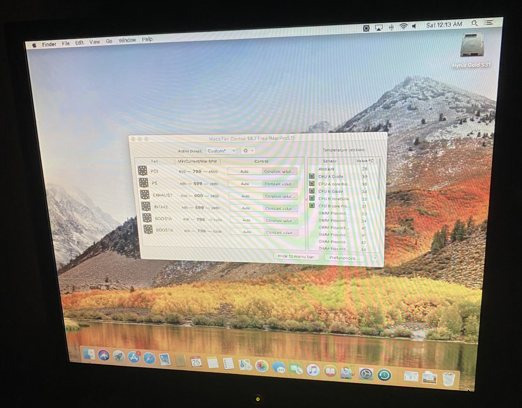

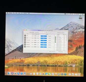

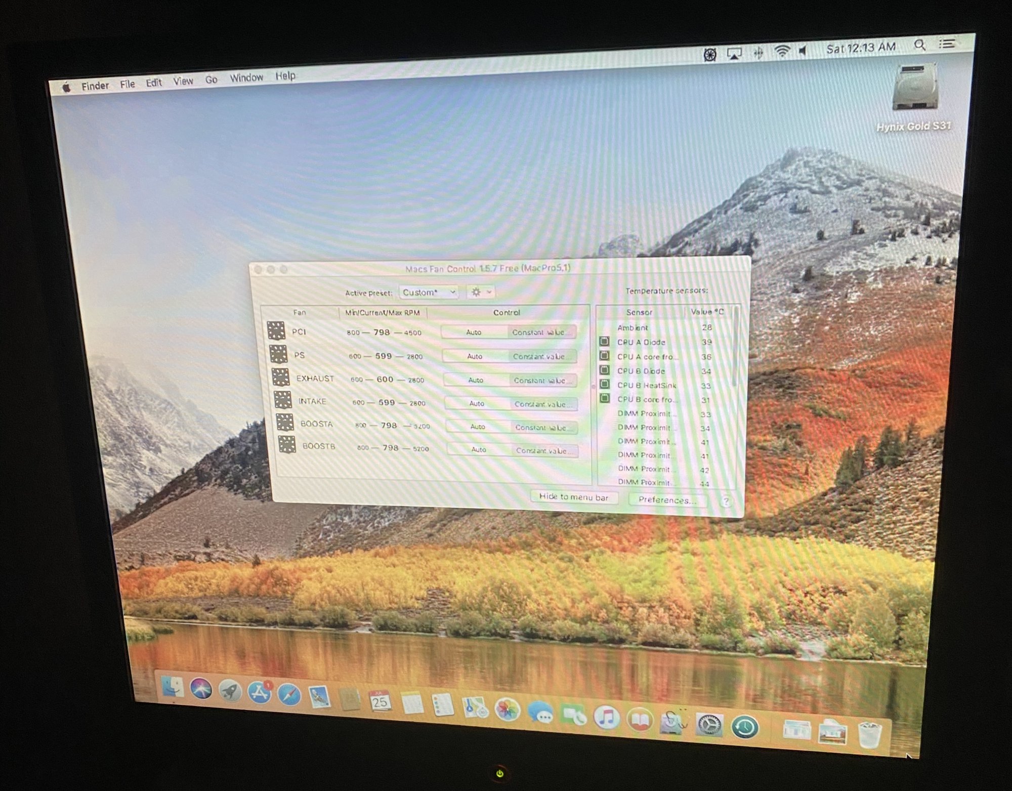

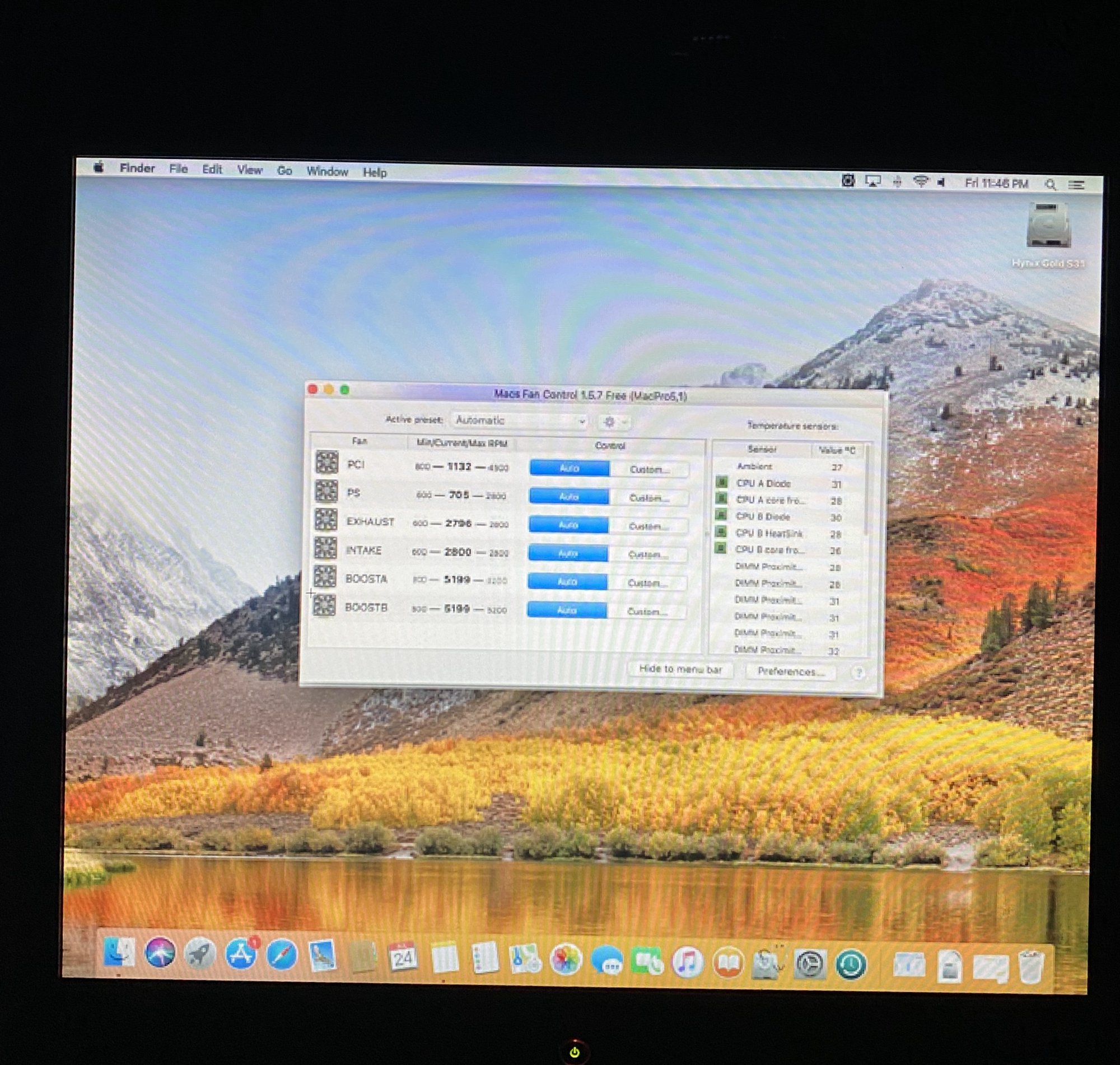

I'm attaching some photos of the Mac Fans Control before and after slowing the fans down. The fact that it is responding to manual adjustment of the fan speed seems to tell me that the fans are connected properly. The system recognizes both CPUs, so I would think that my heat sink torquing went okay.

Did you check the NorthBridge?
The screenshots don't show much more than the CPU Temps...
EDIT: Where is CPU A Heatsink sensor?
Reactions: h9826790
Okay! You are spot-on! I don't see it either. That has to be the problem. But what would cause that? Could the power connector to the heat sink not be fully seated in the connector on the tray circuit board?
