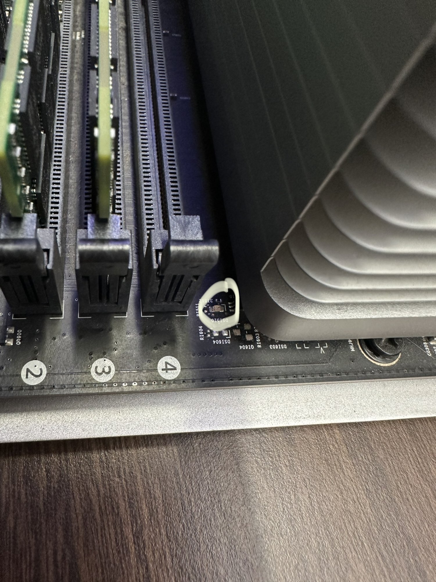

I have a 2009 Mac Pro I have been upgrading for video editing. I’ve replaced the dual CPU’s, graphics card etc. Everything was working fine until it decided not to boot up. Power light is on but no boot chime. I suspect the motherboard because heat sinks are not heating. There is a red led that flashes briefly. I took a picture of the led that flashes. Anyone have any suggestions. I’m not a computer expert so any suggestions would be appreciated.

the red flash on start is normal, you might try a RTC reset (instructions in the technicians manual if you have it), as that can clear boot issues like power on, fans, but not proceeding to bong etc.
There are loads of threads here from previous users that you can get more info and help on how to diagnose your Mac Pro via DIAG leds, no need to rewrite here, but in the end the only shortcut is to test your CPU tray with a known working Mac Pro and a known working CPU tray with your defective one.
Don't get me wrong, but Mac Pros are extremely difficult to diagnose for people without experience/knowledge and practically impossible without a test mule. Test your parts with a known working Mac Pro to identify what really failed.
Don't forget to also test the PSU.

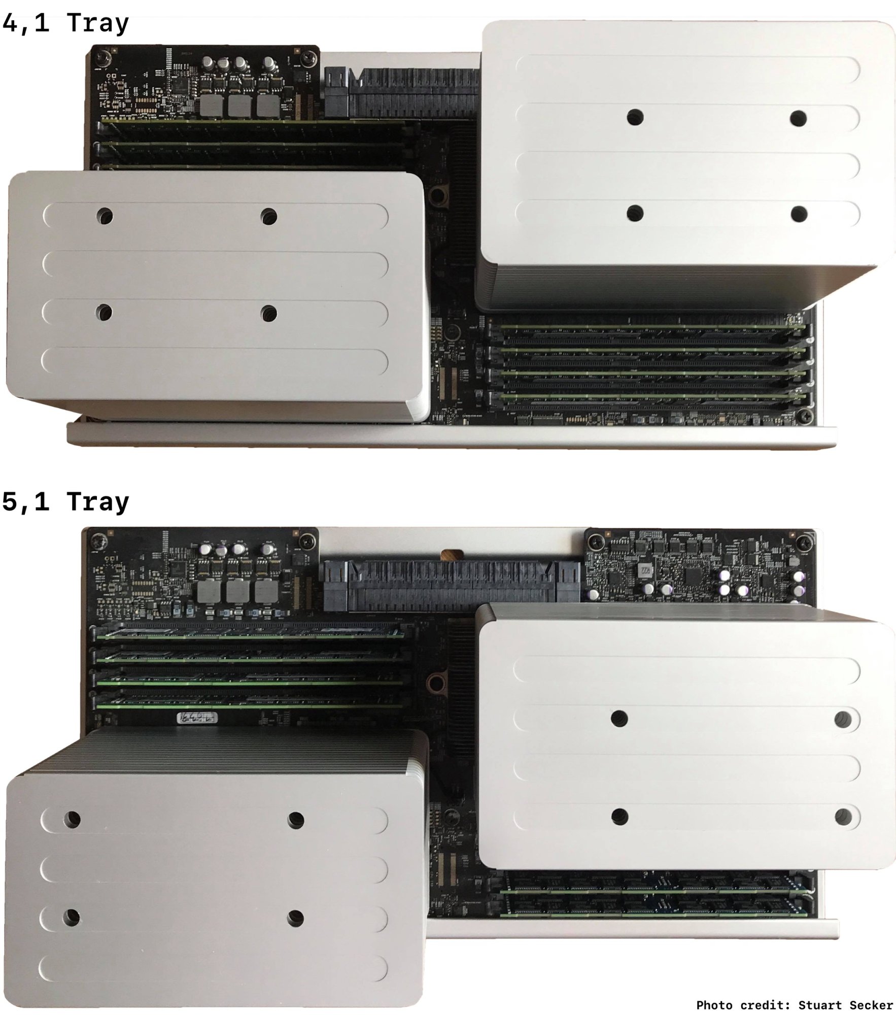

Thanks for clarifying. Just to add, another way to check if the CPU tray is a 2009 4,1 or 2010/2012 5,1 is the distance of the four holes on the heatsinks. The 2009 CPU tray has the 4 holes closer to each other. The 2010/2012 cpu tray has the holes farther apart. With the other 2 holes closer to the edge of the heatsink. I saw some CPU trays being sold online that are misdeclared by the seller. Like a 2009 tray being passed on as 2010/2012 or the other way around.

Yes, but this is valid just for the dual CPU tray.
For single CPU trays, it's a lot more complicated, you can't even be sure that the part number silk-screened to the PCB is 100% safe, since Apple re-flashed mid-2010s CPU trays with 1.39f5 for early-2009 CPU tray repairs.
It's rare but some people here have these refurbished mid-2010 CPU trays re-flashed with 1.39f5 firmware version.
If the single CPU tray serial number label have a 17-digits serial number, all factory refurbished CPU trays and backplanes after the year 2010 have a 17-digits serial number, the only way to be 100% sure is powering it up and checking the SMC firmware version.

Yep, I was only referring to the dual processor tray. For single processor trays, it’s a different scenario. A client of mine sought my help to purchase a 2010 dual processor tray. I encountered a seller from Facebook who was selling a 2010 dual processor trays but he could not provide a screenshot of the smc firmware if it is 1.39f11. The seller no longer has the complete Mac Pro computer as he sold them as individual parts. That was when I had to verify with the seller the actual photo of the tray to double check. And to be on the side of caution, I requested the seller to agree that I can return the processor tray in case of problems. Thanks
