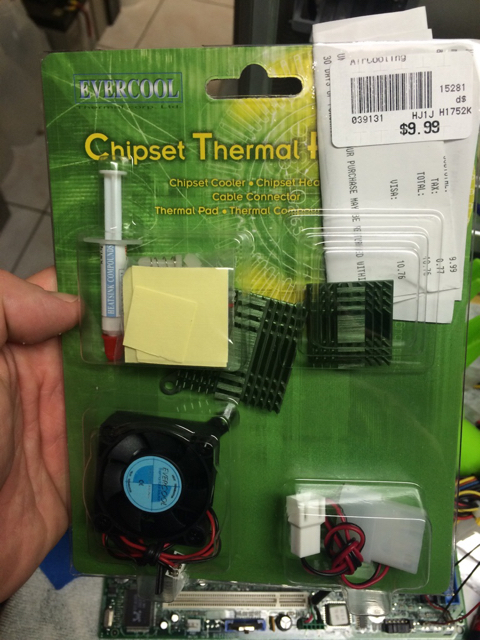

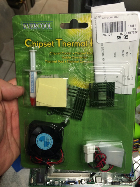

I ended up using NB mounts from an old PC board I had. Running well for a week.
I did recently buy a set of NB heat sink fan and standoffs from Micro Center as a backup.
