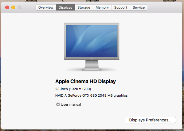

I'm viewing on an old Apple 23" Cinema Display using the (i think) DVI output and a USB2 cable. Old screen but funds tight and it stills keeps chugging along. Could this connection be my bottleneck ? 🙂

Interestingly enough TheIguana ... you were thinking along the right track ... My Nvidia GTX 680 Mac card wasn't causing the black 360 5.7k Garmin film clips in FCPX. I have just updated my OS from Sierra 10.12 to High Sierra 10.13 and the clips now show - even on my old 2013 MacBook Pro. I may be able to hold off a few months until i decide to buy the preflashed Nvidia GTX 1070 ... I'll also see how this is supported in Mojave when that OS is released. With any luck the new card will have come down in price too. 🙂

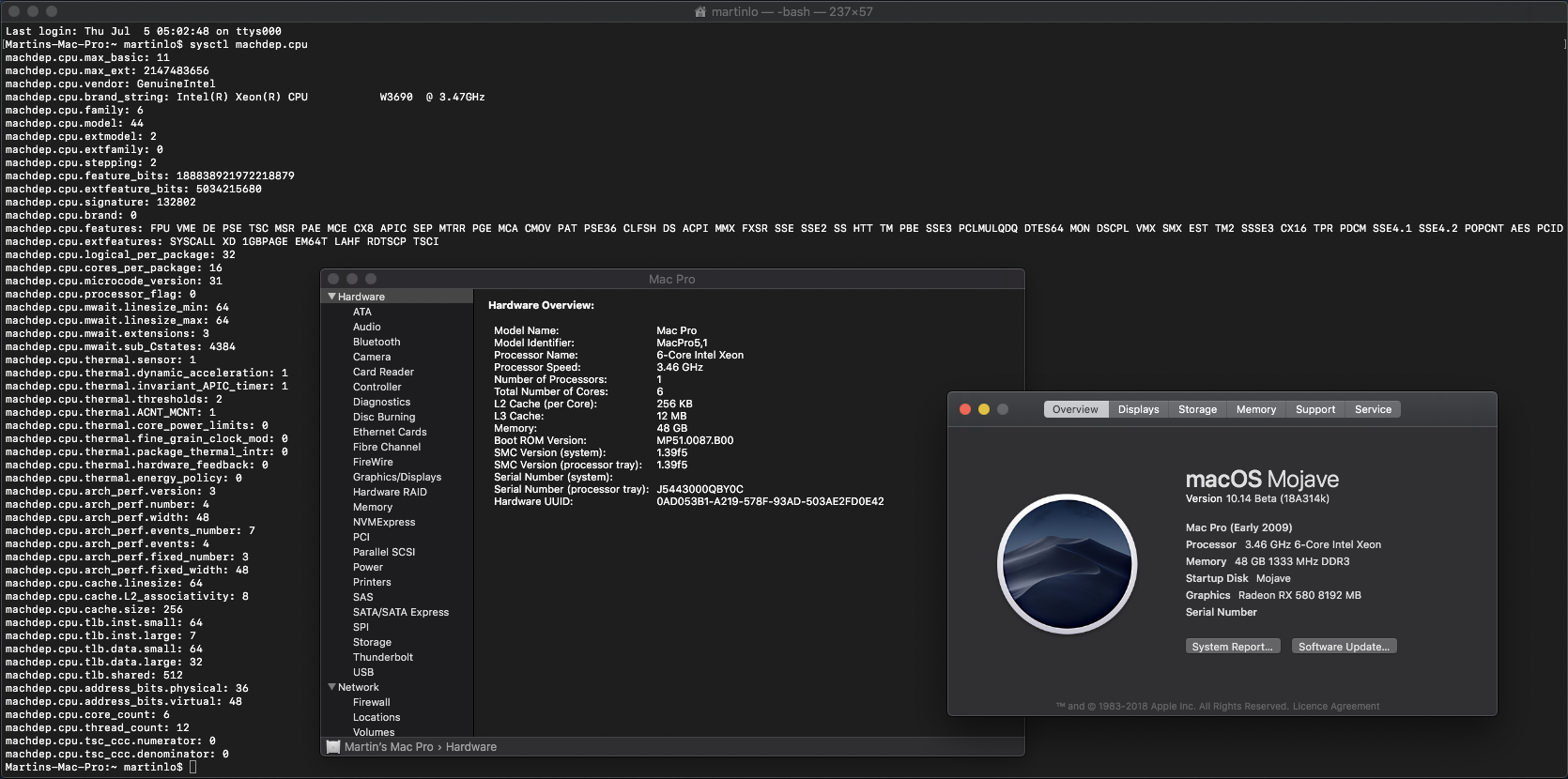

My understanding is Mojave will not work with your model, I am in the same boat, a flashed 2009 will get not supported in the Mojave beta, Even though it reports 5.1 it still shows Pro 2009 and Mojave only supports 2010 and newer. I wish I had bought a 2010 and upgraded that as it appears High Sierra is end of line for this model.
I really don’t understand why anyone would buy a flashed 1070 at this stage.
An utter waste of money and effort.
The RX 580 (with a GT120 or GTX 680 for firmware flashes) is the perfect card for the cMP IMO.
Why have the hassle of dealing with Nvidia drivers. Who knows if they’ll even support Mojave?
Not only that, the new GTX 1170 is probably weeks away at this stage, so prices would drop then anyway.
Apple have now come out and said that the RX 580 is a supported card. Why deviate from that?
You're wrong. Mojave works fine on a 2009 that was flashed to the 5,1 firmware.
10.14 is definitely working on Mac Pro 2009 with proper 5,1 firmware and GPU.

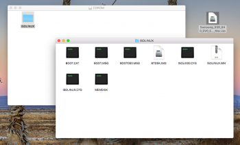

You star ! 🙂 Fabulous ... But it's an .iso file (Samsung_SSD_840_EVO_EXT0DB6Q_Mac.iso) ... what do i do with the contents ?!
First, make a backup of your files. Then burn a CD, right click on the ISO file and select Burn. Next you boot from the CD to upgrade the firmware.
Reactions: Squuiid
Insert the CD, reboot the Mac while holding down OPTION key. Then choose CD boot and follow the instructions.
As @tsialex mentioned, do make sure you have a backup of your data/disk before the update.
While in some cases I may say you could get away without doing the firmware upgrade, in the case of the 840 EVO it is very much crucial that you do the update, unless you're happy with 'far slower than a spinning hard disk' speeds.
Test your disk speeds before and after the update using AJA System Test:
https://itunes.apple.com/gb/app/aja-system-test-lite/id1092006274?mt=12
Use the FreeDOS way to update the firmware. Be careful that can take hours (the bug was about the old data will suffer from very slow read, therefore, during this firmware update fix, all data will be re-written once under the "fixed" environment, which can takes a long time).
Also, make sure the SSD is connected to one of the native SATA port, not on any PCIe card.
