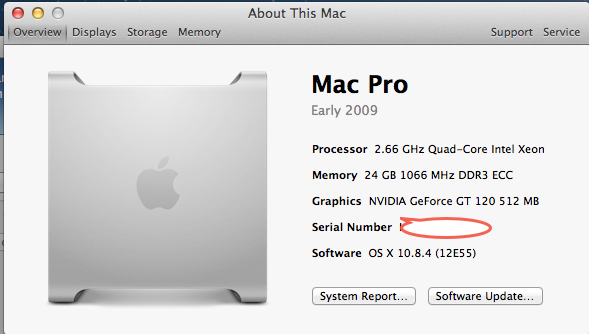

Upgraded the ram tonight. Currently cloning the big 1TB drive. :| 1 hour and 52 minutes thus far....
