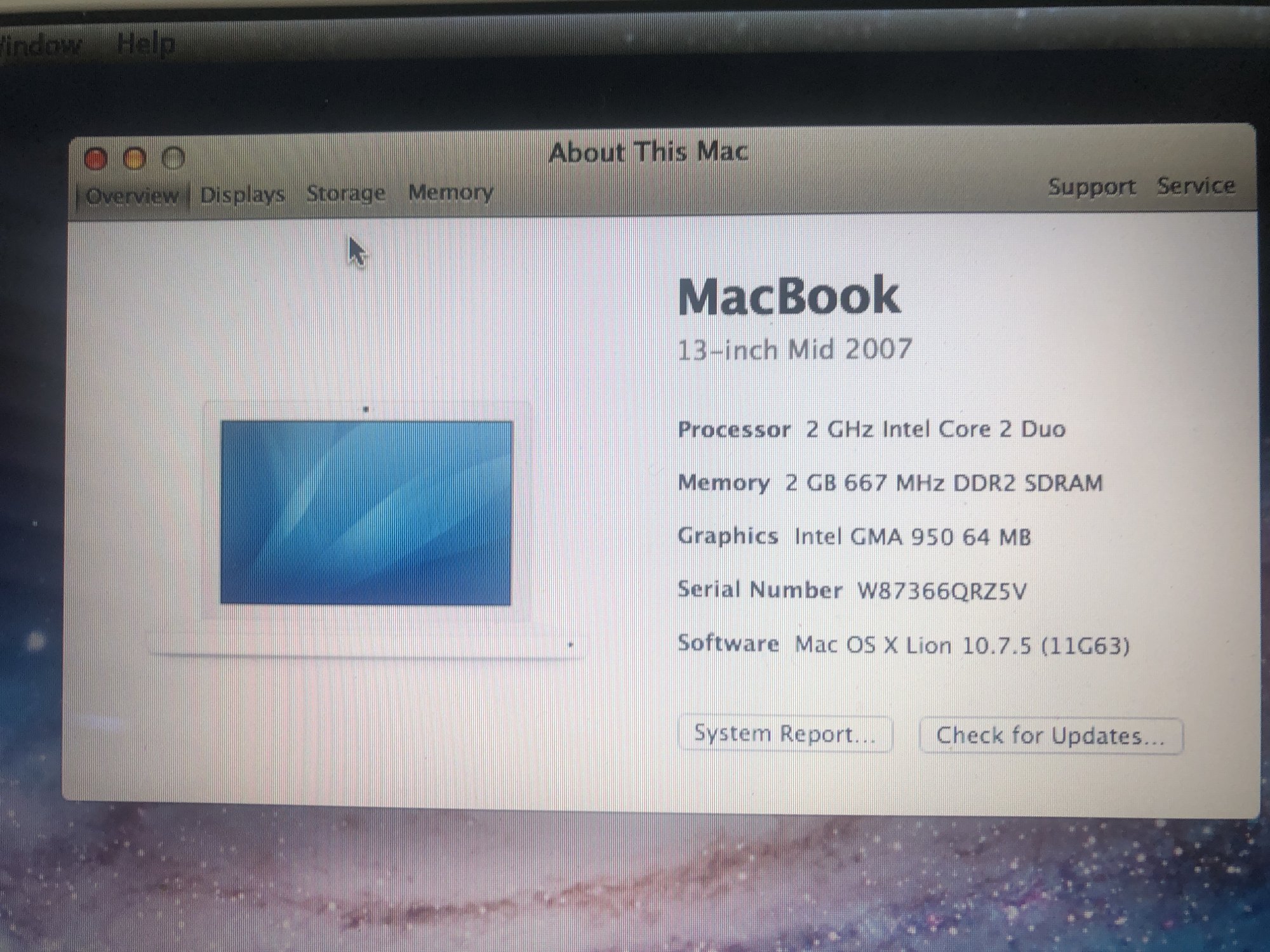

Can you fire up "About This Mac" and tell us everything it says there (apart from the serial number)? I'm asking because as the MacBook is running 10.7.5, it might be an earlier model than a 2009 and have 32-bit EFI, which would prevent both 64-bit Linux and Yosemite from booting unless the installers are modified.

Yes, I'm beginning to suspect that this might not actually be a 2009 MacBook -- it's entirely possible that the seller sold you a 2006/7 MacBook (GMA 950 graphics). If it has Nvidia GeForce 9400m graphics, it's definitely a 2009 MacBook.
OK you hit it correctly it is a 2007 not a 2009 Is there a way to get it to run Linux or a different version possibly?
We need to know if it's a mid-2007 (MacBook2,1) or late-2007 (MacBook3,1) model. Does it have GMA 950 graphics or GMA X3100? Check "About This Mac" again. The earlier model (GMA 950) has 32-bit EFI and requires modifying the Linux installer. The later model (GMA X3100) has 64-bit EFI and does/should™ not require a modified installer.
Neither of the two will run Yosemite properly due to a lack of graphics acceleration for the GMA 950/X3100, which causes the UI to be very slow and glitchy. You can look into getting either a patched Mountain Lion (10.8) or Mavericks (10.9) up and running though.

GMA Intel 950 64MB
GMA Intel 950 64MB
That’s the “mid-2007” (actually: “late 2006” with slightly faster CPUs) model.
You can download modified Linux installers that will work with its 32-bit EFI here.
For a patched OS X Mountain Lion, check this out.
I was wrong about Mavericks being an option with the ‘950 (sorry). Mountain Lion is as good as it gets.

That’s the “early 2007” (actually: late 2006 with slightly faster CPUs) model.
I was wrong about Mavericks being an option with the ‘950. Mountain Lion is as good as it gets.
Thank you for all the help now to dig in and get linux working on it with info provided!!
