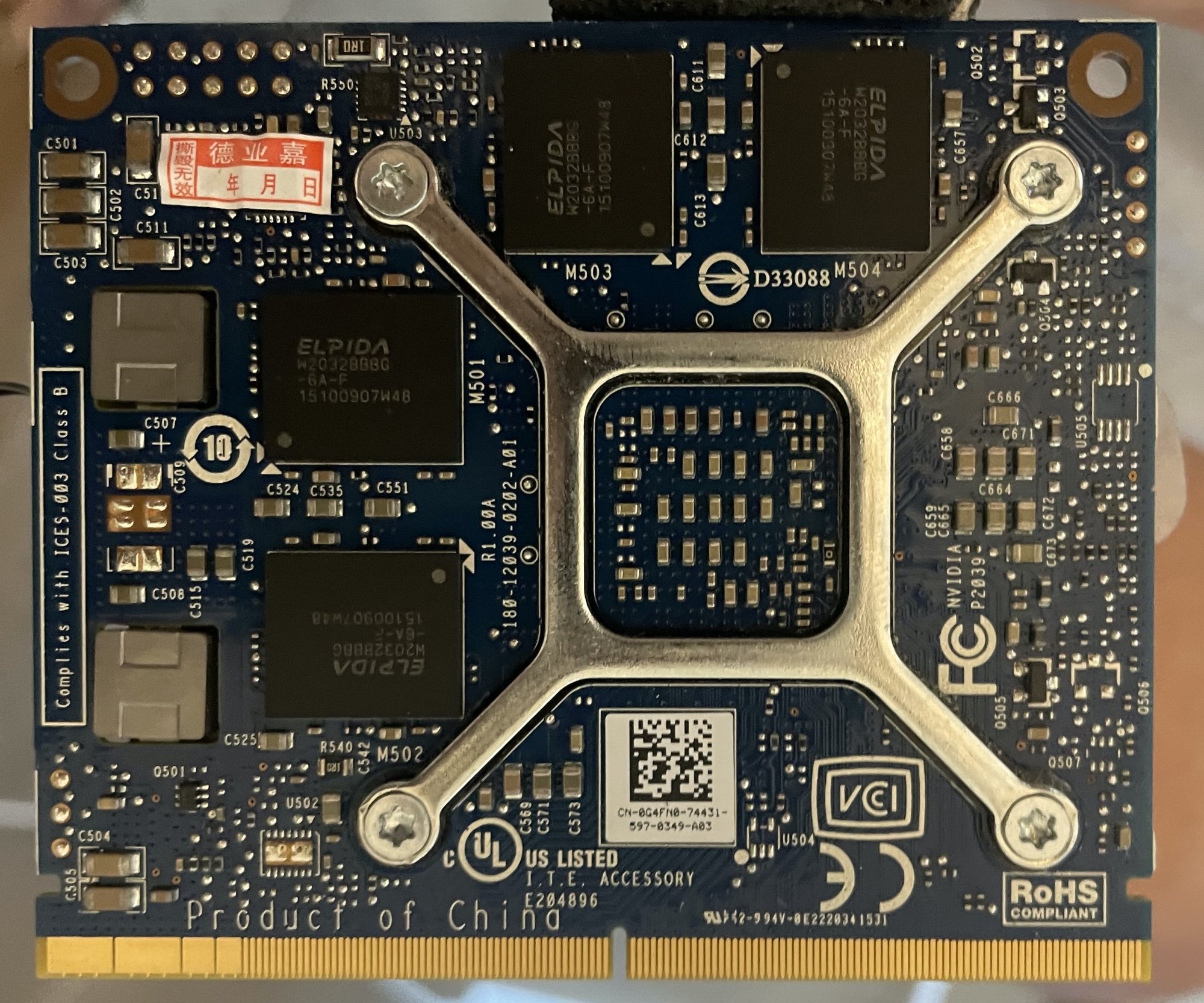

Hello,
i have a iMac 11,2 (2010, 21.5). Earlier i have swapped my CPU to a 860s and was happy running High Sierra. But since Software support is getting bad, i thought about upgrading the GPU to a k2100m. I shoot one for about 50$ from china with the Elpida memory.
Now i have planted it into my system and i get only the first 3 LED shining up. I have flashed the GPU with the vBios of @nickey22 with the @xanderon usb stick method. The LCD screen stays dark after i boot up the system. On an external monitor i get an image. I have actually updated the OS to Big Sur already with OpenCore hoping this might change anything. I have done PRAM reset and holding the alt/option key.
To find the issue i have put in back the original AMD card. The LCD worked again. Now i wonder where i issue could be.
I would like to put the K2100m back in.
