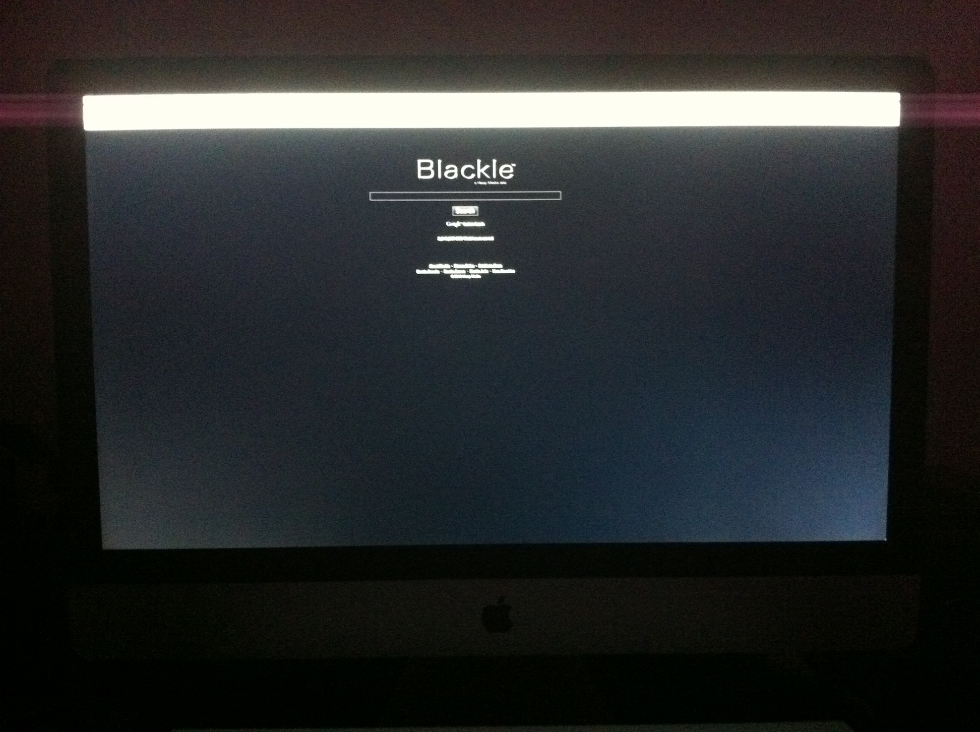

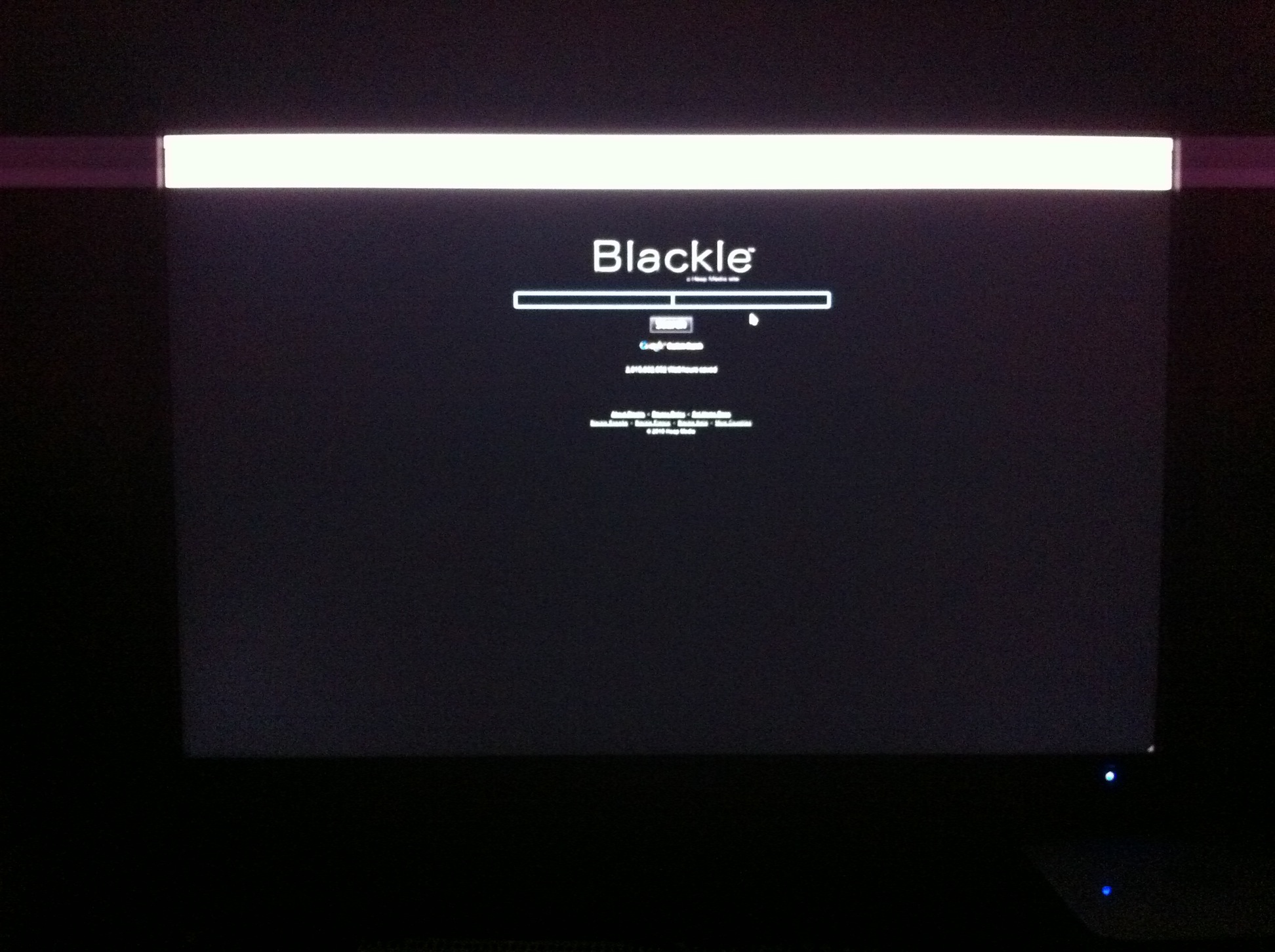

I just received my replacement i7 iMac. Originally returned due to backlight bleed in bottom corners and 1 dead pixel. Low and behold replacement backlight bleed/glow is identical to the first one.
See attachment pictures...
The second picture is for a comparison - what a screen with no backlight should look like- my 'old' Samsung 275t 27" that this iMac is replacing.
Anyway have been contemplating returning iMac again for cash back. BUT have decided to keep it for the following reasons:
  • it's so very fast!
  • no dead pixels on this one
  • this screen is actually pretty amazing. On anything but an all black picture, it looks fantastic. Its nice and bright and the resolution is awesome. The poor backlight in corners is a minor trade off if you step back and think about the machine as a whole.
Apple support have been very good to me, and appreciated the replacement to put my mind at ease (in a way). Sorry to people that I supported with backlight issues on this forum- looks like I sold out to Apple in the end! :apple:

My late 2009 version iMac is very similar in it's backlight bleed. In actual fact, due to other various issues, namely yellow screen, it took Apple four replacement iMacs before I settled on an "acceptable" machine. At this point I'd kind of given up the will and decided the backlight bleed was something I could accept as in "real world" use It was negligible compared to the yellow screen issue. I figure that if it bugs me I'll just get the screen swapped out, under Applecare, in a couple years time when the IPS screen technology manufacturing tolerances may have improved.
This is not backlight "bleed" or "glow", and has little to do with the actual backlight.
What you see is a property of all IPS displays without an Advanced True Wide (A-TW) polarizer.
It's essentially a viewing angle issue. I've spoken at length about this before (not necessarily sure if it was here), and the iMacs lack such a polarizer, as do nearly all non-high-end screens.
Firstly, the camera sensor in your photo is not parallel with the screen; it is looking down on it. That's the first clue this is what you are capturing. Secondly the "bleed" occurs only in the bottom corners, and this corroborates the first point, because the bottom corners' pixels' surface normals are further from being perpendicular to the plane of the camera sensor. Thirdly, your previous screen is S-PVA, and those screens do not exhibit this "glow" at certain viewing angles, and also have deeper black levels anyway, but of course have other problems that still make H-IPS screens superior in many regards.
To confirm this you can take an image of the screen "looking up" and the backlight bleed should suddenly be in the top corners. Also take another image of the screen from much further away, making sure the screen is parallel with the sensor of your camera.
Also, just by viewing the screen (with black wallpaper) at many different angles you will notice the glow moving, and it appears to give the screen depth. I liken it to a glow-y virtual reality room (with no simulation loaded 😛).
So, if I'm right about all these points there is no point in worrying about whether you should have kept this or replaced it, because it's inherent to the H-IPS technology and will never change.

hey thanks for the detailed info jonwd7. Should have spoken to you earlier before I went thru a replacement!
Your IPS tech explanation is helping me to be more comfortable with my decision to stick with iMac. Yea the glow does move at different angles.. so what you talk about there agrees with me. Hope this helps other too
What you see is a property of all IPS displays without an Advanced True Wide (A-TW) polarizer.....
I can see where you're coming from but some of these iMac IPS screens are significantly less effected than others. Across the four supplied iMacs I had I was always able to compare one iMac screen against the other (they allowed me to keep each "current" iMac and only return it once I had received the replacement). I've also had my iMac and my father-in-laws exact same spec model side-by-side and the difference between them, with regards to the "backlight bleed", is very noticeable.
What you say makes sense, and I want to believe you. However, explain this (from my week 6 machine returned back in Feb/March. This was one of the 5 machines I went through before getting a refund.
