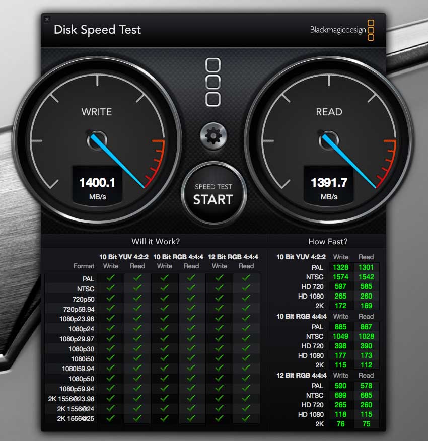

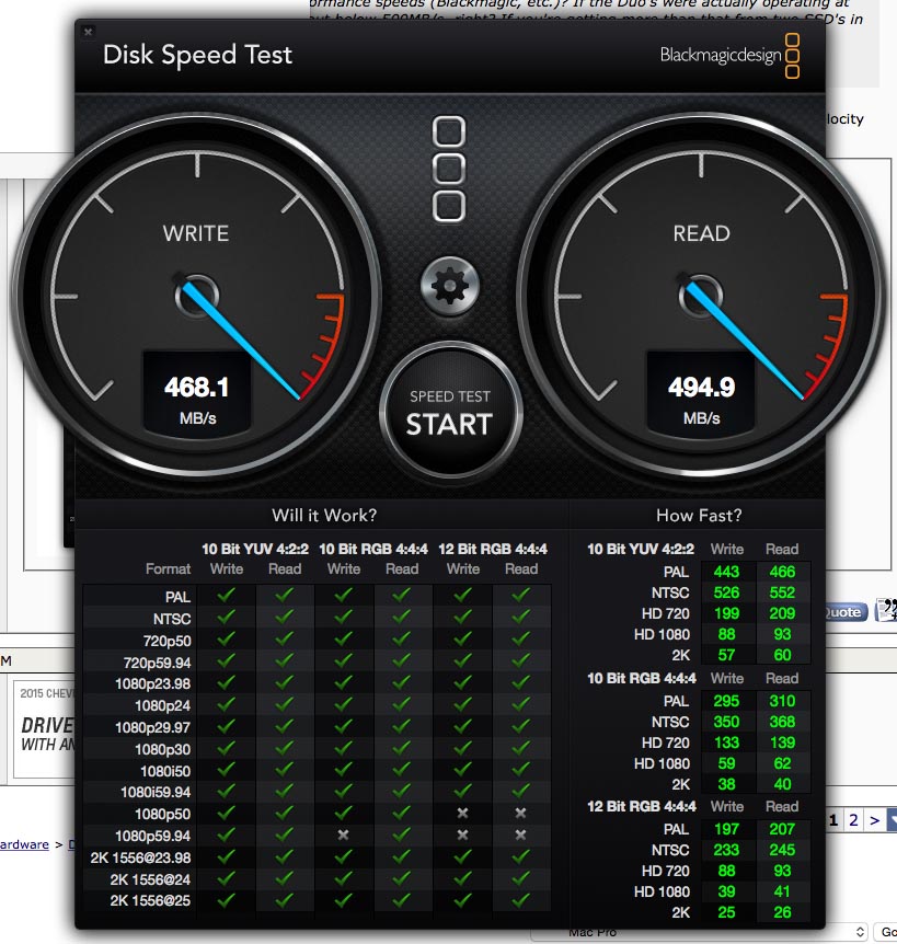

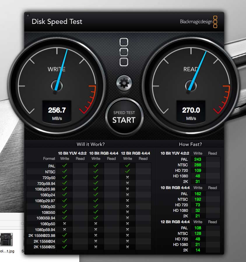

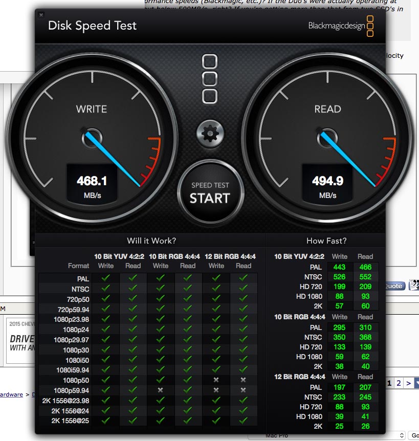

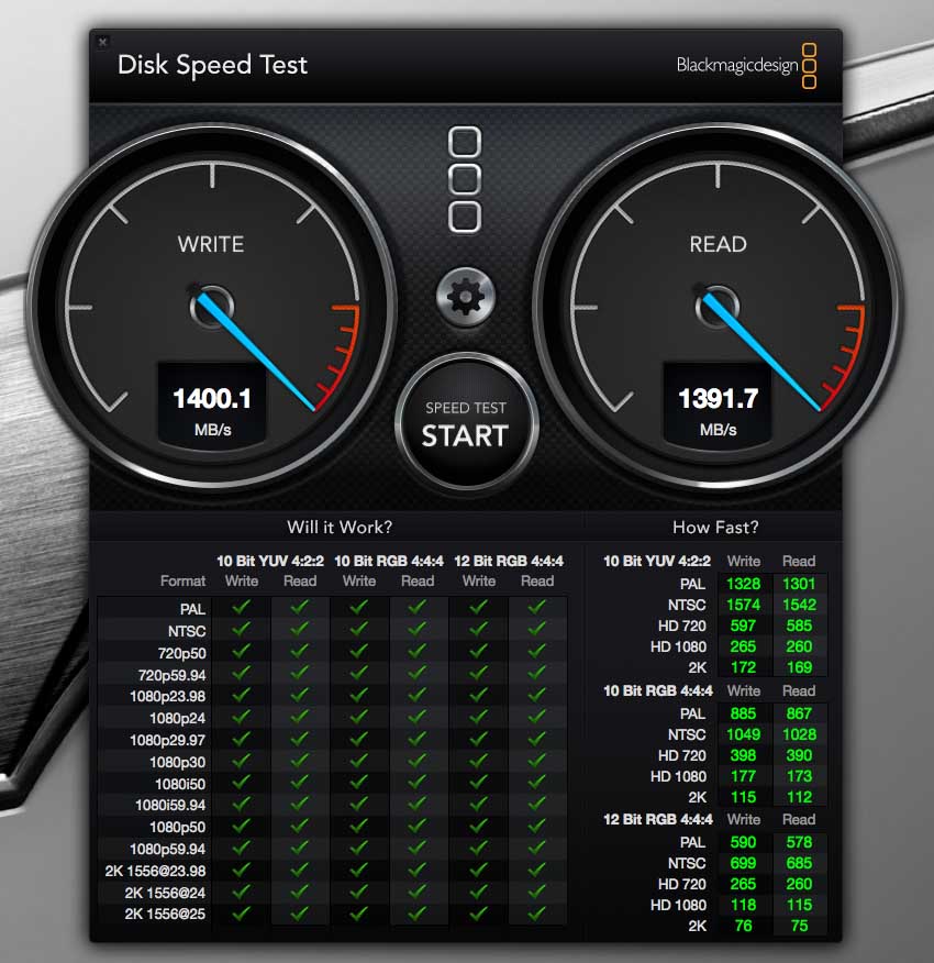

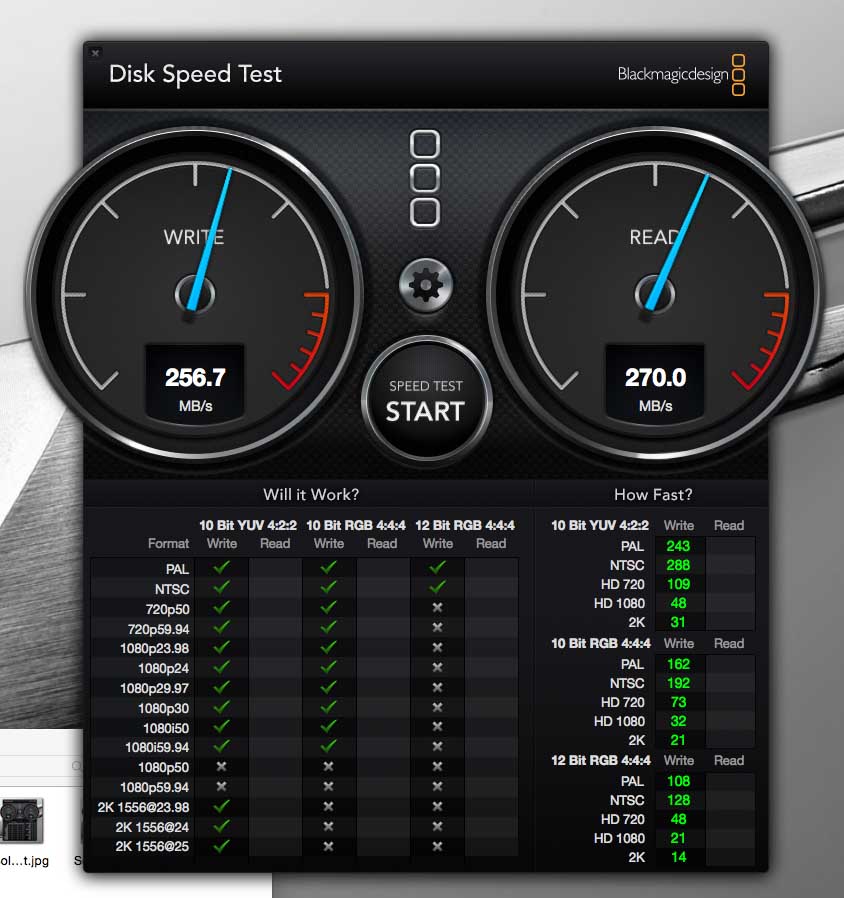

The fastest SSD speed is achieved with with an Samsung SM951 blade and a Lycom PCIe adapter. See this thread:
https://forums.macrumors.com/thread...the-09-macpro-bootable-ngff-pcie-ssd.1685821/
and my post on Page 51 here:
For comparison.
1. Samsung 840 Evo in SATA Drive Bay.
2. Samsung 840 Pro on Apricorn Duo x2 PCIe Card
3. Samsung SM951 on Lycom PCIe adapter
My Machine - 5,1 Mac Pro.
The above shows SSD speeds in the HDD Bay, an Apricorn Velocity x2 Card, and an SM951.
Lou
Lou
