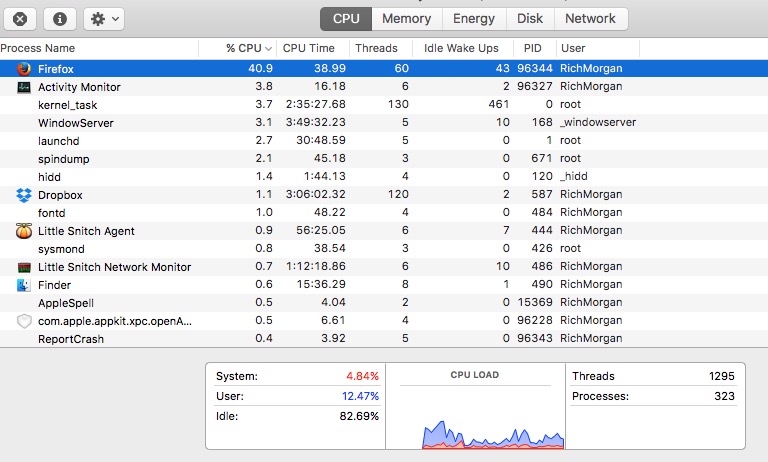

Check Activity Monitor (in Utilities) to see if anything obvious jumps out that is using up lots of CPU or memory.

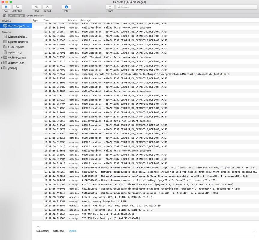

This happened to a Mac I was using. Turns out the hard drive was going bad. On the "Console" app, check to see if you've been getting disk errors.
Where do I look in the Console app?
This is what I see...

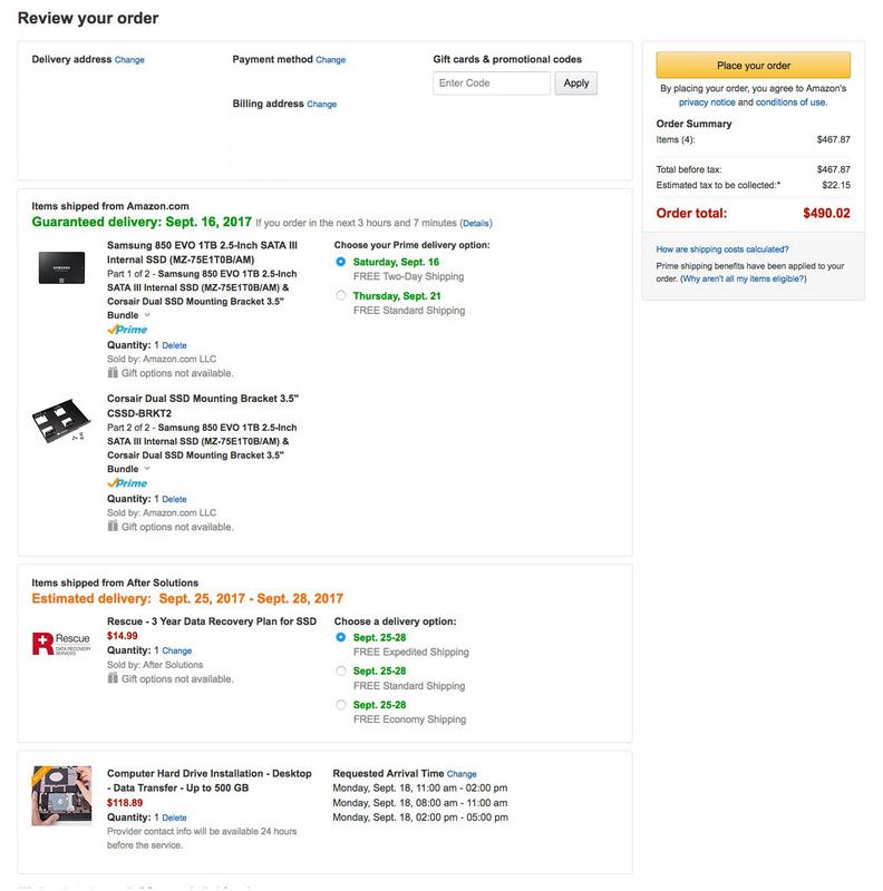

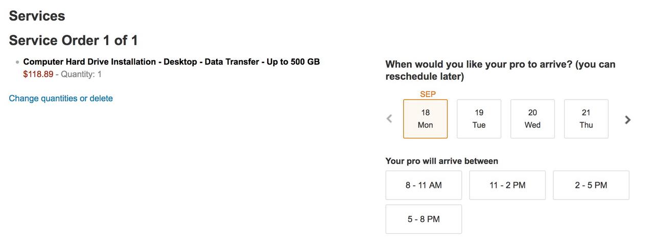

I notice that if I buy an SSD from Amazon they also offer to send somebody to install it for $118 extra. Do you think this is a good deal rather than buying the kit and dealing with the hassle of installing myself?
[doublepost=1505434567][/doublepost]So here's the total – almost $500. Is it worth spending that much on a 2010 iMac? I can't really afford to buy a new one at the moment but I use the iMac to store all my music and important files. I have a 15" 2017 MBP but it only has a 256GB hard drive – not enough for all my files.
Stick with using authorized Apple repair service. Amazon's person may not Apple authorized and that could pose big problems, should he or she damage your iMac attempting to do something that is above their pay grade.

Does the slowness persist over a reboot? you have some significant uptimes in your screenshots.
Before opening up the machine to replace disks, I think you should install SMART Utility or some equivalent to see what it has to say about the disk drive. The errors you show in console have to do with some sort of obsolete junk in keychain utiity, and I'd be surprised if it had anything to do with the slowdown. I don't see any obvious disk errors in the snippet you posted.

Yes, the slowness does persist after a reboot. Here is more of the Console report if you wouldn't mind taking a look:
https://www.dropbox.com/s/pfufptqk4axlc4d/ConsoleInfo.txt
(I'm no expert so it means very little to me)

I don't see any obvious disk drive errors, so if the drive is the cause, it's not telling the kernel about it. You have a lot going on but the only large bursts are those
CSSM Exception: -2147413737 CSSMERR_DL_DATASTORE_DOESNOT_EXIST
messages and they seem to come from various programs. There's a hint that it might have something to do with Microsoft certificates (or missing ones) in the keychain, but you'd have to google to see if you can figure out how to make the issue go away. I'm not sure that there is enough of it to explain constant ongoing slowness.
