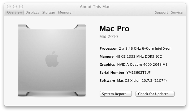

Yep. I did something similar. I upgraded my 2x2.4GHz 5,1 to 48GB of RAM first, and then upgraded the processors to 2x3.46GHz. The RAM I purchased was 1333MHz, but showed up as 1066MHz with the original Intel chips. As soon as the machine booted with the new chips, the memory showed up faster. See the before and after attachments.
