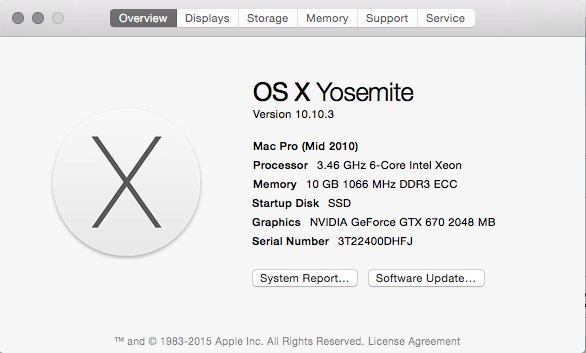

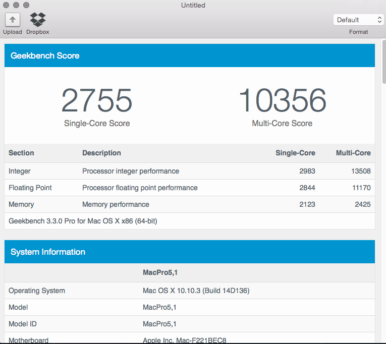

Heya guys,
Just recently upgraded to a W3690 250GB SSD and a GTX 670, But my geek bench score is coming in at around 10k. I have seen upwards of 15k.
Any reasons why? or how I can rectify this?

I have about the same single-core results but about 1.5x better on every multi-core subtest. Are you sure nothing's eating CPU in the background during the test ?
Your single core score is good, but your multicore score should have around 16000.

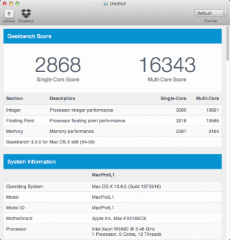

These scores aren't good neither. Even with 32 Bit Geekbench.
My scores below. Geekbench 64 Bit.

So i thing about ram because is show 1066, but actually is 1333 they are x4- 8GB + x4 2GB.
any solution ?

Hopefully you've figured it out in the last month, but if not, reset the PRAM (from MacWorld.com):
"Reset PRAM: Shut down your Mac, press the power button, and as soon as you hear the startup chime, hold down Command-Option-P-R. Keep holding down those keys until you hear a second startup chime"
I basically built the same machine you did and had the same RAM 1066 issue. After the PRAM reset and reboot, the RAM clock showed 1333. Geekbench scores should reflect a significant jump. My version of your machine gets me in the 24,000's on GB4.
