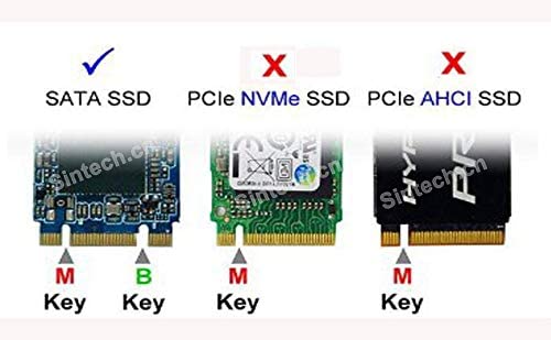

I found this adapter on eBay which appears to be identical to the Sintech model that was recommended in the video but I'm confused about SSD compatibility. From the description in the listing:
The adapter supports only SATA transfer mode SDD(KEY B), it can not support PCI-E 2X transfer mode SSD(Socket 2 B+M key) and PCI-E 4X transfer mode SSD( socket3 B+M key)

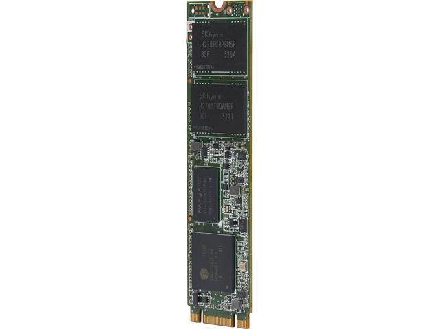

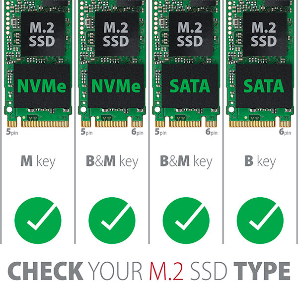

This means that I'll require an SSD with the KEY B interface, as shown below?
Only problem is, I haven't been able to find any M.2 SATA SSDs with the KEY B interface! The B&M SATA drives on the other hand are plentiful. What confuses me even further is that Sintech state that their adapter, which appears to have same connector as the cheaper one on eBay, will work with SSDs that have the B&M notches, so would I need to opt for their version instead?
If you can clue me up on all this, I'd really appreciate it. 🙂

You will be just fine with any SATA-based M.2 SSD.
The important part is that the drive is SATA-based, which means it has a “B” keyslot. Many M.2 SATA SSDs have both slots so that they can fit into “M”-keyed sockets on PC motherboards, which will accept either PCIe-based (NVMe) or SATA-based drives.
Got it. Thanks for putting my mind at ease. 🙂 So the listing is erroneous when it claims that only "B" key SATA SSDs will work? That's so annoying.

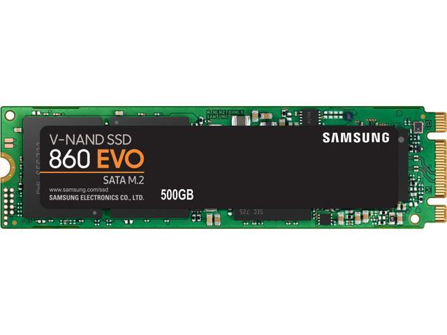

You could just buy a SSD that fits without an adapter like this item from OWC.
I could but an ordinary M.2 SATA SSD is considerably cheaper and I'm angling to try and save a bit of money: which would be negated if I shopped at OWC. 😉

I think the listing can be interpreted as saying that only SATA SSDs will work and PCIe 2x and 4x ones will not.
The parenthetical slot information is indeed extra and is certainly confusing, but a B+M keyed SSD definitely fits in a “B”-keyed receptacle.
Didn't realize that M2.SATA disks are still expensive.... Get the Samsung, then.

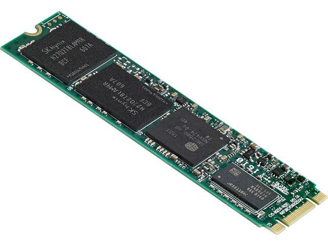

Update time: I bought this 256 GB B&M for £30 GBP.
Exactly as @Needleroozer had advised, it fit without any issue into my adapter...
...which in turn then fit without any issue into the MBA.
With the bottom plate reassembled, I powered up the laptop and it wasn't long before Snow Leopard was restored.
Everything seems to be ok and hopefully my experiences will be informative and useful to others who want to upgrade or replace the SSD in their MBA. You do not need to purchase the Sintech adapter because as I've shown here, a cheapo variant from eBay works identically and this in turns means you're not locked into paying premium prices for an Apple unit or an OWC drive. All I need to do now is decide how much drive space will be allocated to El Capitan/High Sierra and Linux Mint. 🙂
