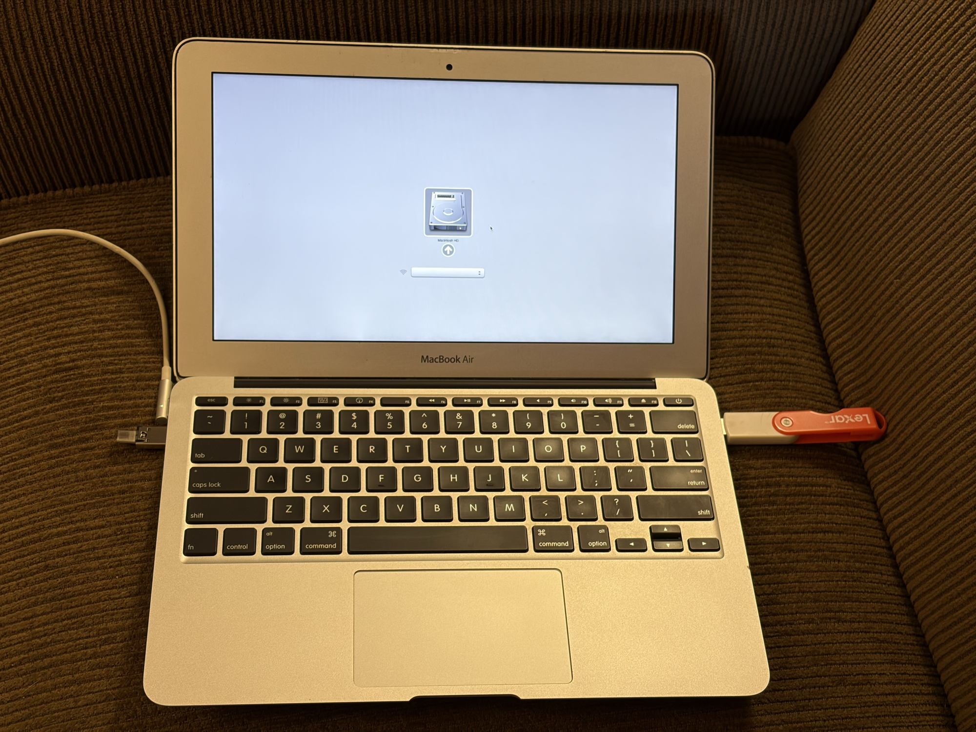

I just got a MacBook Air 11" 2010. May be one of my more unlucky untested eBay purchases.
I have reset the PRAM.
Pressing Command R for restore mode will not work, as it will try to boot up straight to a login screen.
Internet Recovery will not work either.
I have tried using a 32GB SanDisk Ultra USB 3.0 dual USB-A/USB-C as well as a 64GB Lexar USB 2.0 flash drive with a copy of Mountain Lion to boot from and neither will show up after holding down option while starting up.
Plus, it is finicky when trying to turn it on.

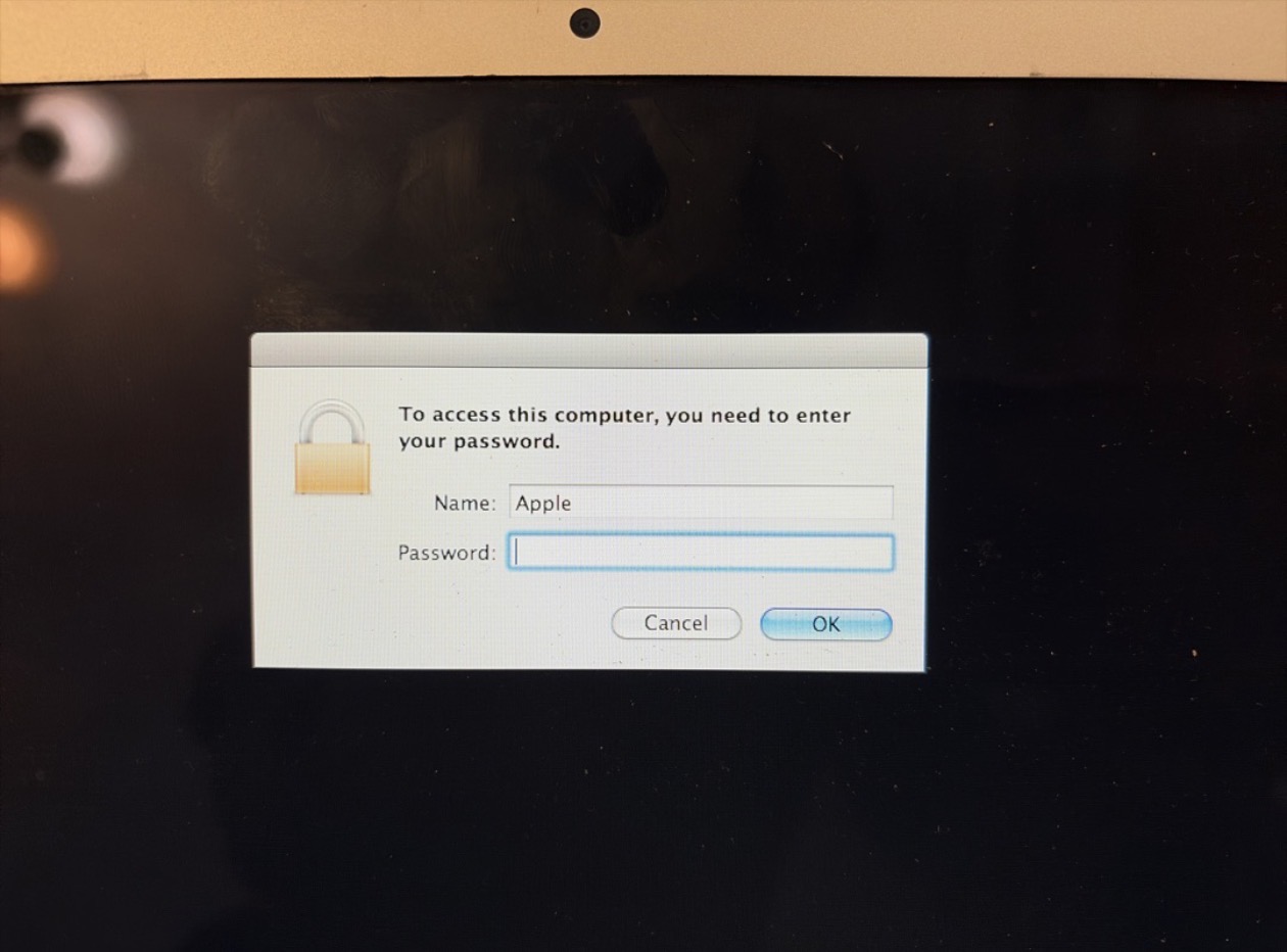

Also, the login screen is a black screen with this dialog, which I haven't seen before.
Have only seen the normal Snow Leopard startup screen once when booting up this thing.
There is no battery in this thing and I'm using a 65W L-shaped MagSafe charger.
Is the SSD failing? Is there anything I'm missing?

Is there any chance that the seller can provide the password?
What was the process that you used to create the installers and do those USB sticks boot on other Macs? It's worth eliminating the possibility of an issue with how they were created. I have to reiterate that you really do need to replace the battery if you want the MBA to work properly.

It will not even boot into internet recovery. I have held the key combo necessary and it goes straight to login screen.
It was able to connect to WiFi on the boot select screen, so I know that's not the problem.
I used Disk Utility to format the drives in Mac OS Extended Journaled but it would repeatedly fail to restore using Disk Utility, and I tried this on both my M1 Mac mini and my 2017 MBP. Converting the DMG to ISO wouldn't help.

I tried seeing if it would show up when pressing option when booting from my 2017 MBP. It would not, which makes sense because it is a Mountain Lion installer on a computer that originally ran High Sierra that now runs Monterrey. I do not have any other machine from the 2010-2012 era to test it on.
Strangely enough that same USB when I had before formatted it in APFS (as a bootable ChromeOS Flex drive) it showed up on the MacBook Air but froze when I tried to boot from it, understandably because of it being in APFS. But none of my Mountain Lion drives would even show up.
I asked the seller and he didn't know. I held Command S when booting to enter single use mode. Then I ran these commands:
fsck -fy
mount -uw /
passwd Apple (the name of the user account was Apple)
(Entered new password.)
exit (Proceeded to login screen, it asked me to create a new password keychain, which I did, typed in 12345, my new password, and it proceeded to desktop!)
