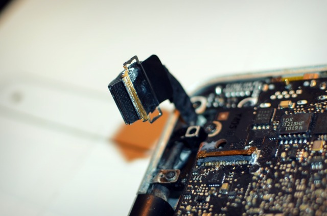

This is all the corrosion on the display plug, my guess is they didn't clean off any of the excess flux and it started to corrode the gold and aluminum in this thing. I cleaned most of it off now but I still can't get the screen working.

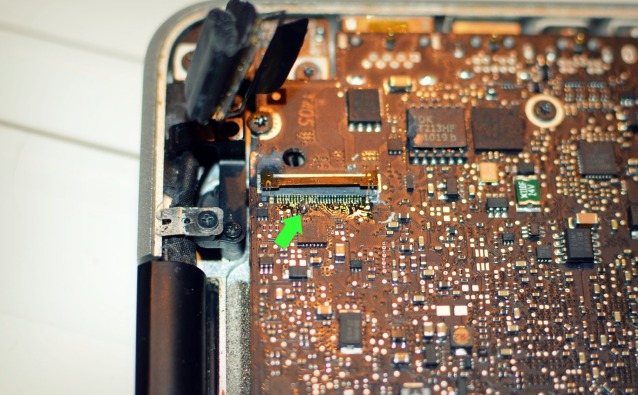

My guess is that it has something to do with this hack job soldering repair that clearly covers more then one pin on the display port, and probably shorted it out.. This is straight from the local and only Mac repair shop.. I am not pleased with their work at all.. Just look at the size of that blob by the green arrow!
