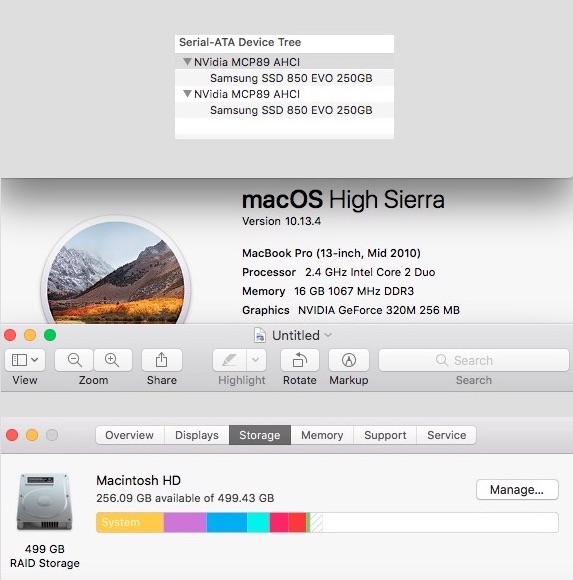

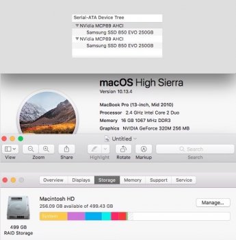

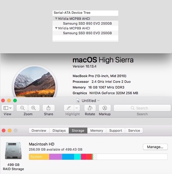

i have the same model, yes hard drive cable failed once on me, invest some SSD drive, it adds life and buttery smooth performance with latest MacOS High Sierra 10.13.4
