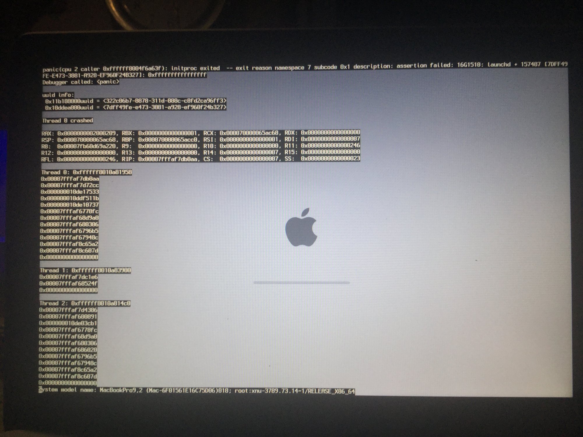

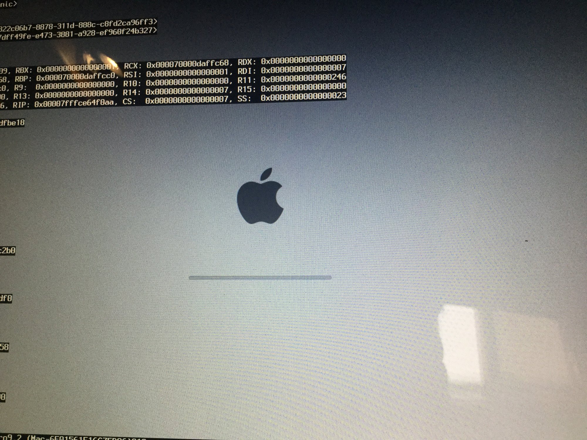

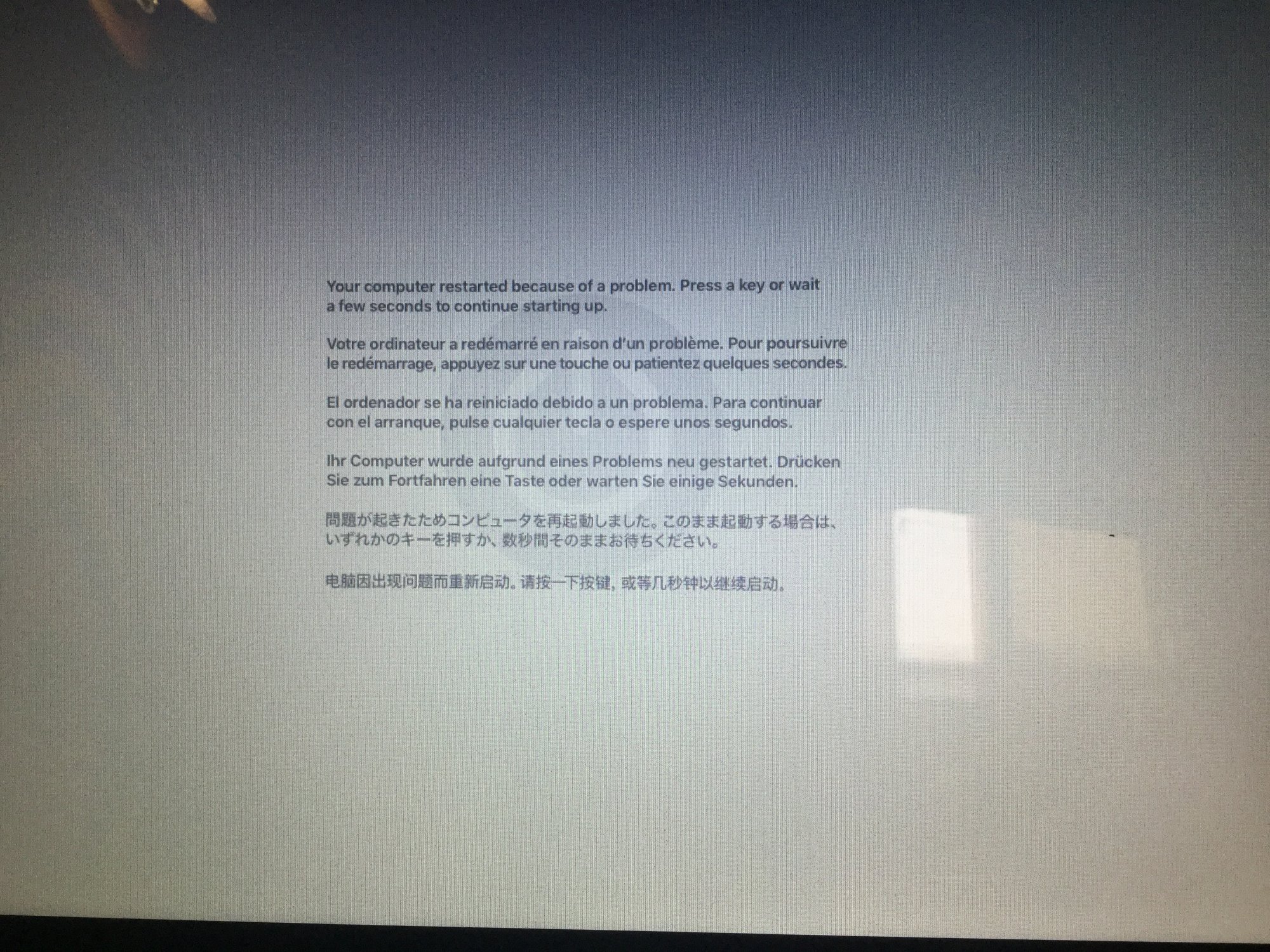

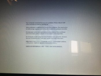

This started out of nowhere some time ago. I opened the MacBook one day and it just wouldn’t start, first showing the Apple logo with no progress on the startup bar, then switches to displaying white text highlighted black over that, then it says it’s restarting itself, rinse and repeat.
I’m sure someone’s seen this before, but I have not. Any ideas?

Looks like it’s kernel panicking.
Can you send a full image of the screen when it shows the DOS-like text?

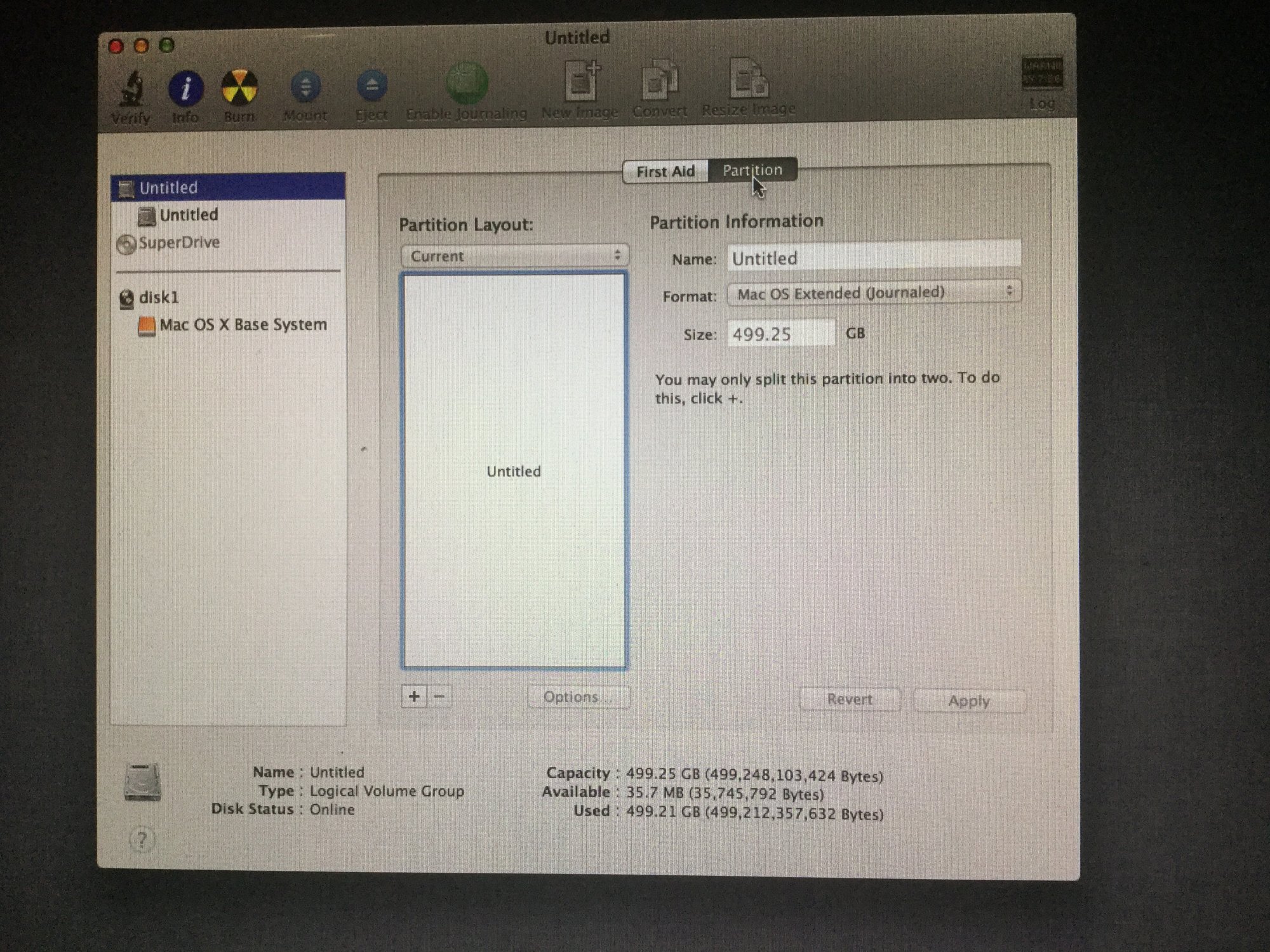

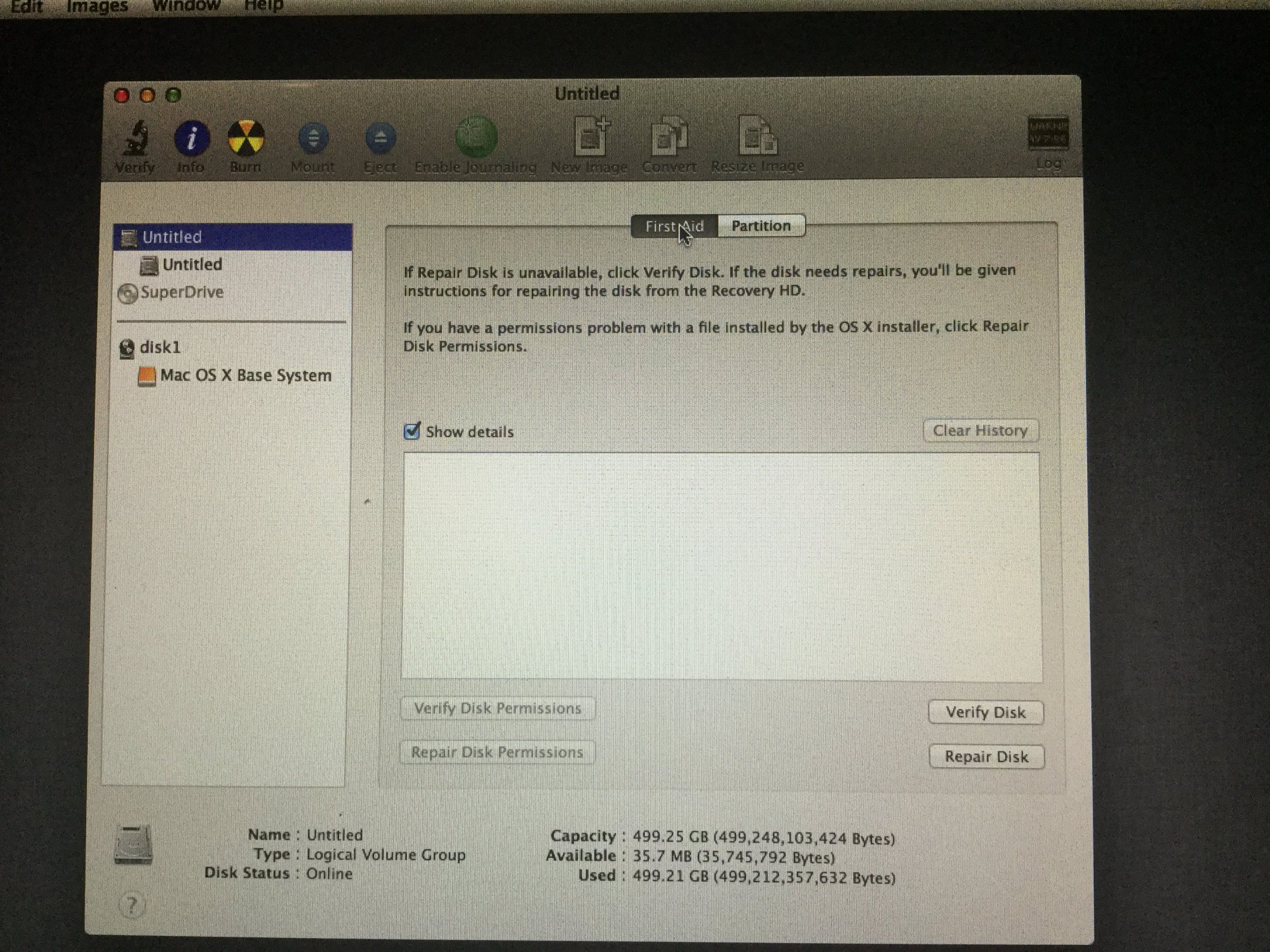

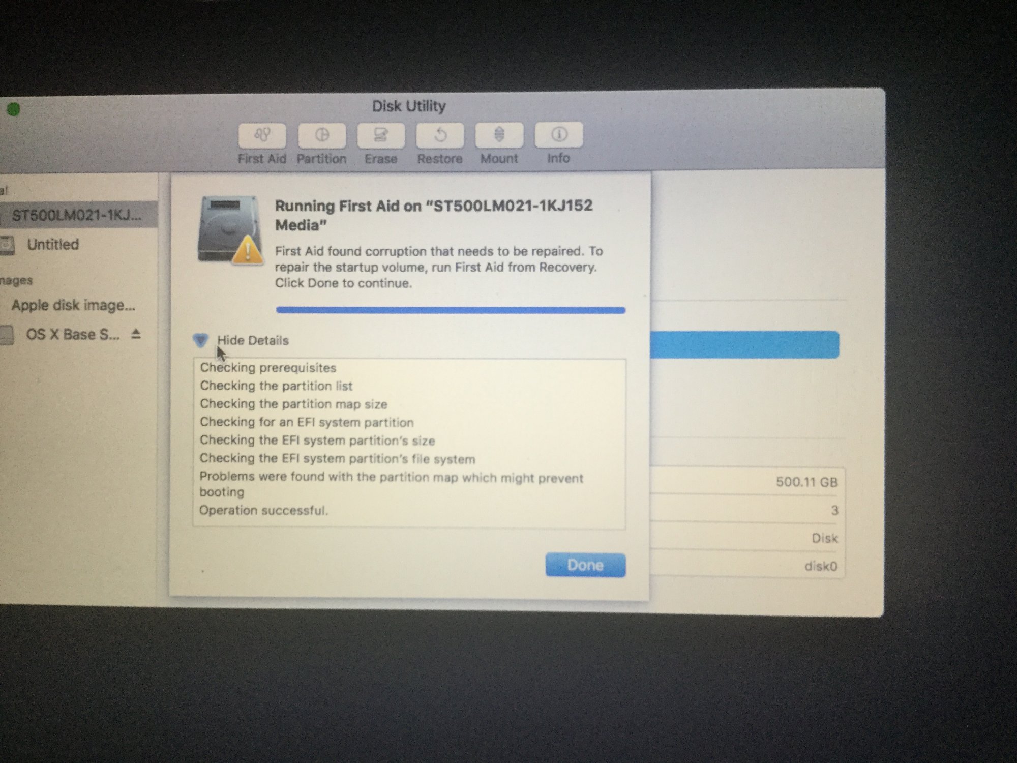

I’ve run First Aid and it says thes a problem with the partition map that’s preventing booting.

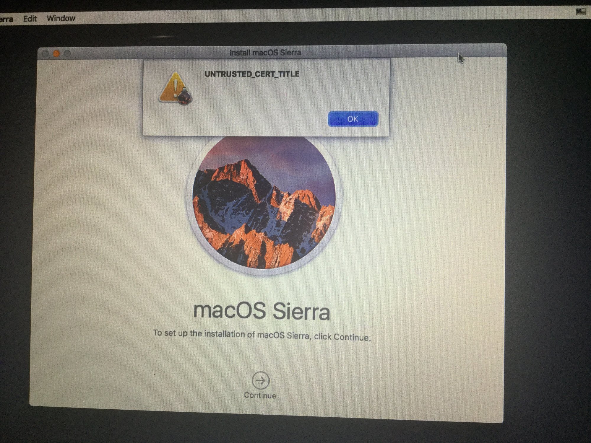

I’ve tried reinstalling Sierra but get an UNTRUSTED_CERT_FILE error. In researching this I’ve found this is due to an error in the date/time settings.
But I can’t boot into safe mode to change the time or to reinstall Sierra from the App Store..

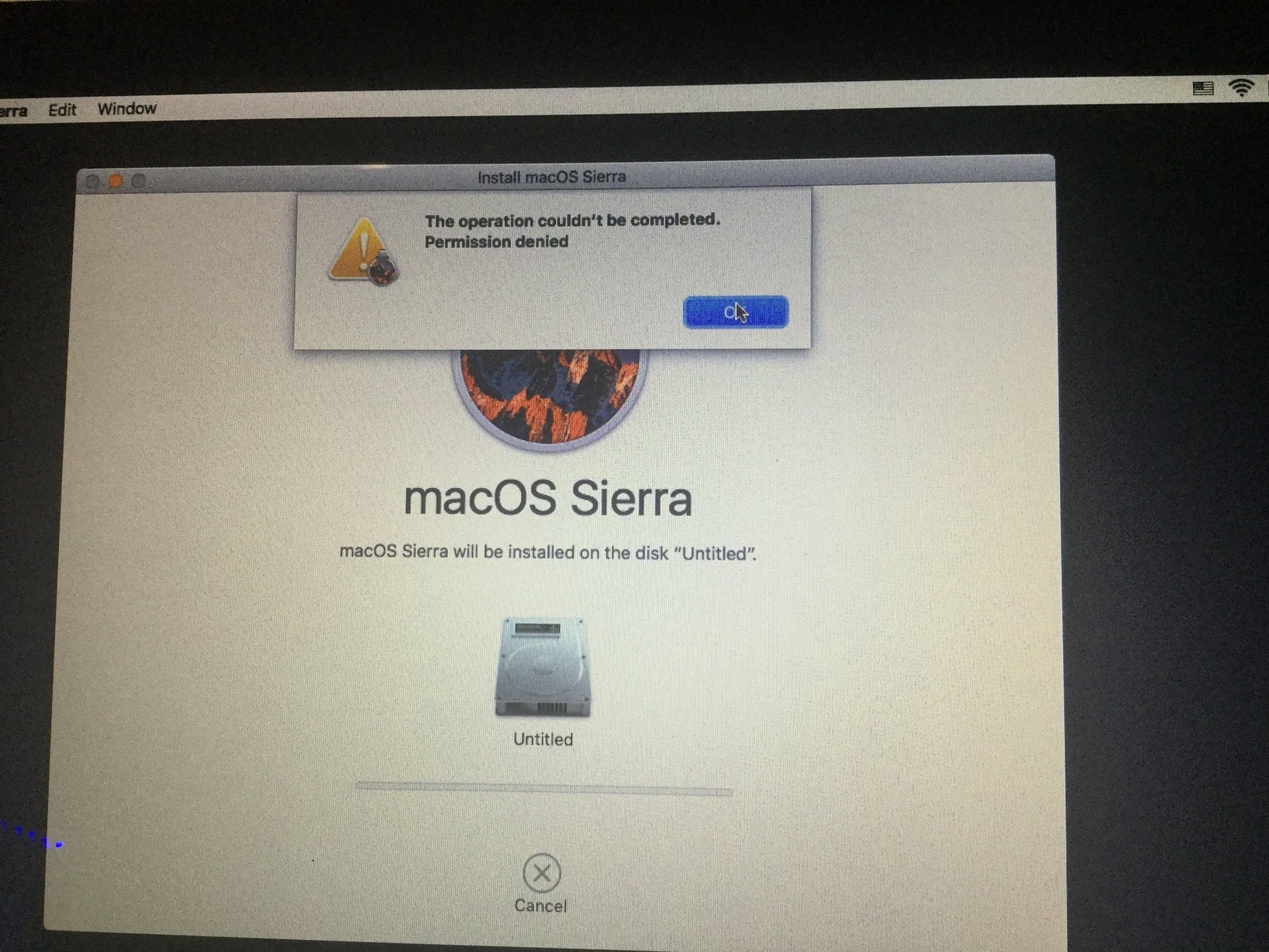

Got the date changed in terminal, and got past the CERT_TITLE error, but now getting a “permission denied” error

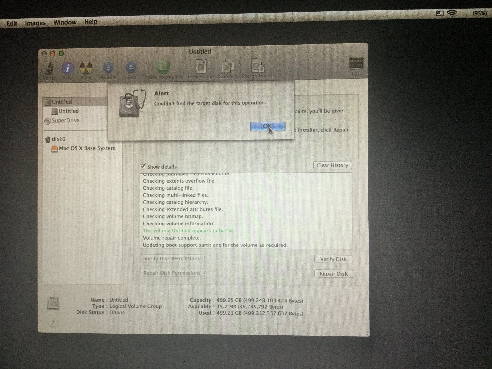

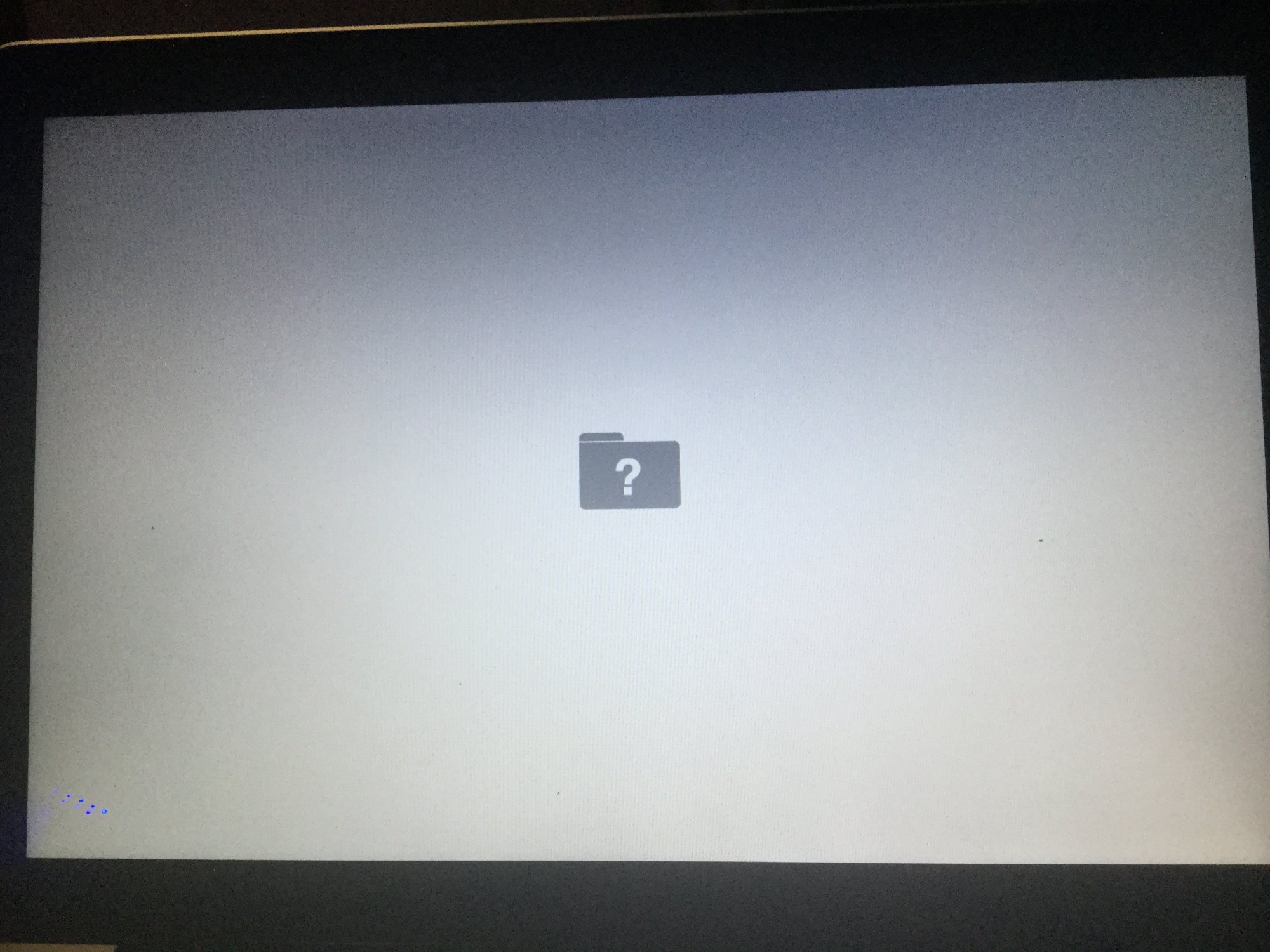

Got into internet recovery mode. Tried resetting the date through terminal there and repairing the disks, now getting new partition error messages and a “?” Folder at startup. Additionally, when I try to reinstall os in internet recovery, it defaults to Mountain Lion, which cannot reinstall over Sierra. Wondering if I’ll have to reinstall from an external drive..
As far as I can tell there is no option to erase when the first Untitled is selected, only first aid/repair and partition

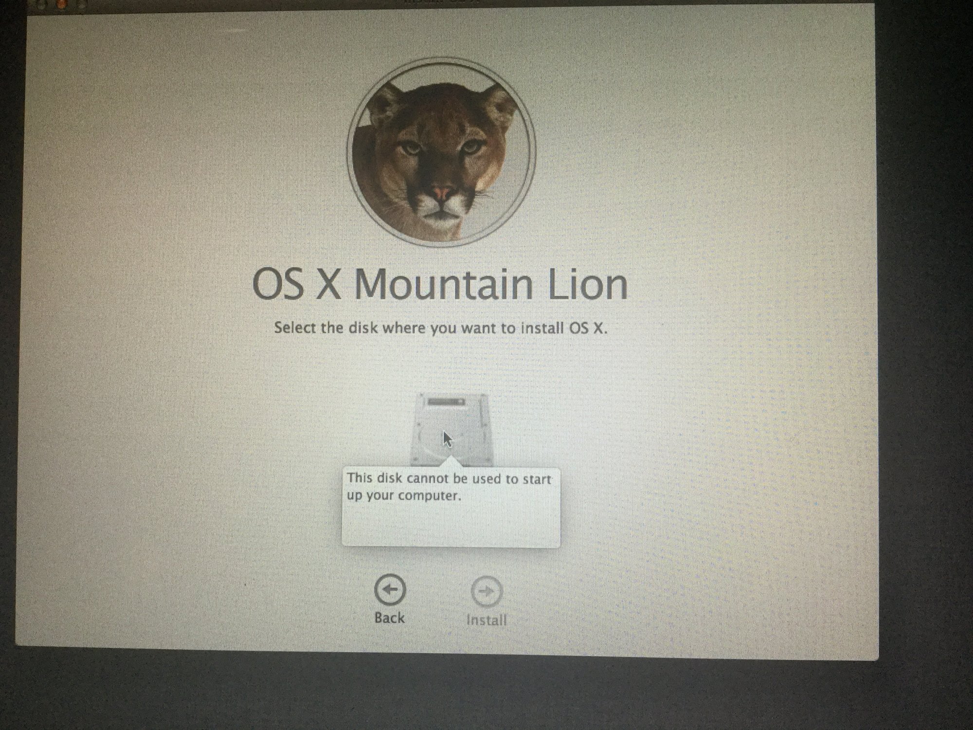

I’m also getting this when attempting Mountain Lion install

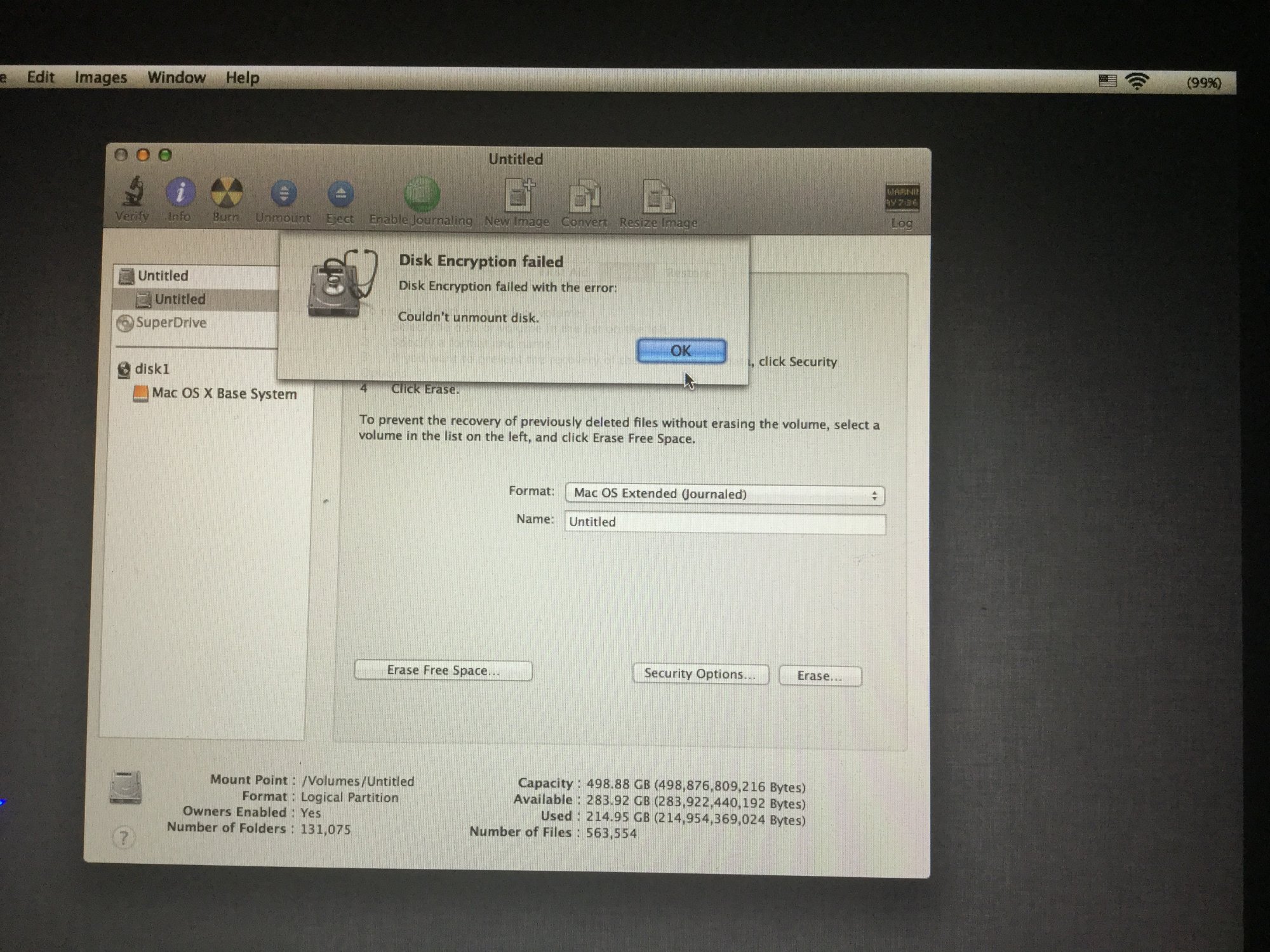

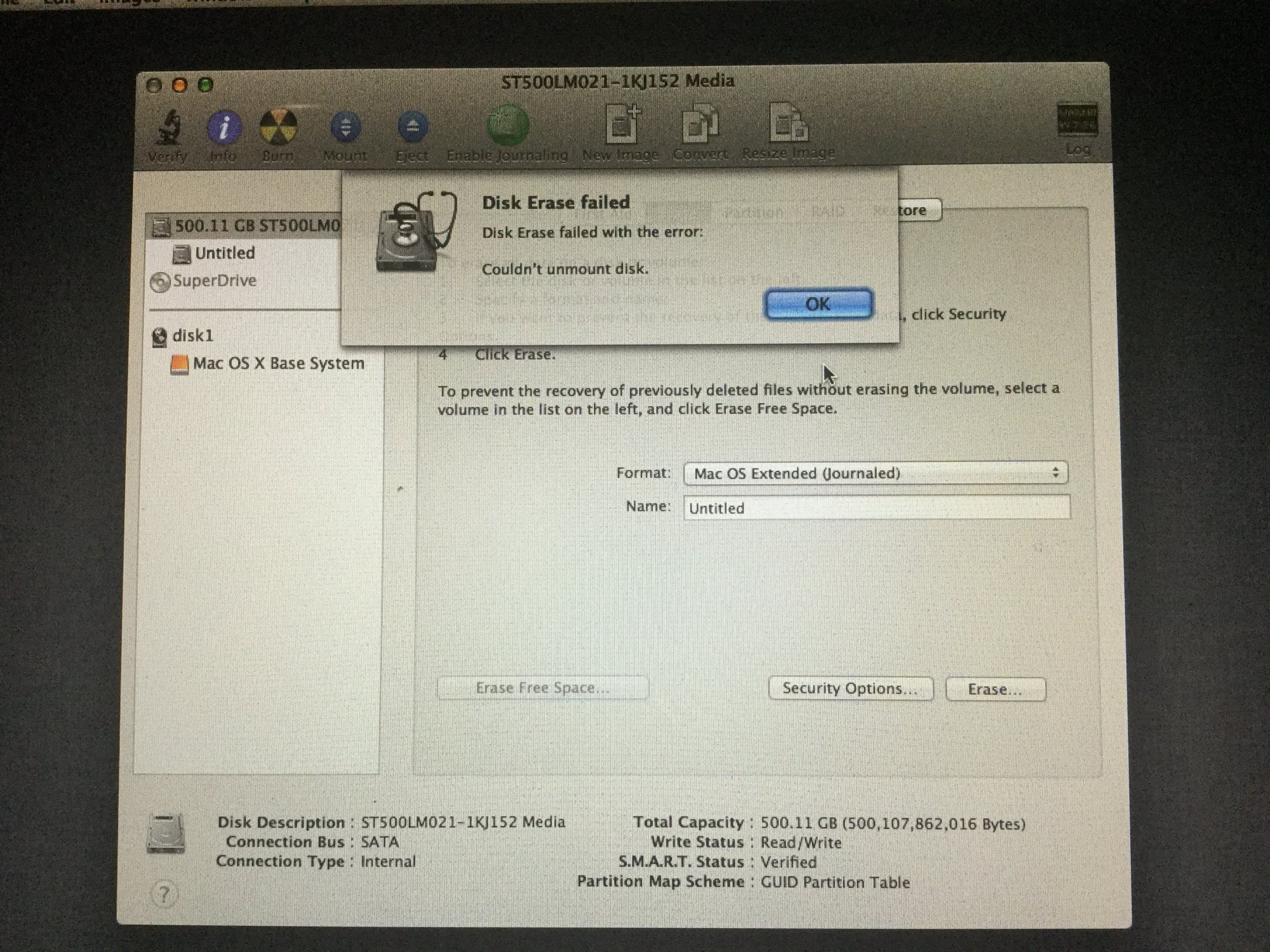

I was able to use terminal to format the disk to allow me to at least attempt to erase the first Untitled drive, but still getting us mounting issues with that..
Could it be that the drive is bad? Or a bad SATA cable?

You said that you WERE able to get booted via internet recovery, right?
In that case, looks like the internal drive has suffered a failure. (well, of course!)
It may or may not be repairable.
The fact that you've tried to reformat it -- and it WON'T reformat -- seems to indicate a problem with the drive itself. We don't know that yet.
Looks like it might be time to get another drive.
