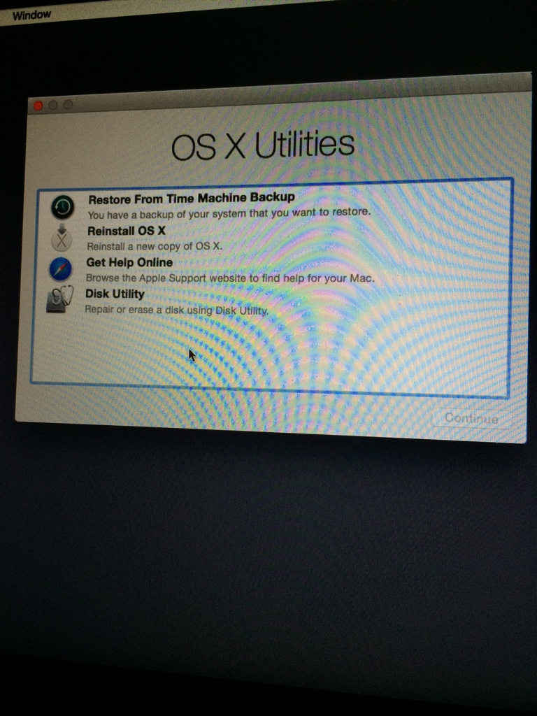

It won't let me safe boot or recover... Backlight keyboard isn't lite either.. I read a post saying that someone left their computer off overnight and it worked the next morning
Now this screen comes up after resetting it a few times... ImageUploadedByTapatalk1418578338.671939.jpgi need this computer to get fixed ASAP! This is really becoming a worst nightmare.

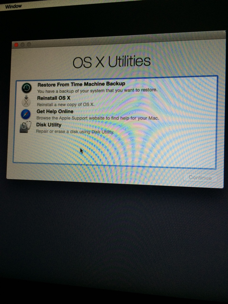

ImageUploadedByTapatalk1418578879.791103.jpgokay what should I currently do? I have my external harddrive and I can try to recover to my last back up.. Or I could wait until later tonight and install a fresh copy of os on my computer. I think for the time being im going to try to install from time machine ... Anyone reject? I don't know what gave me the issues in the first place..

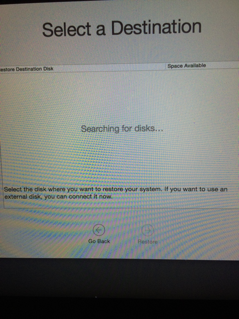

ImageUploadedByTapatalk1418579195.798767.jpgthis is weird.. It hasn't located my harddrive yet.. I wonder if there is an issue with the harddrive itself?
it could be the hard drive, but could also be the ribbon cable (more likely as they are notorious) Have a very close look at the ribbon cable and see if it has been rubbing on the case.

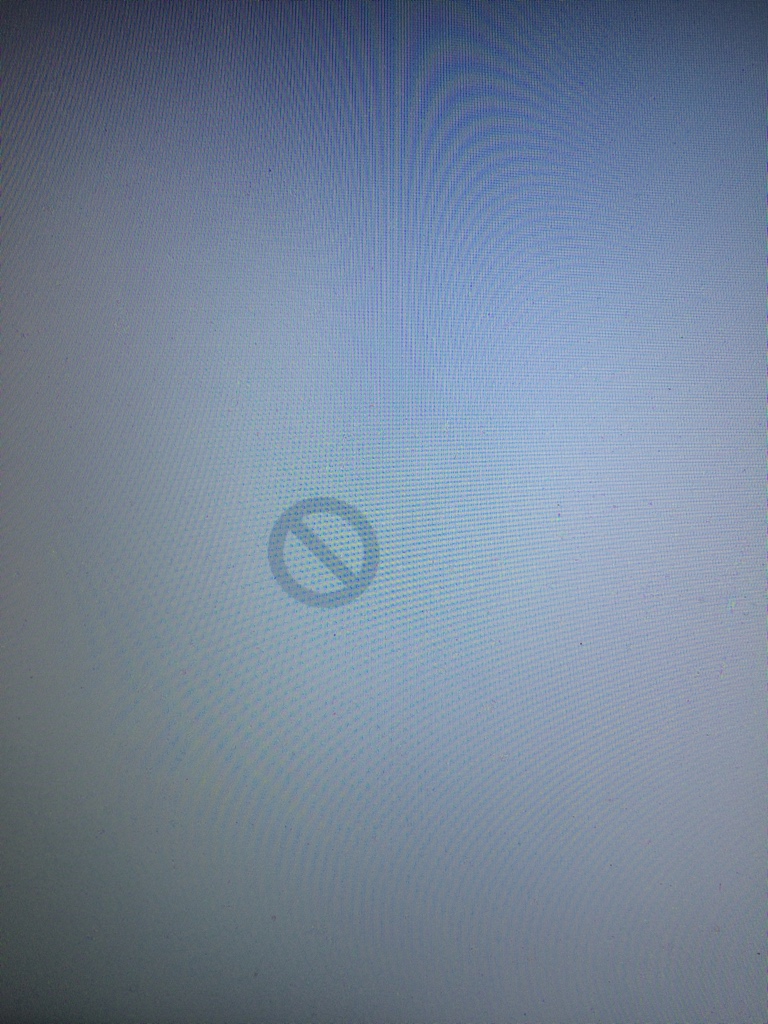

I'm currently trying to reformat (partition) my internal SSD so it erases everything and I can start fresh from a time machine back up.. But now the harddrive can't be unmounted.. And they couldn't repair the disk..
Edit* gave up on trying to partition the drive.. Anyone know what I can do to get past that stop sign?? Or repartition my harddrive or put my old hdd back in!? And erase the SSD ... I still have no idea what's causing the issue.. I'm 99% sure it's the hdd now.. But now 100%

I just watched a video on YouTube about that cable and I'm not getting that symbol.. I am getting the apple symbol but around the halfway mark the computer just shuts off..
it wouldn't hurt to go back to the original drive, and you could also examine the cable at the same time. Also put a strip of insulation tape between the cable and the chassis. the computer could be shutting down to protect from short circuit.
