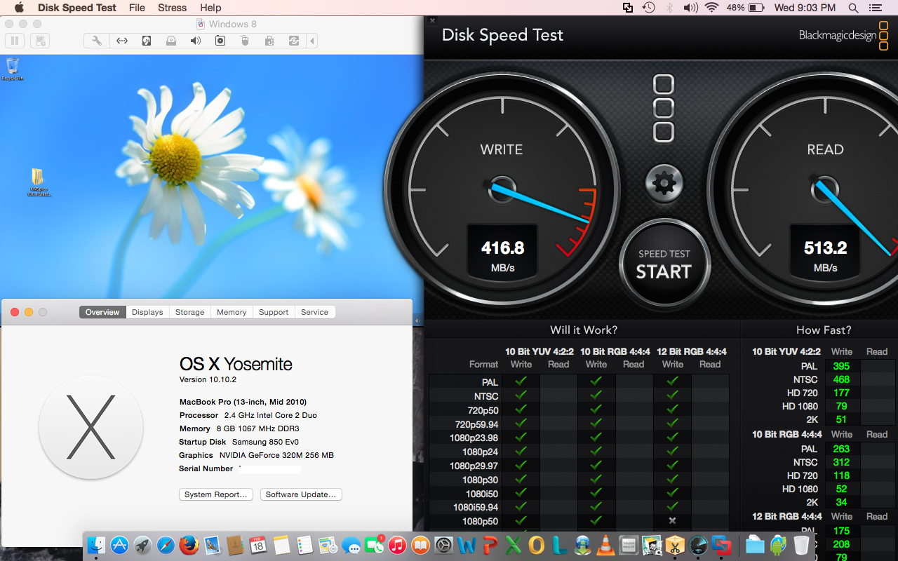

i have identical 2010 13" Mbp as yours, just upgraded to SSD and its runs like new again, created yosemite usb installer as well, finally got rid of bootcamp and installed VMware Fusion 7 and buttery smooth indeed.
