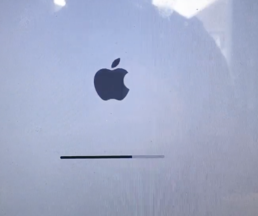

Hey guys, my MacBook Pro was running High Sierra 10.13.4. Hard drive was a little slow, so I upgraded to an SSD. Thing was running majestically for a couple of weeks. Realized I needed to update to 10.13.6, during the update I got a grey screen with the progress bar for like 15 minutes.
Then the screen went blank, and nothing happened. Restarted, same deal.
Did a time machine restore, then went to update, same thing.
Can't figure it out! Any help would be appreciated!

Would that manifest itself only during a software update? The thing runs perfectly apart from when I try to do a software update on it. Shuts down, boots up etc. So weird!
