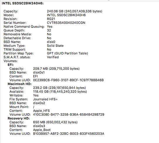

I have just under 120 GB free. I used to have a 128 GB SSD which had < 10 GB free. I bought a 240 GB Intel SSD and used Disk Utility to clone the disk. I was expecting to see a speedup in performance, but have been surprised that instead some apps are taking even longer than before to load.

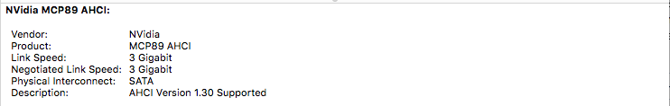

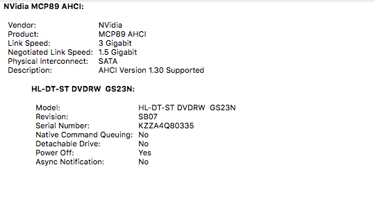

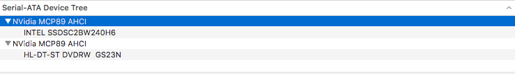

This is what I have under the SATA/SATA Express tab. Do you see a problem?
Thanks.
You have the MCP89 and your negotiated link speed is 3Gb. So that looks fine. There was a suggestion on the Internet that it could be a cable issue - but if your other SSD worked OK, that is likely to be an issue although in switching the SSD again, who knows. You may want to try your older SSD. There was another suggestion that it would work slowly coming out of hiberation. You can see if that's an issue. Others suggest the typical SMC and NVRAM resets, but I didn't see that anybody tried that and it worked.
