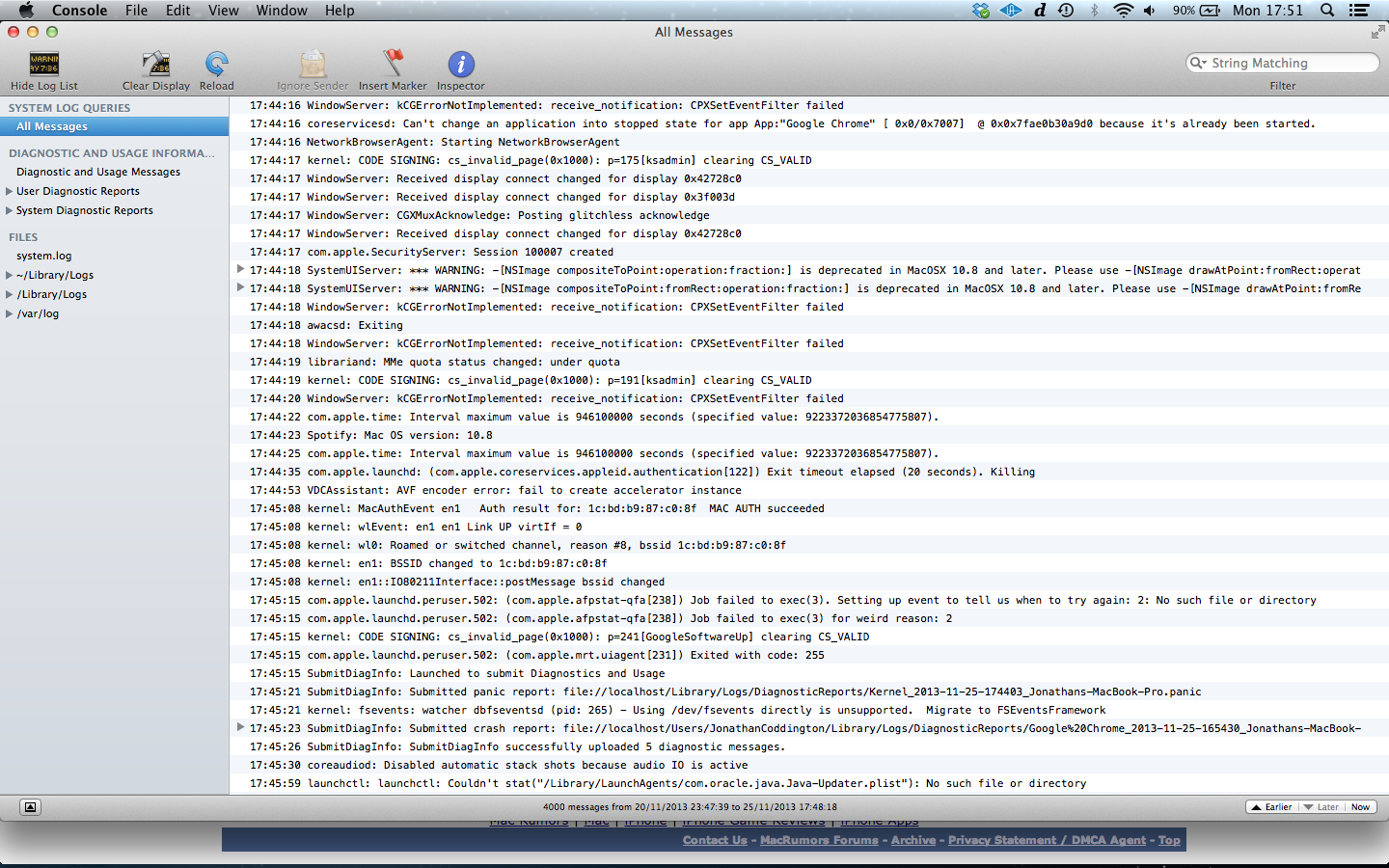

I used to use an ad blocker extension with chrome but kept getting page crashes within chrome. I uninstalled it hoping these problems would cease but unfortunately they still occur. I've attached a screen shot of the last few minutes of my console. Within this time the computer has restarted itself. Thanks for all your help guys!
could you show us, if there are any reports listed under the "-->System Diagnostic Reports"? (or user)
