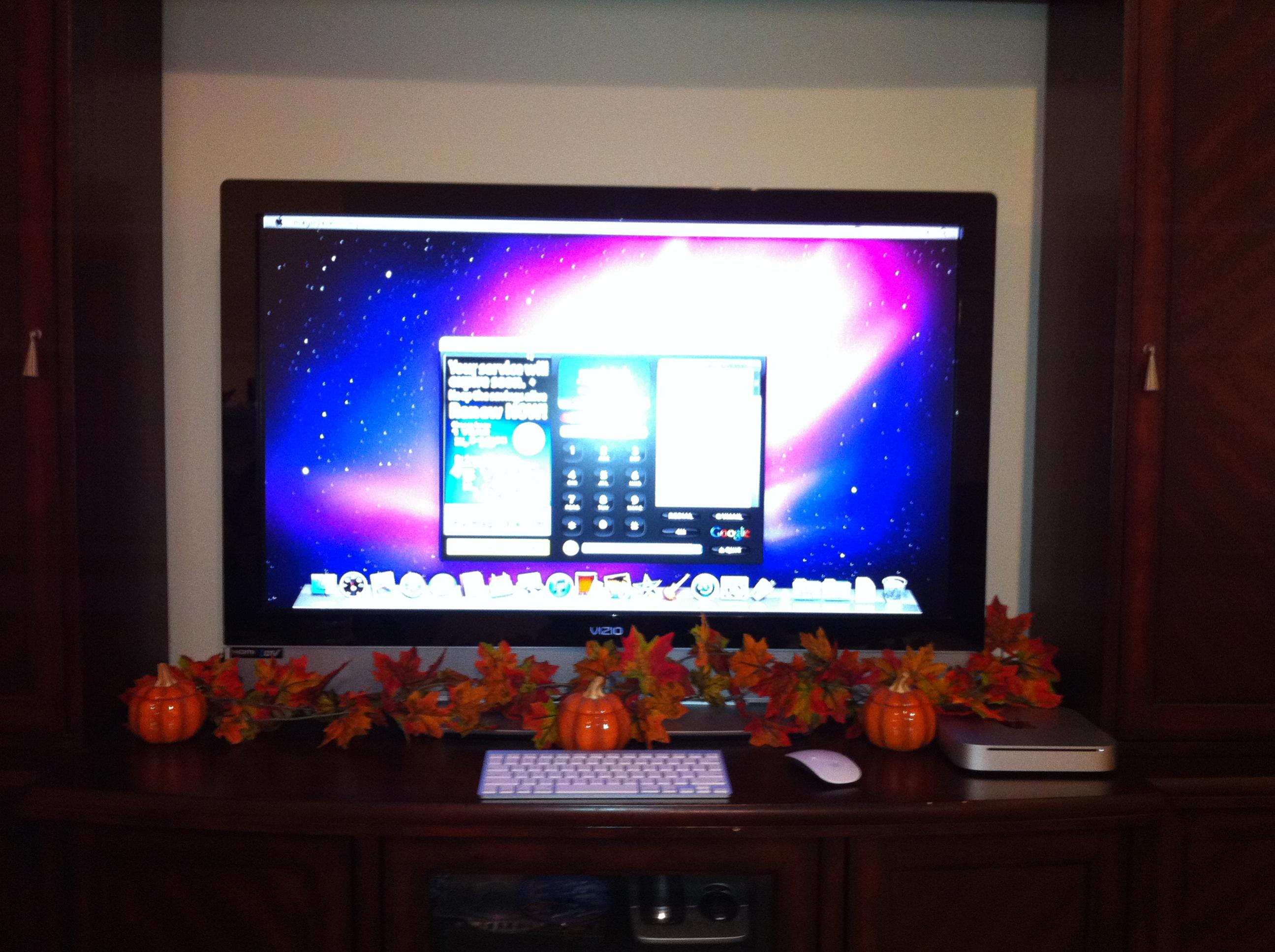

Here is my setup with a Vizio 42" LCD (NOT LED) TV with the 2010 Mini. I currently have it hooked up by HDMI and will agree that the text deos not look as crisp as with a desktop monitor, but for what I use it for it suffices.
I have heard that if you use the Mini Display Port to DVI with the included adapter that the picture is better, but then you have to have a way to get audio to your TV as HDMI does both. As soon as I can get my hands on a DVI to HDMI adapter I am going to try hooking it up that way to see if the picture improves any, just haven't had the time to get to it yet.
Sorry for the rough pic was taken with iPhone.
