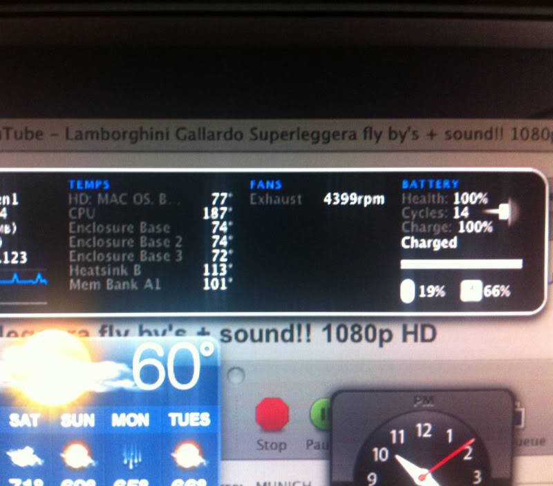

here's a shot of my istat while:
Watching a 1080P vid on youtube
Ripping a movie with handbrake
Rendering a pdf in photoshop CS5
Music playing in itunes
Safari on Macrumors
I'm really not worried about heat as I'll never be doing all that at once on purpose and I have never noticed my fans at 4000 rpm before this. typically around 2000 is where they are.

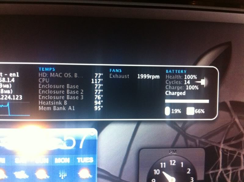

After stopping handbrake and youtube, cooling off
When I run handbrake I get 90-92C and the fans are at 6200 the whole time.
I definitely hear fans once in a while go to 4-5-6 thousand rpm.
Your one seems to be pretty good.
