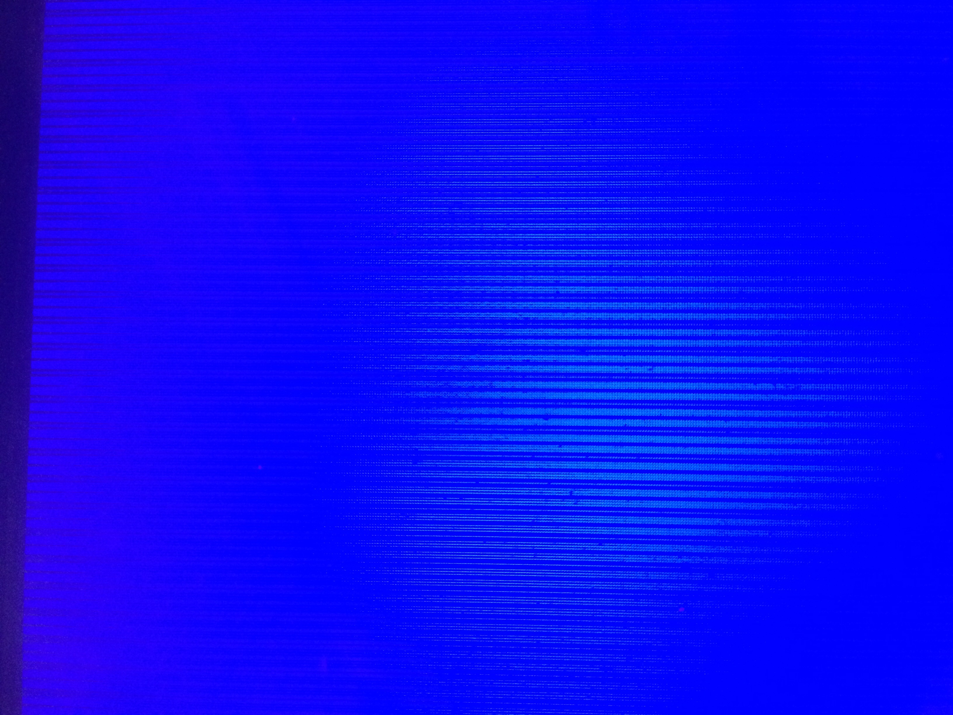

I tried to boot into recoveryfrom the HDD and the screen turned blue with vertical lines (top to bottom). What could this mean?
There's no way to make this sound good.
Search for "radeongate"
Your 2011 15-inch MBPro is one that's most commonly affected.
Your symptom of banding is just one of the symptoms.
It means your graphics chip is on its way down to failure.
Your issue is currently in tech news (and has been for some time now), and is also the focus of a class-action suit against Apple.
I had heard of the 2011 graphics card failures. Wasn't sure if this was related or not.
Thanks for the confirmation. Looks like I'll be buying a new MB sooner than I planned 🙁
