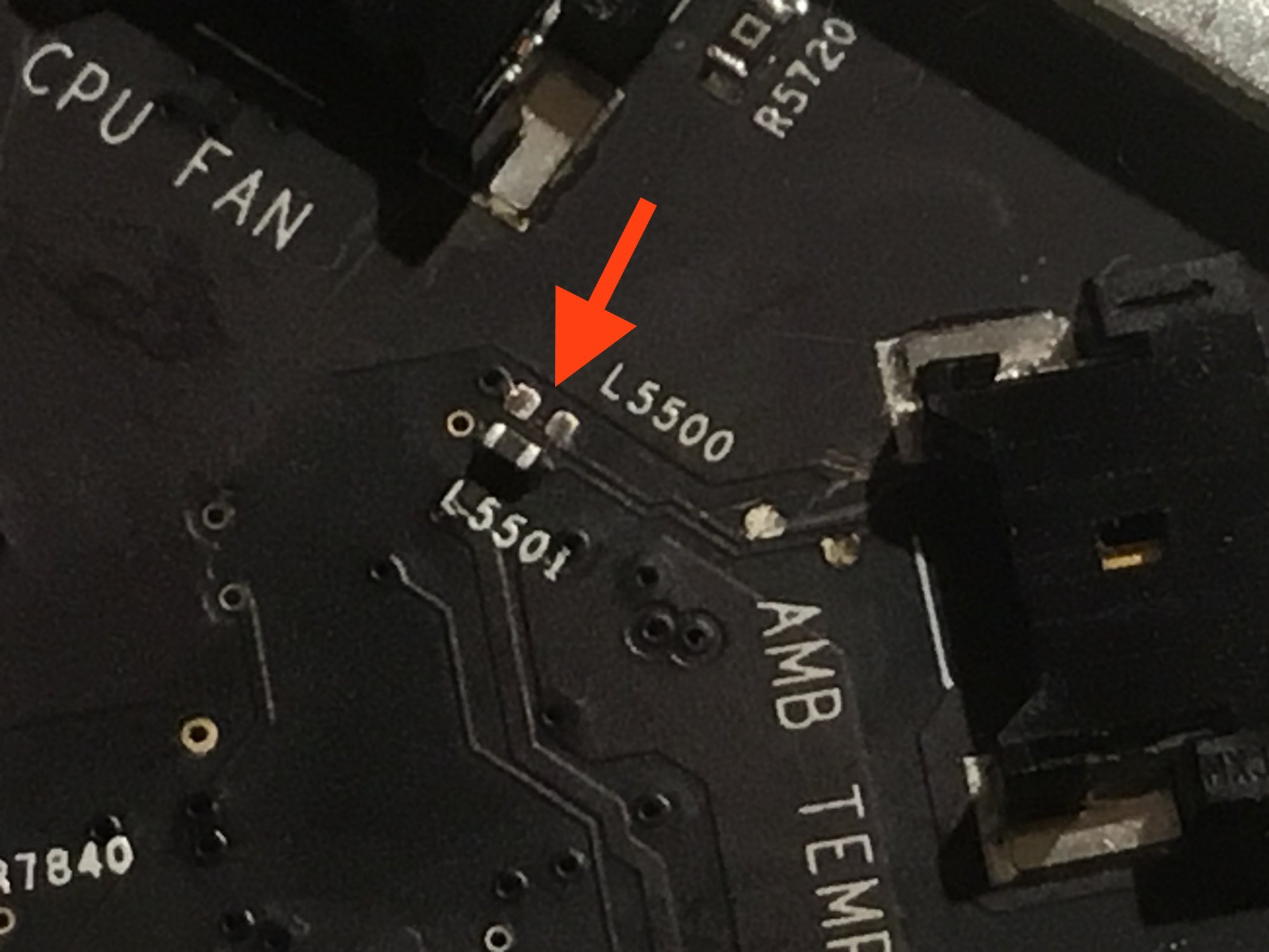

Disassembling my iMac ends with a 100% speed of all fans. HWMonitor shows 128C for the ambient temperature. The reason is a missing smd component on the logic board. Using my spudger to disassemble the ambient temp sensor cable caused a broken line s. picture.

Does somebody know what kind of smd I need to repair the broken line?

How did you pull a chip off the board? Wow...
Go big, if you can (If it's a capacitor), although 'L' usually denotes an inductor/coil/ferrite bead. Hmm... You may be screwed.
That was my first idea. Reading a thread where someone had issues with this solution let me hesitate.
Yeah, bridging it with wire is only a great option if it was already a wire. If you have the old chip fleck, and know someone with a surface mount heater (or go 'caveman' and use a hot plate). A heat gun can be used too, but be careful, because if there are any chips on the backside, you risk making a bad situation so very much incredibly worse if too much heat is applied. Possibly with a fine point soldering iron, you might be able to gently reheat the solder with the fleck in place. Don't lift that tab though. It's a challenge. I've done a few SMD repairs, and sometimes they work, and...
At least it doesn't look polarized which is fantastic.
Without the fleck, you could be shooting in the dark, but it could be a commodity part too. No, wire? NO!

I had the same problem.
I've tried to resolder the 0402 resistance, but it's soooo small, and I fired the resistor (it is black now)
I've finally bridge the L5500 connector (with a simple drop and the camera macro zoom), cut the black wire of the ambient sensor, and insert a 220 Ohm resistor in the middle (solded and protected with a heat shrinkable tube).
The ambient sensor works again!

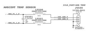

L5500 không phải là tụ. Nó là cuộn cảm.
Có thể thay thế bằng điện trở 220hm, hoặc 0ohm. Xem hình sơ đồ rút gọn ở post #8.

LM5500 is not a condenser. It's more like a coil.
You can replace it with a 220Ohm resistor or 0 ohm resistor, like the previous described "bridging"
Check the layout chart on post #8.
