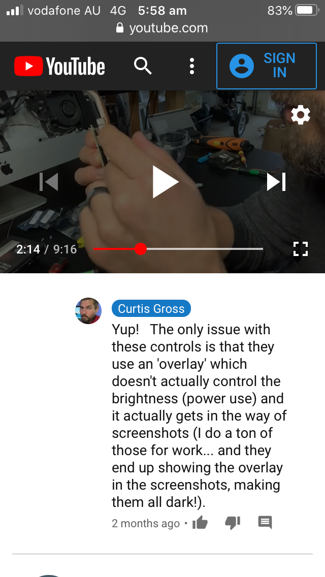

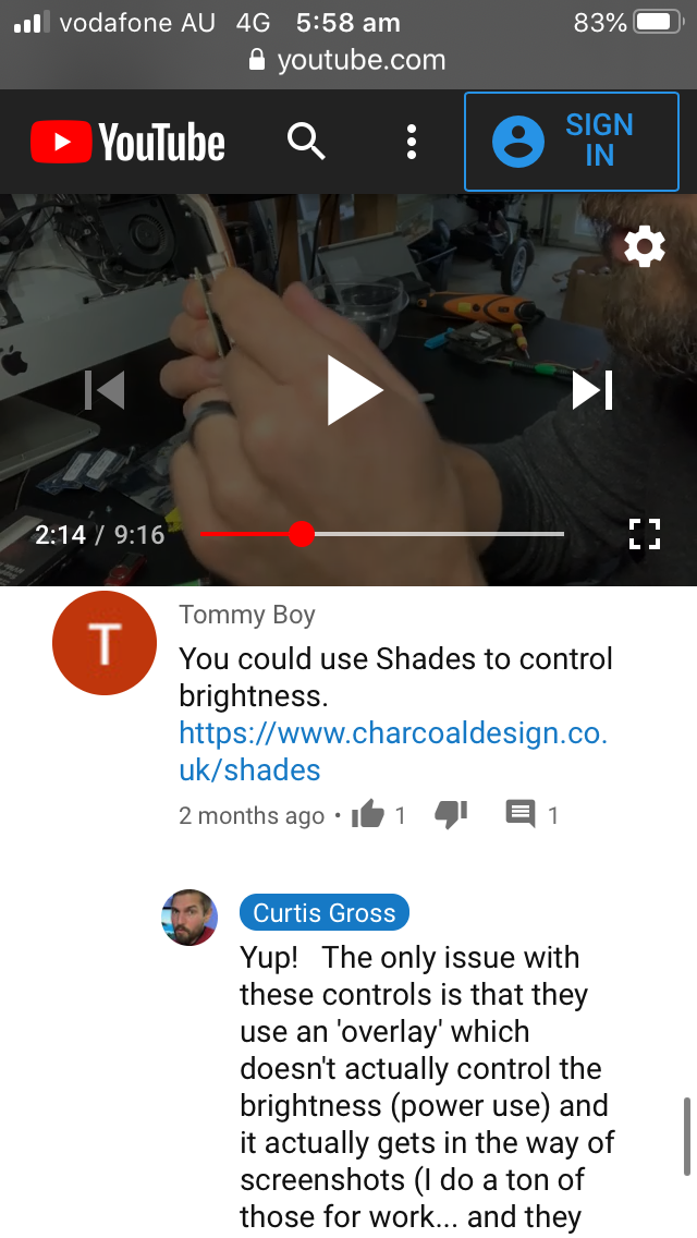

However after watching this guy on YouTube replace his AMD Radeon 6970m video card with an Nvidia GTX 765M video card ONLY to realise in the comment section he SWAPPED out that GTX 765m and put another AMD in there because of brightness issues -
My question is - currently is there ANY existing GPU I can put in the iMac where it DOESN’T stuff around with the brightness as you can see here -

But I don’t understand what they mean by “these cards offer right now native brightness”.
What is native brightness? Will it use an dark overlay as that guy mentioned in the comments above and make all your screenshots dark?

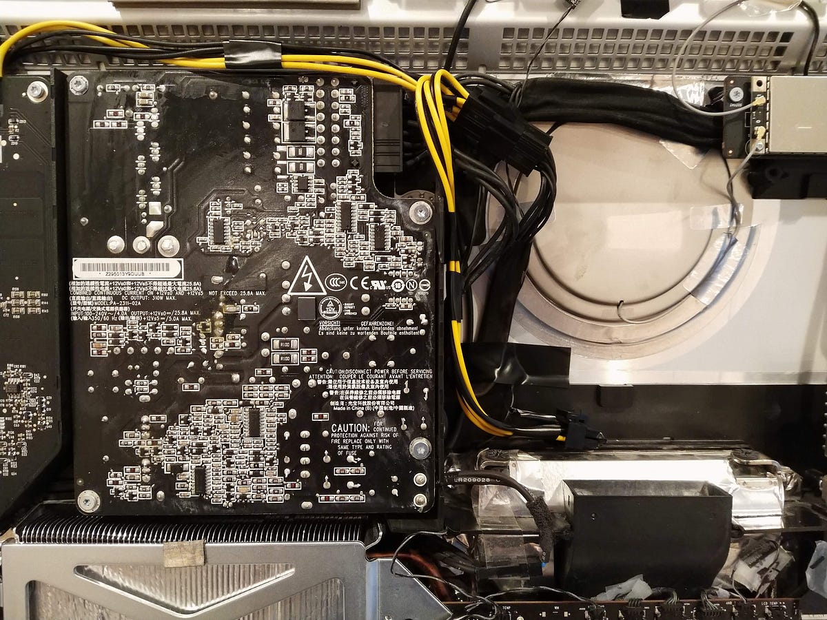

If you feel comfortable with a tiny bit of soldering, I just modified my Late 2009 iMac 27 with an ESP32 that's generating a new PWM signal. The soldering is just to extend a wire on a $7 wire harness you need to buy, everything is reversible no changes to the Mac's original components.
That writeup is a bit long but you just need to get a 6pin PCI-E extension harness, cut 1 wire and route it to the ESP32 running micropython, which can be connected to a USB port internally or externally. You need to run a little app to send commands to the ESP but it behaves like normal brightness control then.
