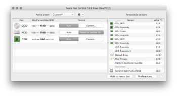

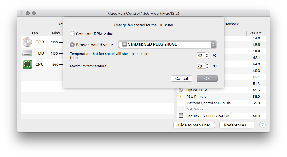

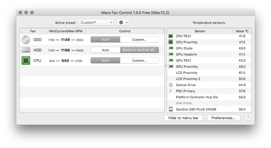

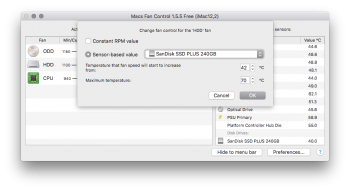

For those like me who were coming across a bunch of different guides about what and what isn't needed: I can tell you that I'm now running an SSD in a refreshed Mid 2011 iMac with just:
- the SSD itself (Sandisk SSD Plus)
- a Torx T10 Screwdriver
- some Velcro to mount the drive
- Macs Fan Control
I didn't buy the OWC cable or do any hardware modification other than swapping the disk.
Macs Fan Control sees the temp sensor on the SSD and uses that to adjust the HDD fan speed! (you have to set this, see pic)
I'm delighted, wasn't too comfortable going inside an iMac despite having been in countless PCs and laptops before but it was completely painless, now to upgrade everything else inside this thing!

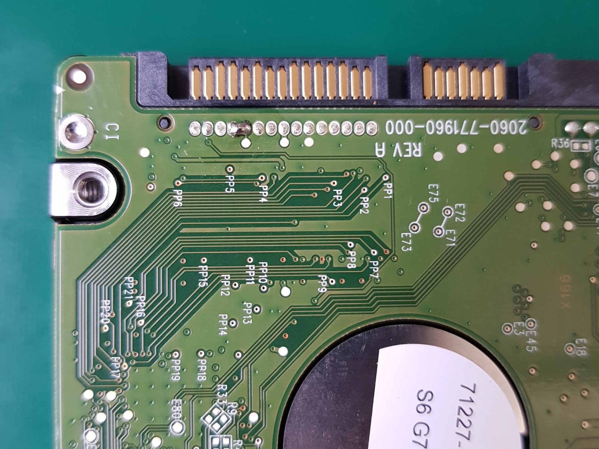

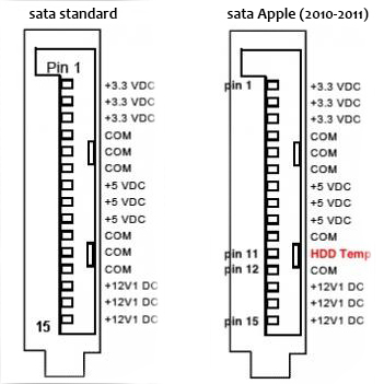

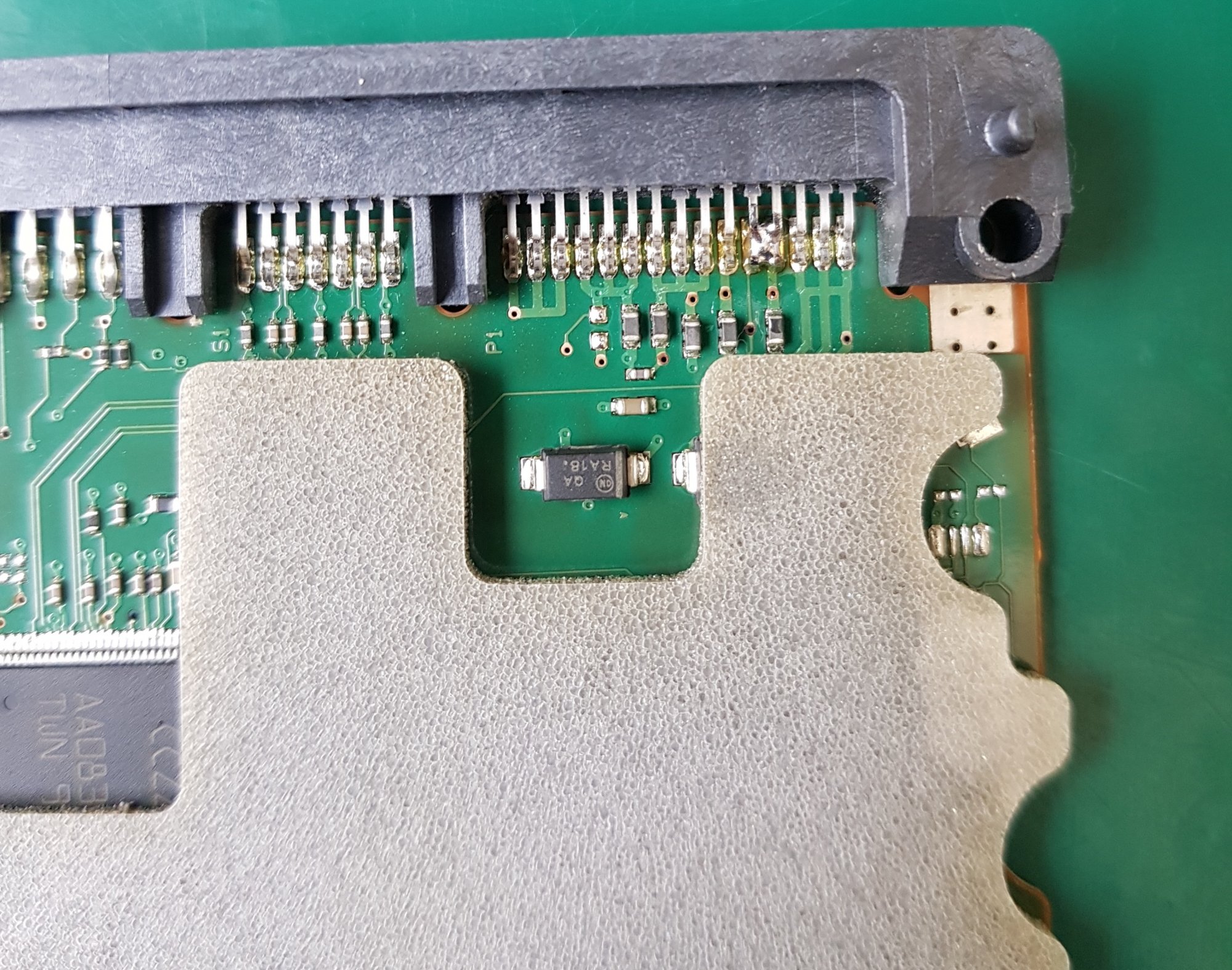

using a software won't stop the noisy fan from power on to session screen.
Here is the solution ! This make your HDD or SSD like an original one, and enjoy the silence 🙂
You need to make a connexion between pin 11 and pin 12
Some pictures

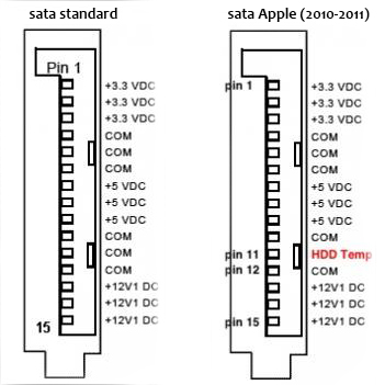

Some pictures
Hi!
You are talking about the mid 2011 systems?
I guess this is exactly what happens when using a SATA Y splitter cable. It shorts PINs 11 and 12. But this is NOT the same as the original solution. If you deactivate temperature control and lock the fan to the minimum RPM of 1100 there is - deactivation - no temperature control at all. Or have you ever observed a rising fan speed of the HD fan?
To get a control at the very end in case of real high ambient temperatures you should install Mac Fan Control additionally. SSD can become hot if you write huge amounts of data onto it. Having a fan in place to bring down the temperature make expected live span of such a device longer...
But really good to know this little solder hack. I will give it a try on one of my old HDDs later 🙂 Cheaper than a 4 Euro splitter cable...
Thanks for sharing!
yes just take a look at my signature 🙂 iMac 27 mid 2011
sure no temp control, but you can watch the t° using macsfan for exemple
I have done it on my ssd 🙂 and the previously HDD
sorry for my bad english 🙂

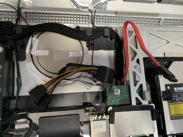

Normally I use this setup:
Grab a normal SATA data cable (red) and connect it to the port 0 on the back side and a splitter to get a second power source.
Reverse the old data cable to have the flat side out and the 90 degree plug on the unused data port 1.
Connect the splitter cable and take a 3.5 to 2.5 inch conversion frame. Now you can connect easily two 2.5 disks without bending plugs and without a roaring disk fan in the morning 🙂

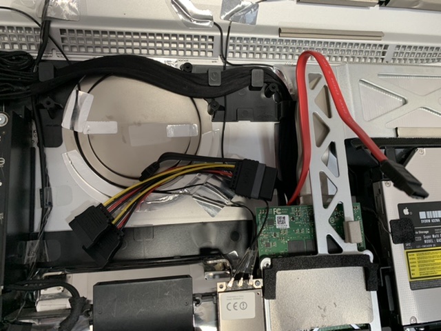

Hey Ausdauersportler
I’ve got some questions regarding your setup. I want to upgrade the old hdd of my Imac 27” from 2011 to a ssd. Now I’m concerned about the fans running at full speed after the exchange but I have seen that one can bypass this issue by using a SATA Y-Splitter cable. My question is how and where exactly do I need to plug in the Y-Splitter if I just want to use one ssd and do I need an other sata data cable or can I just use the cable that Apple originally used to connect the old hdd?
thank you
There is only one way you can connect the splitter and you need no second data cable. You even need not to reroute any cable. Just disconnect the old disk, install a frame and the new SSD, use the splitter in between the old power cable and the new SSD.
Use Mac Fan Control to watch the heat inside and to control the HDD fan. Heat can kill every electronic device.

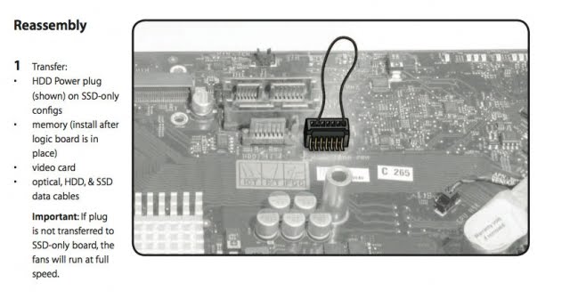

in iMac 2011 just plug that goes into the HDD power connector that shorts pins 2 and 7
in iMac 2009 just use 1k ohm resistor as thermal sensor
