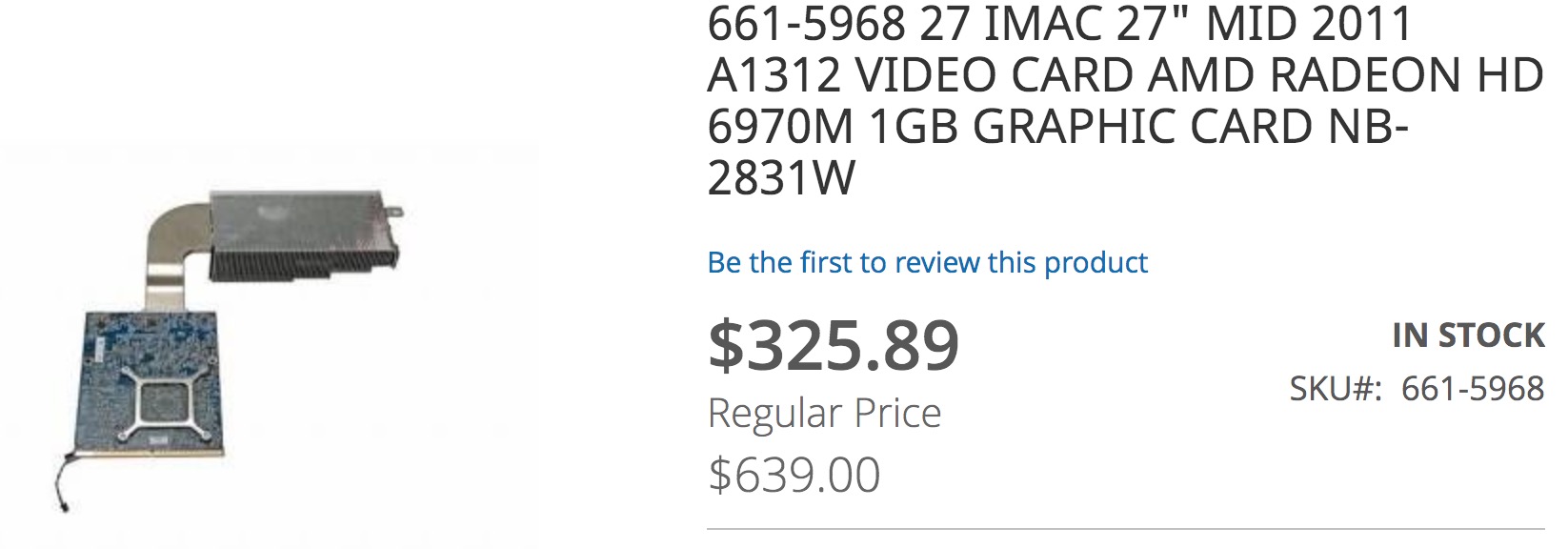

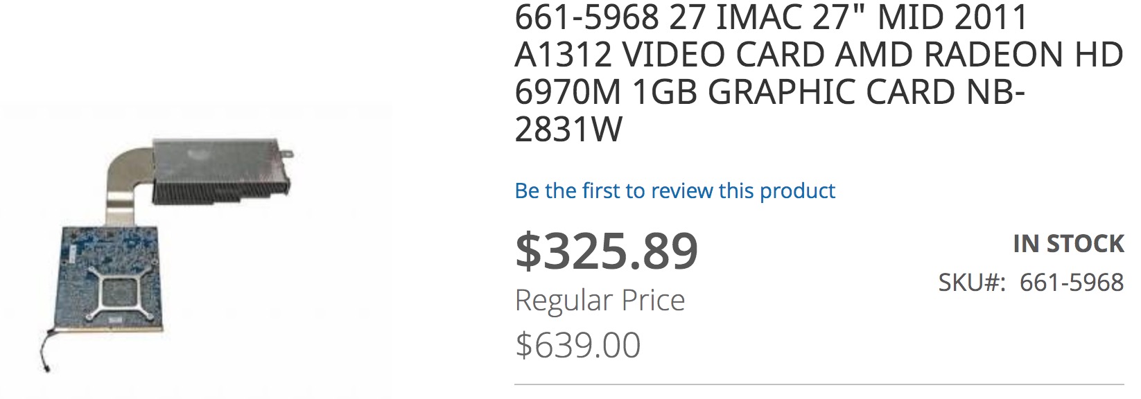

That makes good sense. About 3 years ago Apple replaced a video card in this same computer for free. The free replacement deal most likely is expired. I'll check if there's any warranty left on the replacement. I looked on ebay. Looks like these go for around $320 new or $230 refurbished if it is the APPLE IMAC 27" A1312 Mid 2011 RADEON HD 6970M 1GB GPU VIDEO CARD. I'll look for a used one. Is what I'm after the one pictured? Thanks for taking the time to answer.

Yes, that's the one, only for me it was a 6770M card as my machine is the lower i5 model. You'll need to read up and watch a video on how to do it, its not so difficult, you just need a cool head and some patience LOL. Oh, a pair of suction cups to take the front glass off are handy, though I believe you can prise it off with your fingernails, or so they say. One of those multi-bit screwdriver sets is good too. I got one with 31 different tool heads in it, it includes all sizes of those six-pointed star drivers that you'll need.

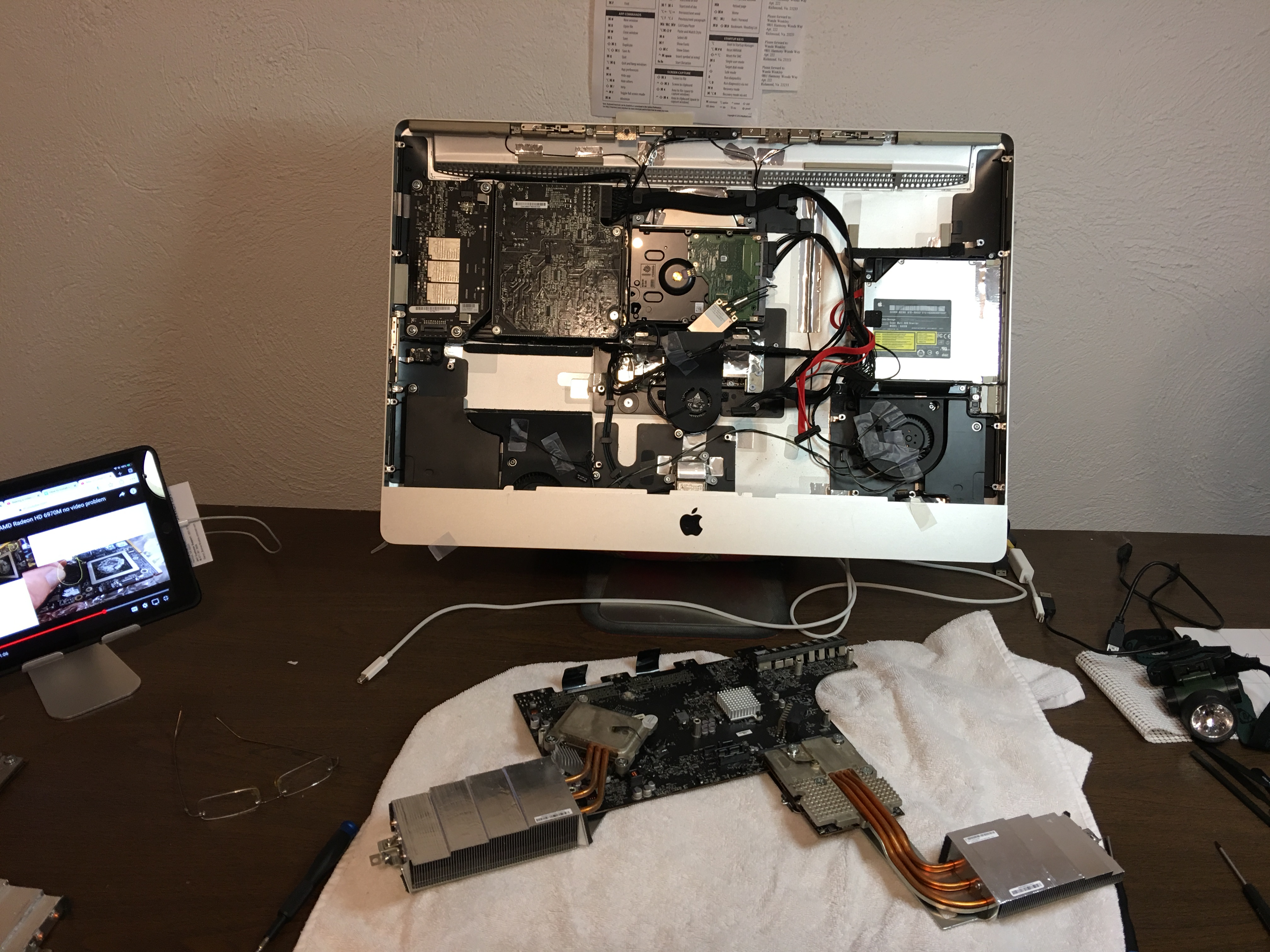

My mid 2011 iMac 27 3.4 i7 20GB RAM, 500Gb Samsung SSD + its original 1TB HDD I left in when I put in the SSD. Running High Sierra......anyway I was using it and I heard a little pop. Screen went to black.

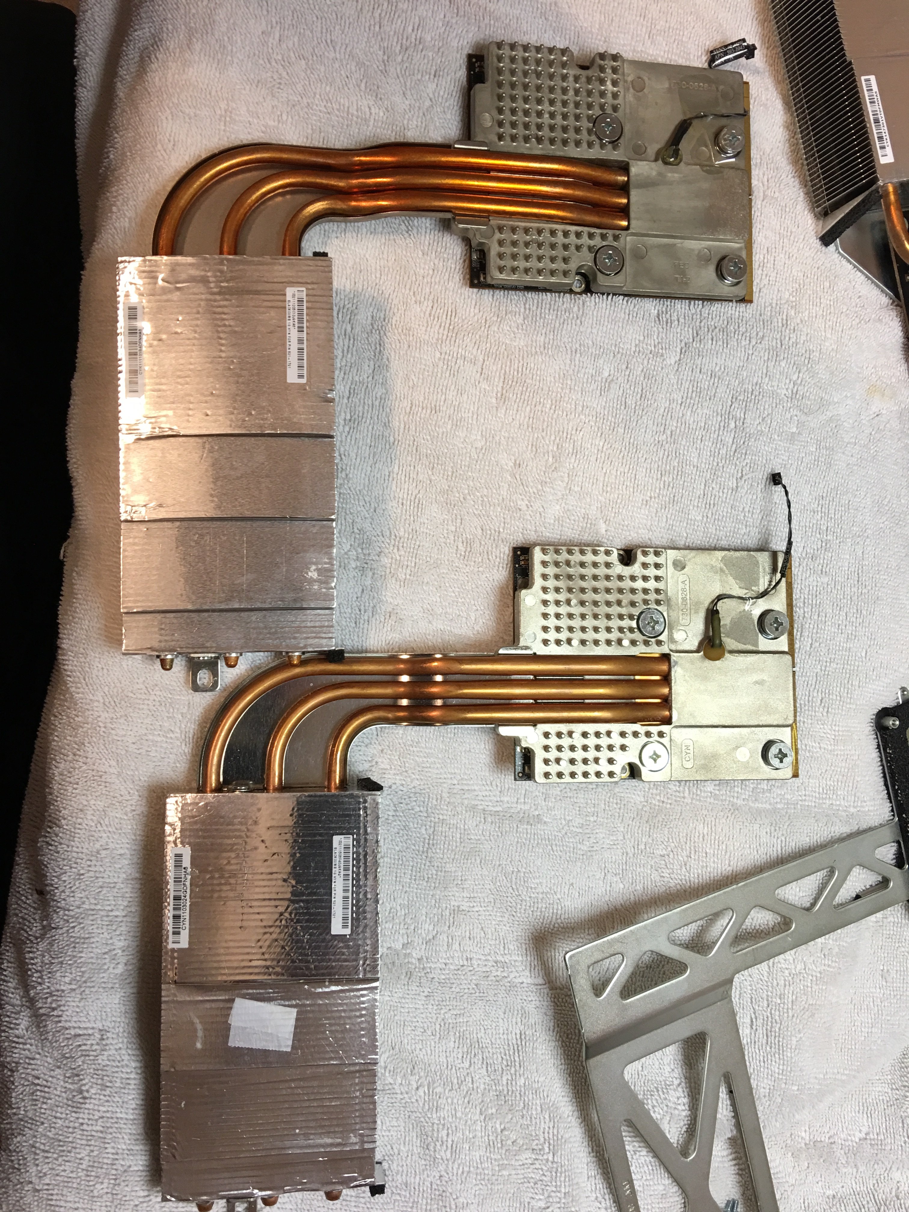

Nothing I tried would revive it. When I would start it up, it seemed to behave perfectly.....normal chime and I could hear the usual sounds from inside but screen stayed black. As a result of my previous thread and the much appreciated help I got there...I bought a used vid card and heat sink. Opened the iMac. Had to remove mother board because vid card/ h sink screws were on the back side of m board (couldn't be on the front of course). I put in the new used board/sink combo, replaced mother board and reconnected all cables, put RAM back in. When I plugged in the 4 cables between mboard and LCD, I ruined the screen display flex cable. New one arrived today from Amazon. I plugged in the LCD and with great anticipation, plugged in the iMac and hit the power button.
No new results. Puter started right up making all the right sounds but screen is still black. I shined a light on it to see if I could see anything on the desk top - nothing. Plugged in a wired keyboard and hit the Fkey to increase brightness - still nothing.
At this point, I can't be sure my original vid card/heat sink was bad since trying a new/used one didn't help. I'm confident I did well as to removing the mother board and later replacing it and successfully reattaching all plugs/cables, reinstalling RAM etc. because startup sounds normal. I was extremely carefull to make sure I got the exact replacement parts for this particular machine.
So that's where I am. Though this iMac has age on it, it's a terrific machine I've always enjoyed and I really want it back in action.
I'd be greatful for trouble shooting advice or ideas. Maybe it's time to turn it over to a pro or atleast take it somewhere for a diagnosis.
Thank you,
Reed. Below - old and new parts and pic of the teardown.
