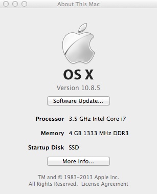

Upgrading my 2011 Imac
Hey guys i recently upgraded my processor from i5 to i7 2700k. All went well, except when i start my machine, i get a message saying "your computer restarted because there was a problem" And i get some error reports.
But occasionally i get in and everything is fine. Do you think i made some mistake while installing the cpu?

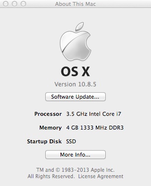

Hello:
I got the last component today and couldn't wait: took me about 3 hours, but finally have my system upgraded to:
Core i-2700k (3.5ghz) processor
Radeon HD 6970M (2gb)
32gb Ram
I attached a screenshot of my "About this Mac, more info" to this post, not sure how it will show.
whew! putting all the wire connections back on the motherboad (~16 wires) and getting the MB back into place correctly adjusted was the hardest part I think.
My computer seems faster🙂 I finished maybe 15 minutes ago, and not sure how much faster it is yet, but once I start playing with it I'll post back my opinion.
Cheers,
Kenny

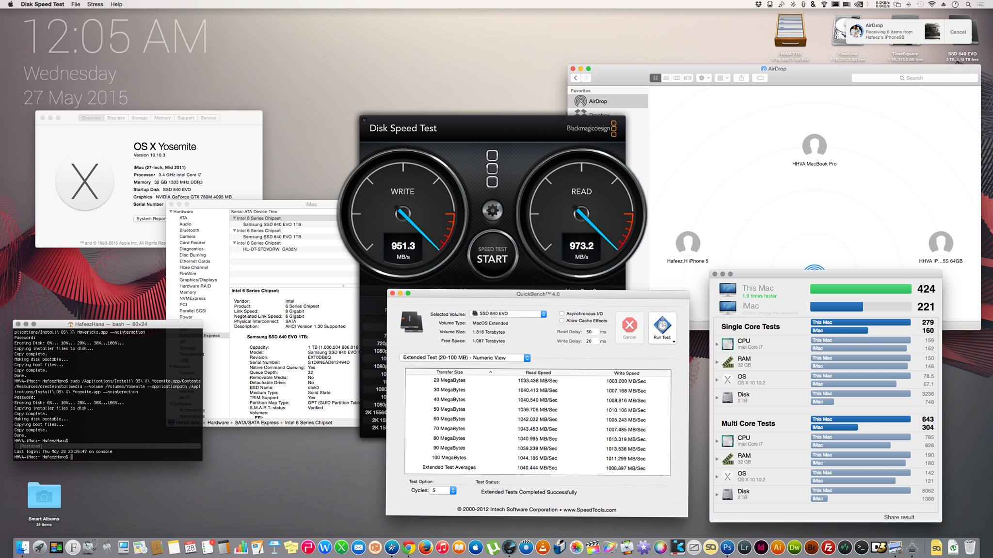

I have done mine
Basic iMac 27" mid-2011
- Intel i5-2500S to i7-2600
- standard 1TB to 2TB RAID0 SSD
- Airport upgrade (handoff & continuity enabled)
- ATI 6770m to GTX780m
* attached photo shows previous OSX Yosemite. currently running smoothly on El Capitan.
