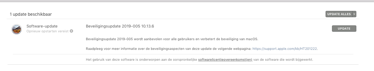

High sierra security update 2019-005 has been released.
Anyone here ? can confirm if this will update or remove the bootrom patch from Nick ??
I personally doubt Apple will release newer bootrom versions for these iMac's, but you never know..
I just installed that update and it did not touch my bootrom version, but I have said that before... 😉
