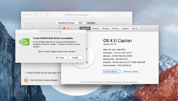

Guys, just wanted to share that the latest ElCap10.11.3 with the new nVidia WebDriver are awesome!
P/S - still have issue with the initial boot screen and brightness though

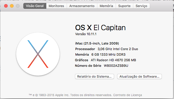

Hi folks, first sorry for my bad english xD
I want to know if i can upgrade My old 21.5"late 2009 iMac with HD 4670 256mb to a Radeon HD 6770 1GB (is not the one that comes with the iMacs, it's a laptop board bought on eBay, but the model is MXM III Type A).
If is possible, after this upgrade i will lose the initialization screen and brightness control? because this board comes with 2011 models and if i'm not wrong the kexts already exist in OS X
