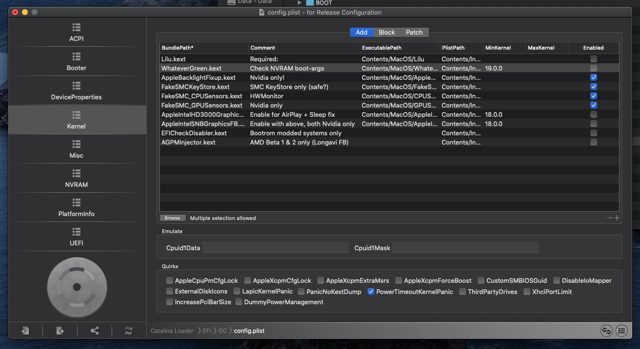

And why are Lilu and Whatevergreen enabled in Kernel when we are using a Metal supported K1100M?
I was under impression these kext are not necessary for Metal GPUs!

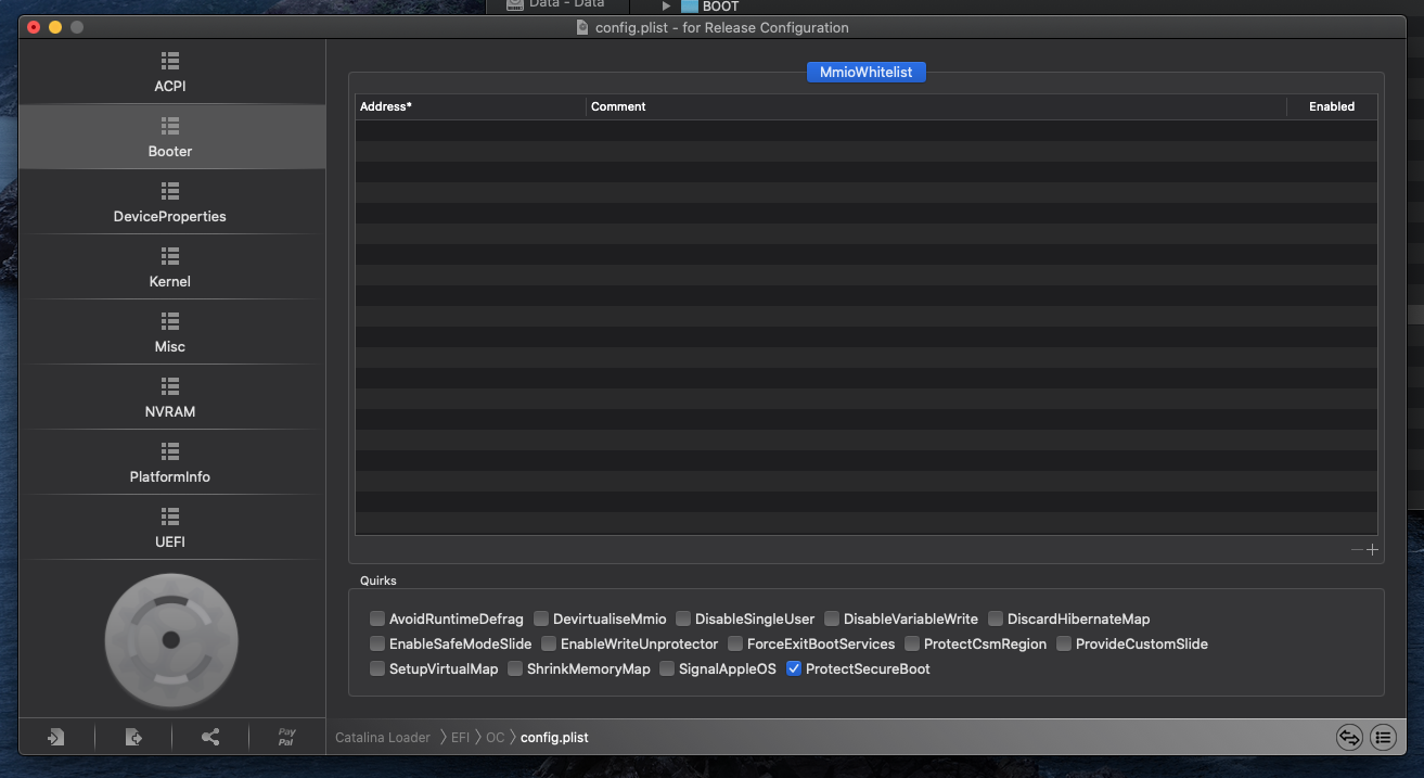

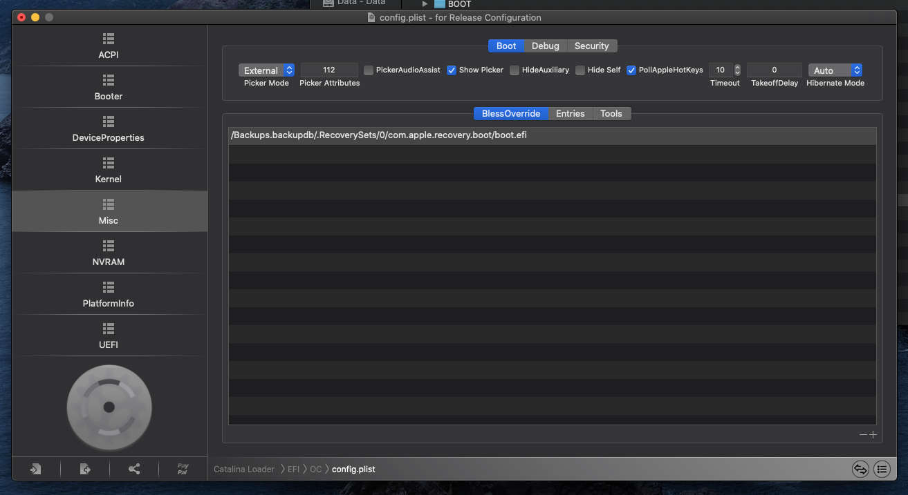

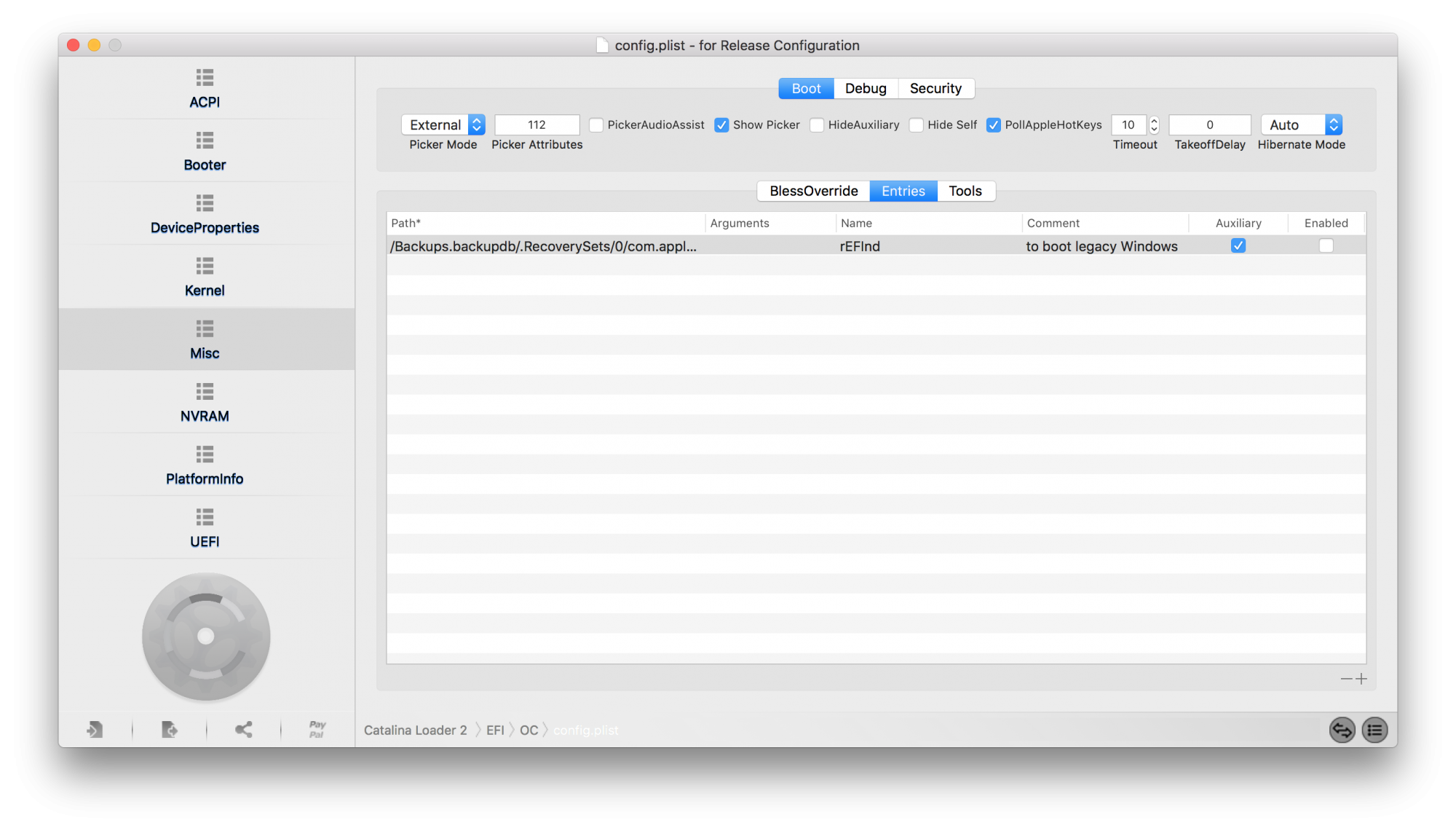

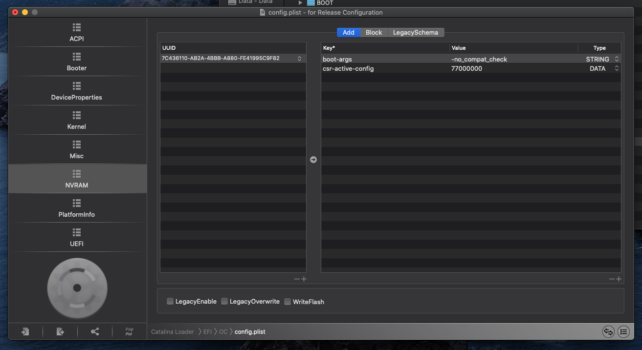

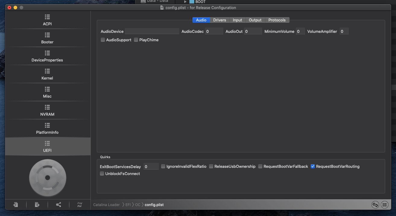

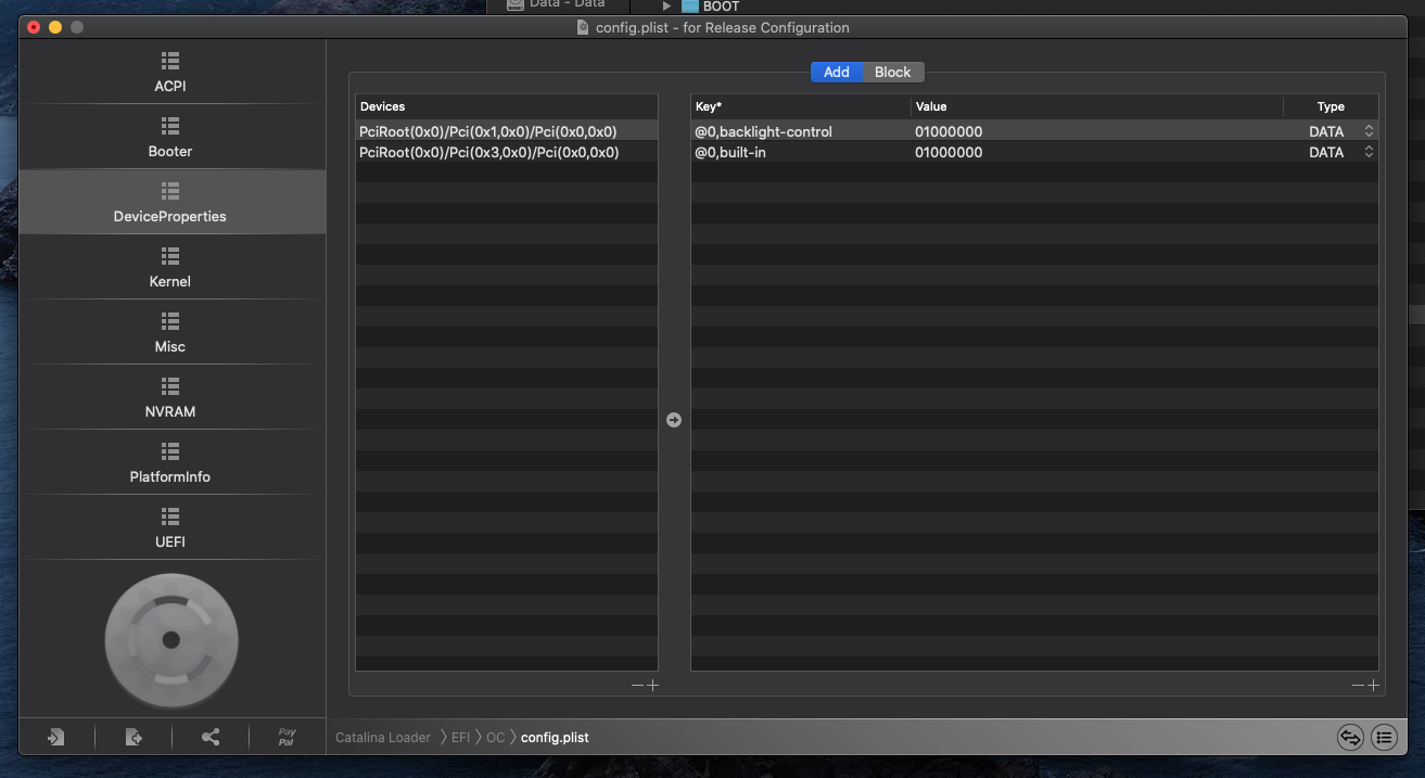

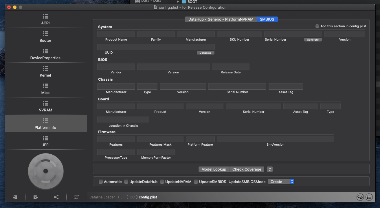

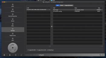

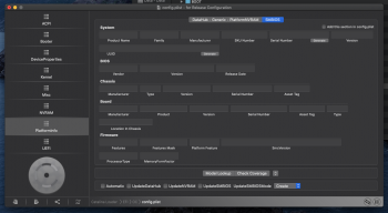

Here are my screenshots regarding its settings:

Another odd observation. Pressing the Option key at boot will sometimes bring up the efi screen in 6 seconds. On the next boot it can be as long as 45 seconds. The times seem random. Is this a bug in powering up the LED?
But this IS NOT my experience. I have been using a 2009 27" iMac Core i7 with a K1100M with stock settings running Catalina 10.15.4 with a stock Balena-etcher installed core configurator SD card in the side slot and Catalina Loader set as the Startup disk and I have to use the Option key pressed at boot to get a screen.
I have done this install three times using the latest dodsude1 1.4 Patcher again this morning and still the same "problem".
Now I've started looking at the configutation tool but find the explanations are too thin for someone not an reFIND expert.
Obviously something is different with my setup in some way from yours, but what? I cannot spot it despite reading this thread for hours.
There has nothing to be changed from the stock settings if you go with Catalina on the 2009/i7. Just rewrite your SD card, choose it as startup disk and retry. Only owners of mid 2011 models (using a sandy bridge CPU) running Mojave or Catalina (or AMD card users) have to do configurations and local installations of kext and frameworks....
Rewrite your OpenCore image as I wrote before.
Check if Lilu and Whatevergreen are selected by default yourself.
Open System Preferences, search for Startup Volume, select the "Catalina Loader", enter your admin password, and press "restart",... and wait. The system should do a restart booting into the CL and coming up with a slightly different boot picker. Choose your Mac installation disk and that it is.

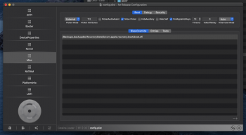

What does your boot screen look like after choosing the Open Core SD card? The correct boot screen should be a Black Screen with different boot disks. It SHOULD NOT say rEFInd anywhere! If this is the case then there is a chance your keyboard is being Double pressed and your iMac is actually leaving BootLiquor.EFI (the proper boot EFI that loads the proper OC settings) and is entering rEFInd which doesn't load OC settings. Do you also by chance have an EFI copy of W10 installed? If so please also perform a PRAM reset.
If you are really having issues with rEFInd and can't stop it from loading you can open your config with Open Core and disable the rEFInd in the MISC/Entries, section unclick Auxiliary

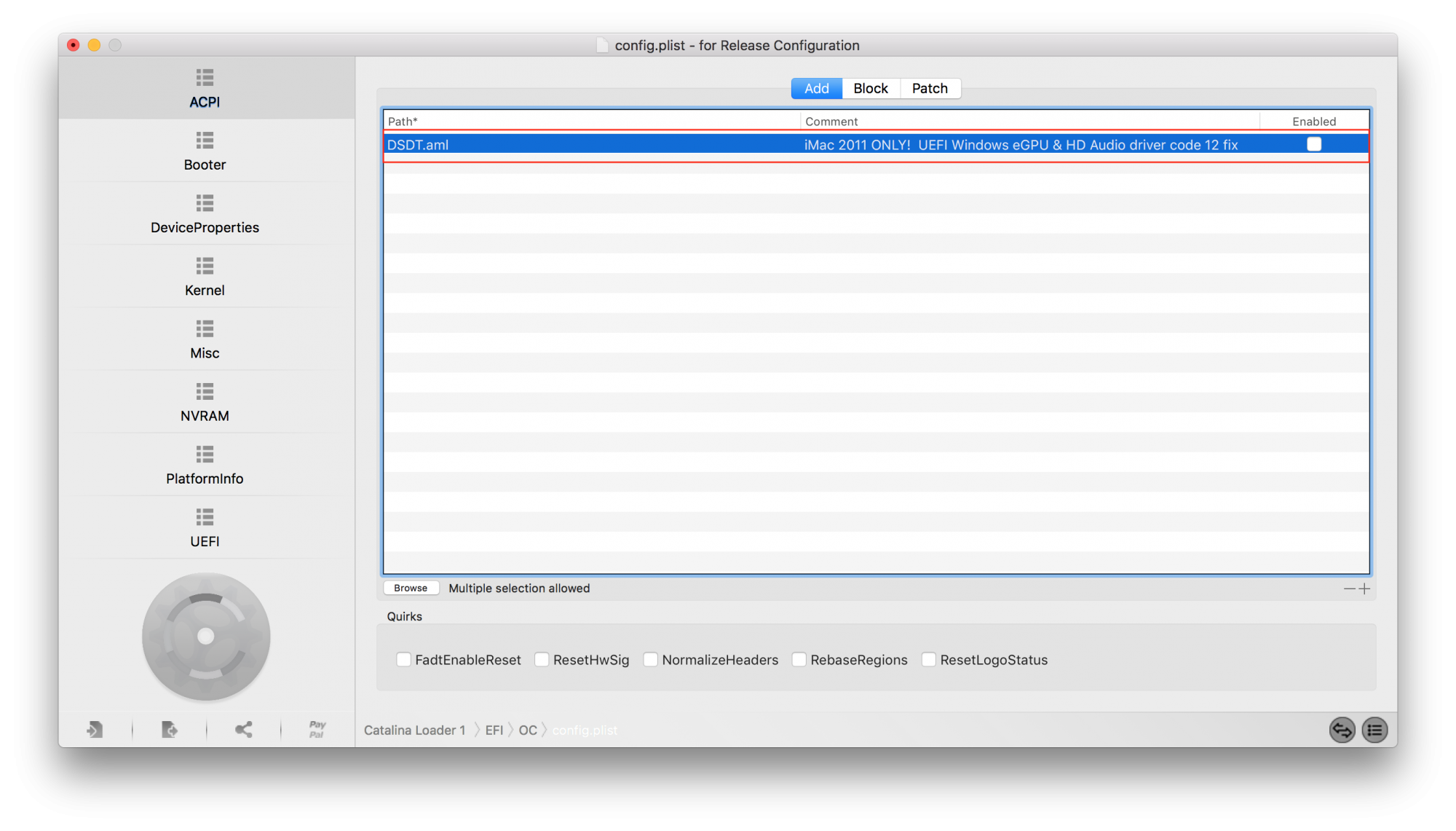

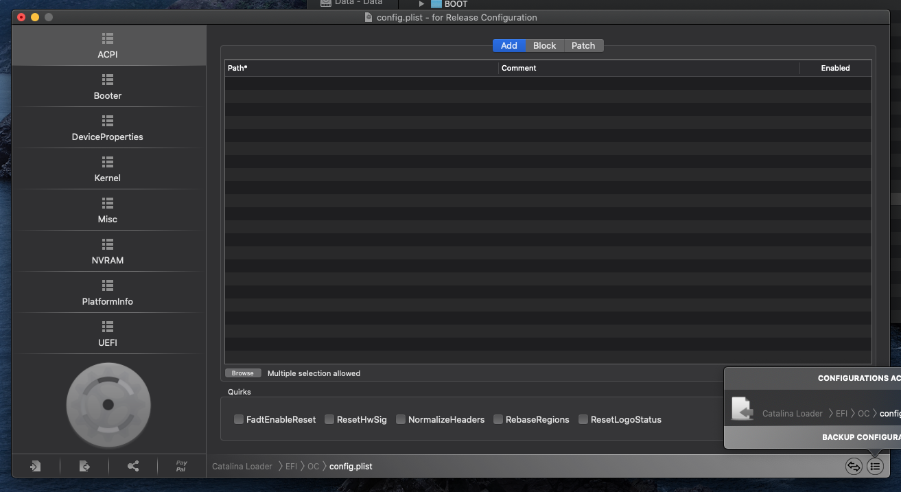

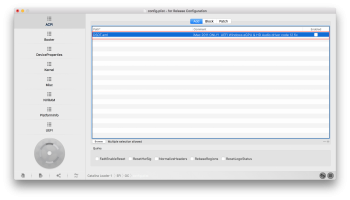

[7] UEFI Windows: Sound fix for HDAudio code 12 driver error,
can also fix some ThunderBolt eGPU resource issues in Windows.
(Enable DSDT in ACPI section of the OpenCore configuration tool)
Is someone able to help me locate the DSDT under APCI section in OpenCore Configurator? Opening the configuration tool brings up nothing? Unless I am looking in the wrong location or using the wrong tool?
It's currently 1:30am Eastern time for me, but i'll answer this. Right click in Config.plist and "Open with" Open Core Configurator. Then click the enable checkbox for 2011 iMac. click File>Save before closing.
Also make sure you are working from the Actual SD card/flash drive and not the disk image that could still be mounted.
