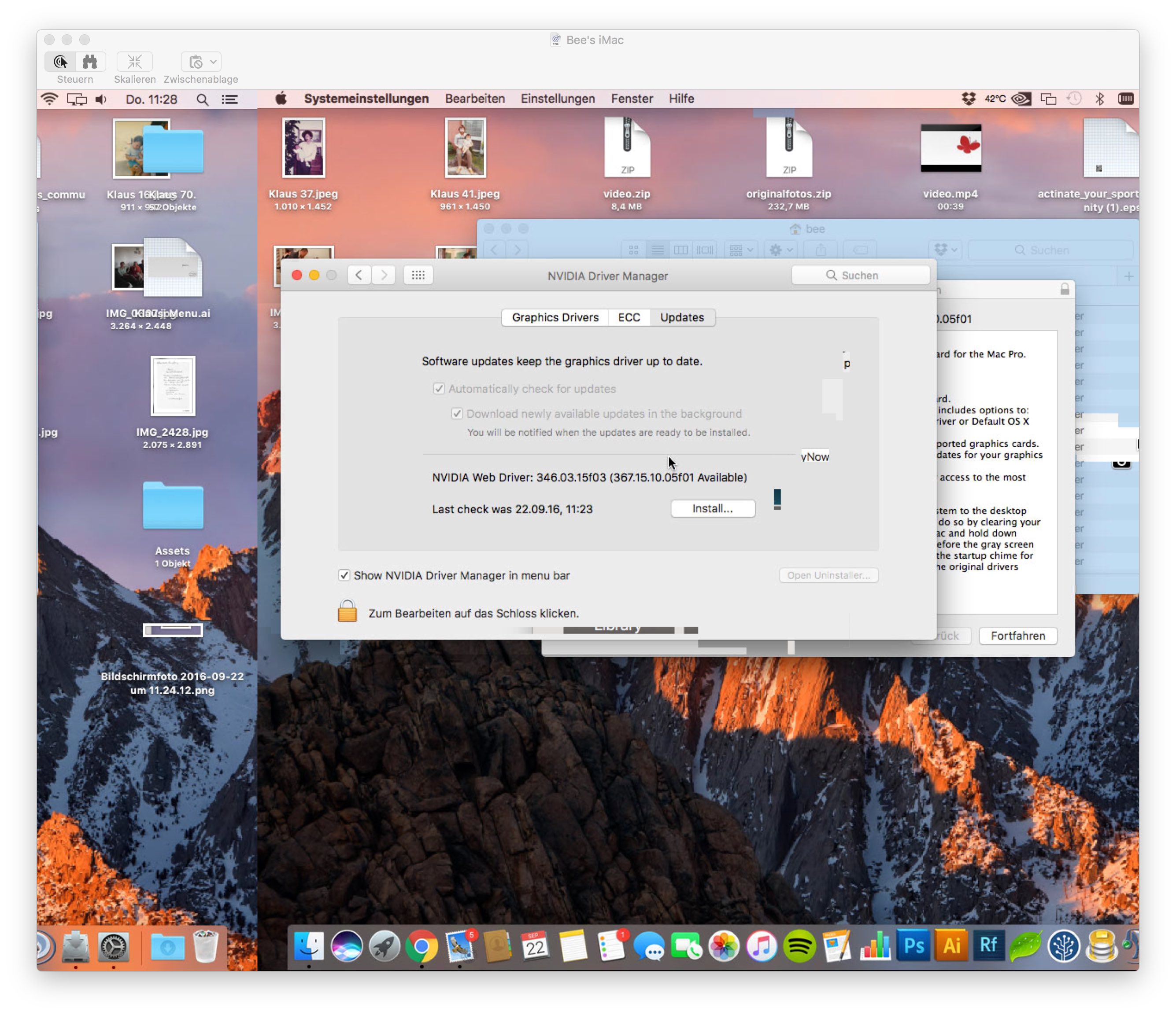

I tried to update my El Capitan to Sierra. The installation progress were running fine, but after the final boot the display keeps black, because the iMac is running a 1024x768 resolution. The connection via screen sharing works, but the screen is fuzzy. After installed the newest Nvidia drivers nothing changed. Display black, screen sharing is broken, resolution is stuck at 1024x768.
I'll give you guys an update if I found a solution.
