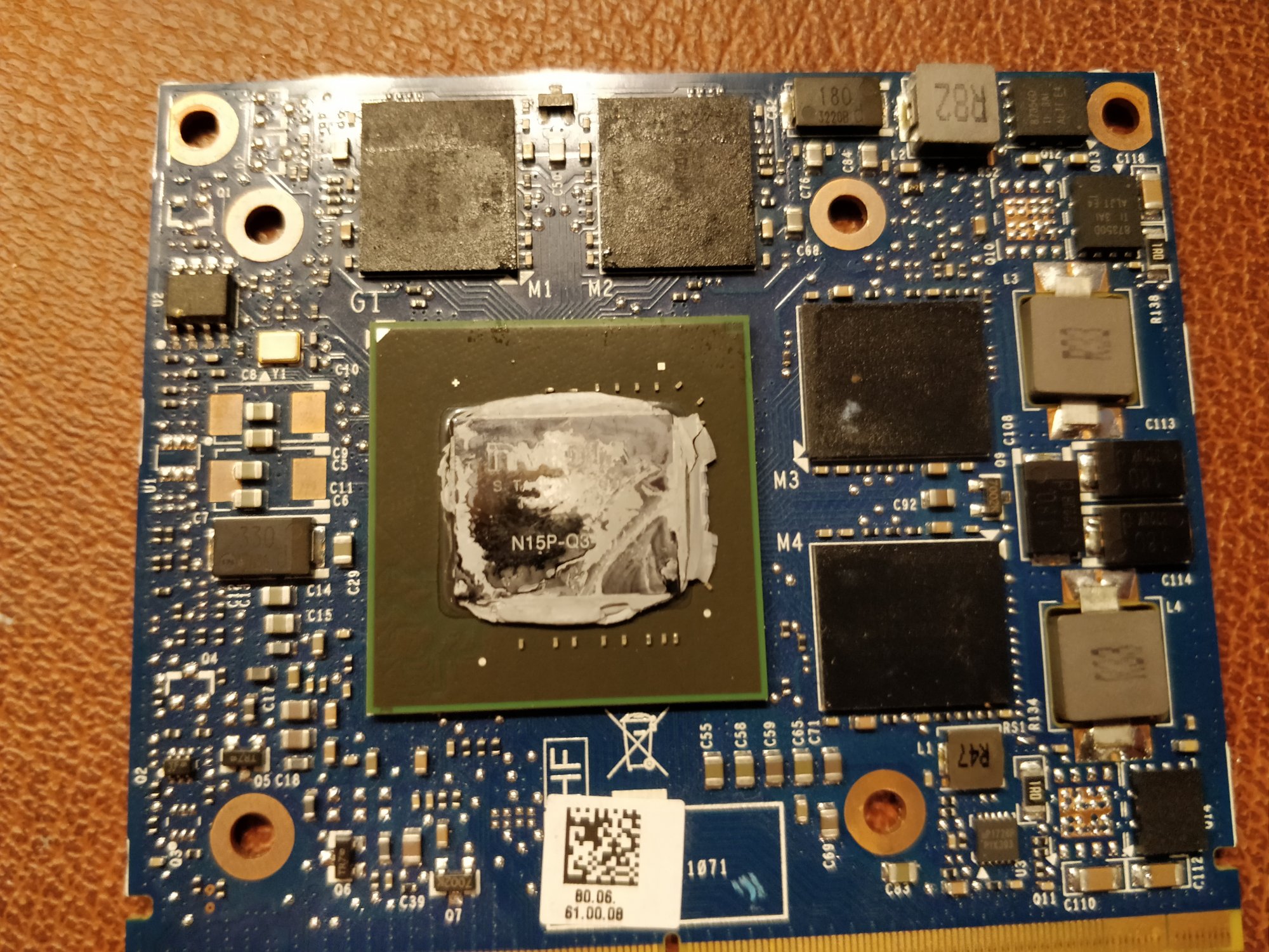

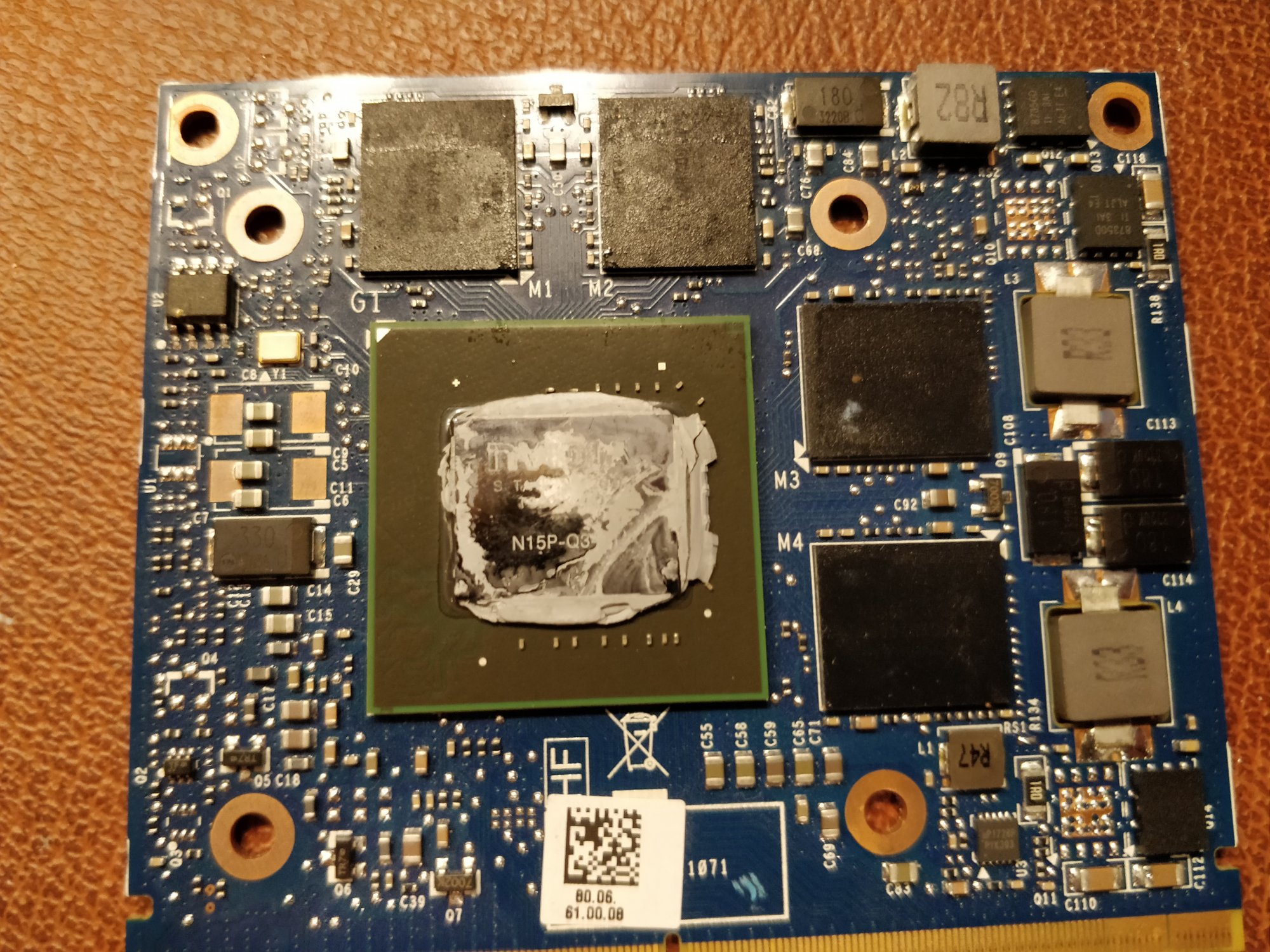

I choose NVIDIA Quadro K2100M: what is the marking on the HF Board? is this normal? on such video cards, there is no compound around the chip... is this the norm? (sorry if it was already discussed). The seller claims to have removed it from the Dell m4800

Hello,
Looks quite similar to my card and perfectly normal. Just use google and you will find hundreds of similar pictures of this card.

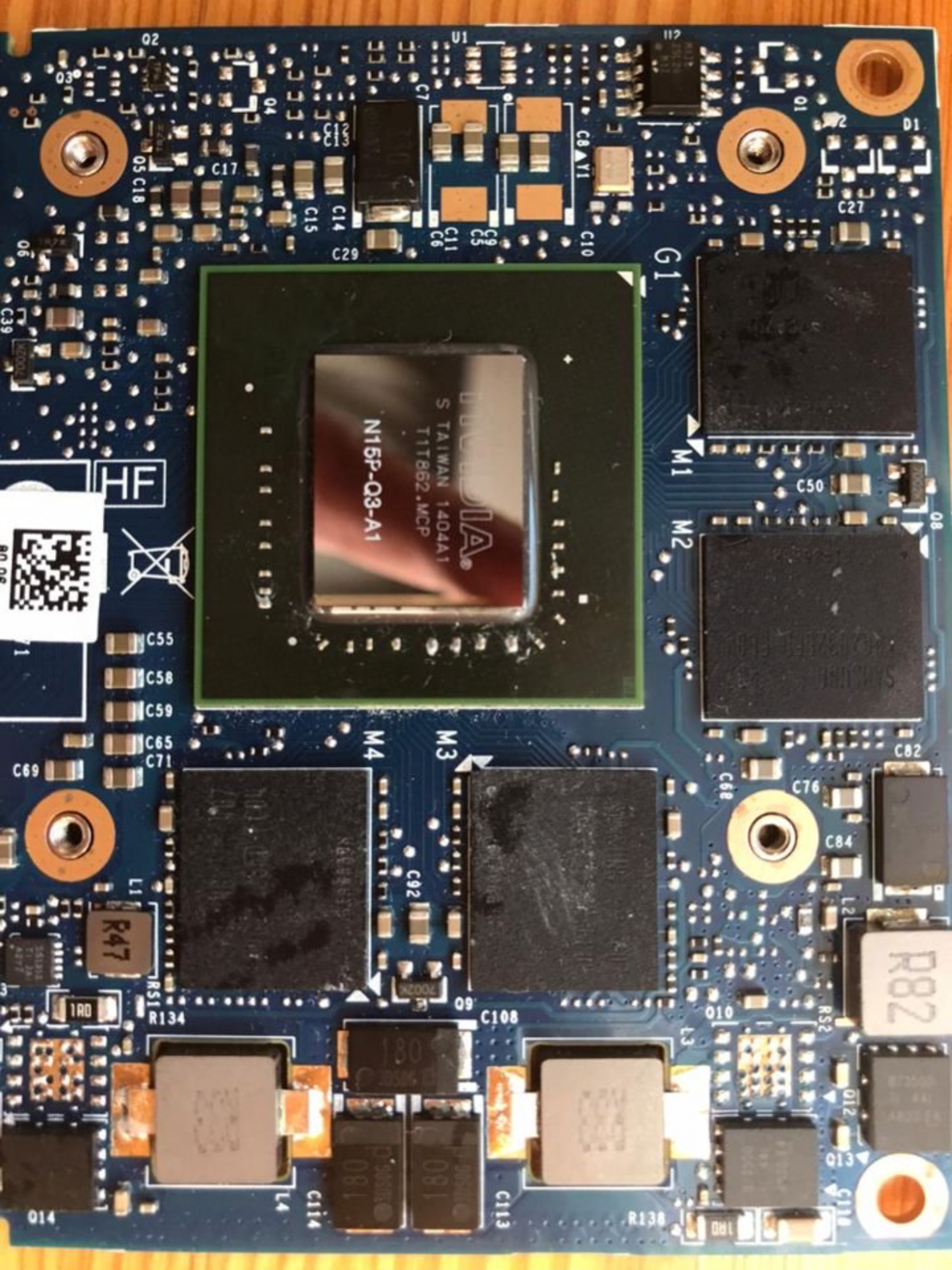

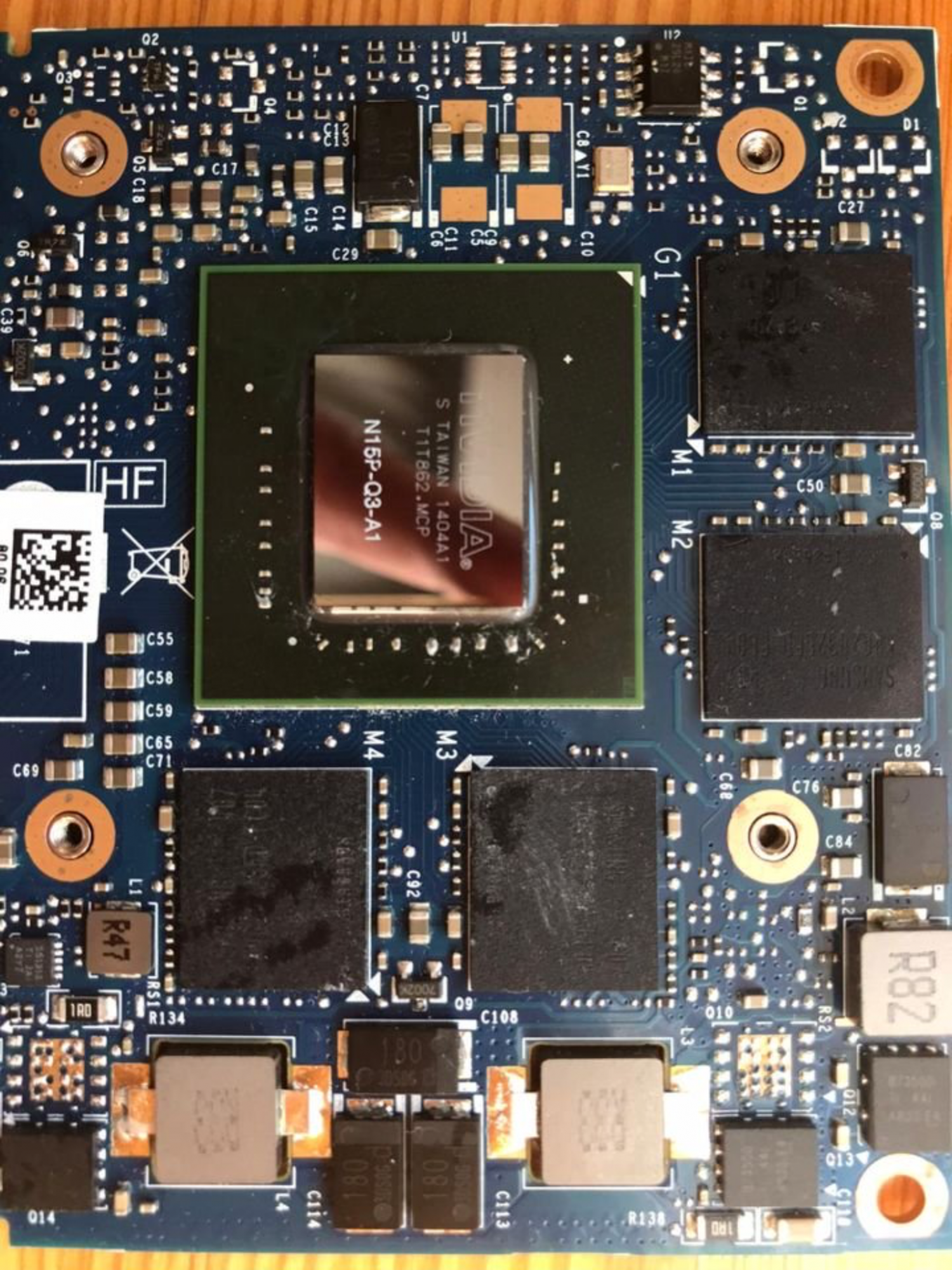

Hello,
Completely normal, here is how mine looked. You should have been more concerned with the Bios sticker that is slightly out of frame. If it's a dell card, which yours is, the Bios version is 80.06.61.00.08
BTW yours is probably the same listing as my card, also from a Dell Precision M4800.
