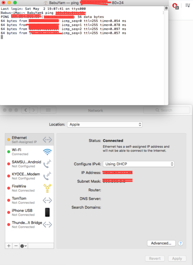

I feel like I am not doing something right --I tried formatting the FS on mac -- maybe I will try it from a windows computer to see if I can get a different result.
The Ethernet device does not have a valid IP nor is it actually connected to a network.
You need to boot your iMac with the Linux usb with Ethernet already connected. Your other machine must be on the same network (wired or wireless(unless using a guest network), best bet is to wire the ssh client device via Ethernet in a port next to where you plugged in the iMac.
Now you need to discover the IP the iMac was assigned (assuming you have dhcp in your wired network). You can find this in your router management UI, or by scanning for pingable devices in your subnet.
Once you have the IP you ssh from the working machine to the iMac IP.
Put another way, you do not wire the iMac directly to your MacBook.
I hope that makes sense...
@erihp -- Thank you, I had a feeling I was doing something stupid. I guess I didn't read how to establish ssh connection. Appreciate you spelling it out for me. Good news! I have the VBIOS flashed! Now on to Opencore.

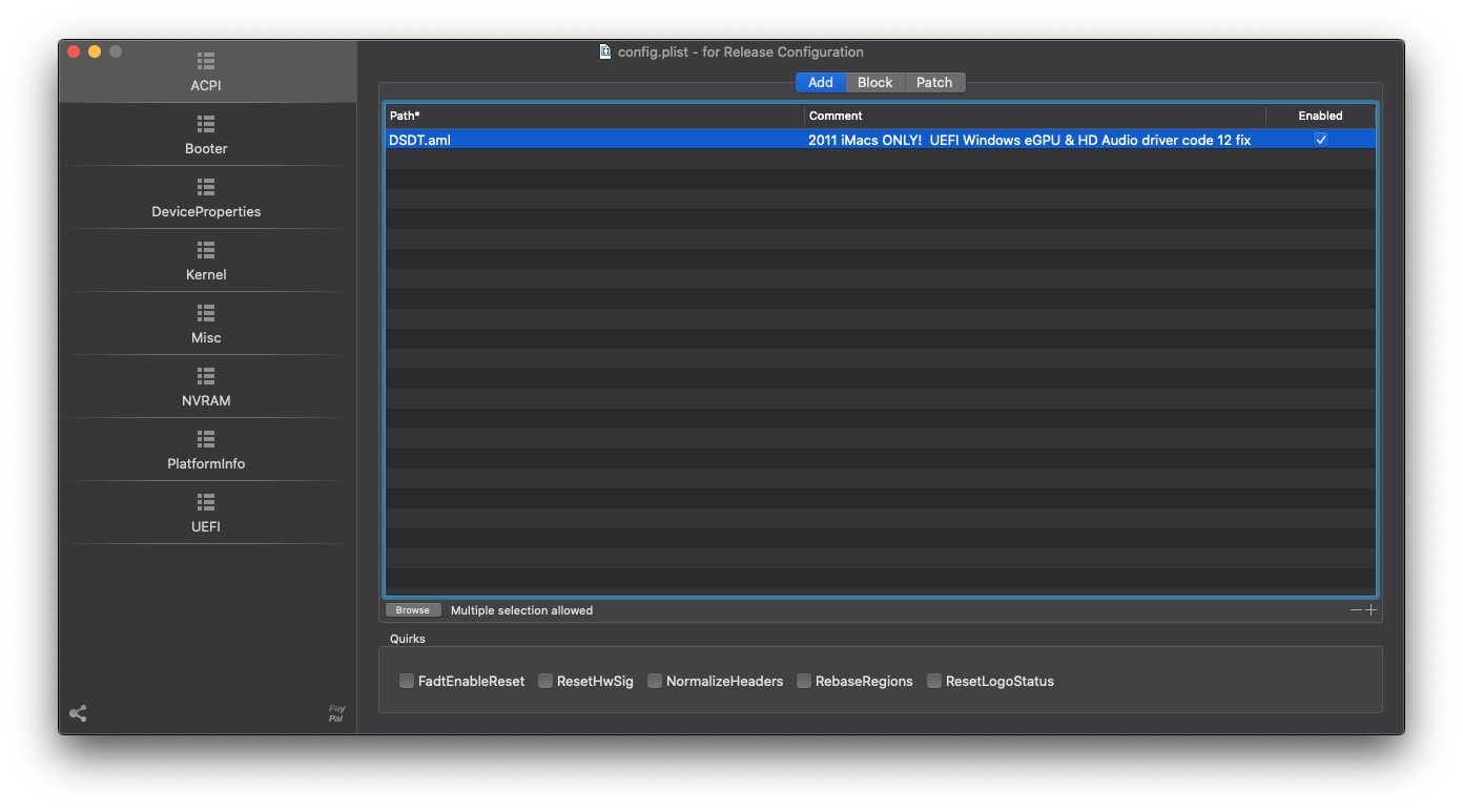

This is not related. The 2011 iMac will not have the internal audio working on Windows UEFI. The OpenCore bootloader fixed that by loading the DSDT directly into the opencore bootloader, or applying the DSDT patch through the registry. This is a 2011 specific issue. Booting legacy will not have that issue though.
I missed the instruction on setting up the config.plist properly but it's fixed now.
