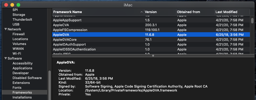

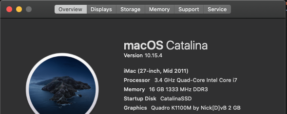

The only current issue that I still have with my 2011 27" iMac GPU upgrade (K1100M) is that I don't seem to be able to get QuickSync enabled. I tried to follow highvoltage12v's directions here, but no hardware acceleration when running Mac X (actually VideoProc now). Otherwise, Catalina update went great and has been running for more than a week now with no other issues.
Did I miss a needed kext somewhere?
I followed all of these steps, as well as the suggested OpenCore settings, but no dice. Everything else works perfectly. Backlight, Sleep, etc.
Any ideas?
Also, I wasn't sure if I can/should upgrade to future Catalina versions directly running w/OpenCore, or would I need to wait for a new patcher from dosdude1?
Any ideas?
Not a kext, you need to replace AppleGVA with the one from 10.13.6 located in System/Library/PrivateFrameworks, make sure you rebless it with Terminal. The file should be attached in the guide post #3271 Also make sure all the plugins/Kexts are in System/Library/Extensions.
Sorry not picking on you just repeating myself for other people reading as well. 🙂
