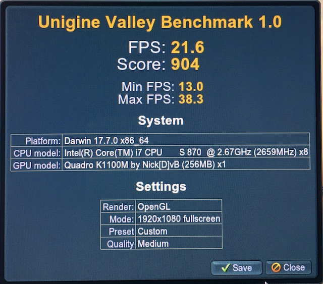

I was finally able to get my k1100m working in the 2010 21.5 and with Nick's bios, theres a significant performance boost compared to the original bios(score was 747):

Switching to ssd and K1100m seems to have solved it. Been running High Sierra at 3.4ghz for a couple months now without issues.
