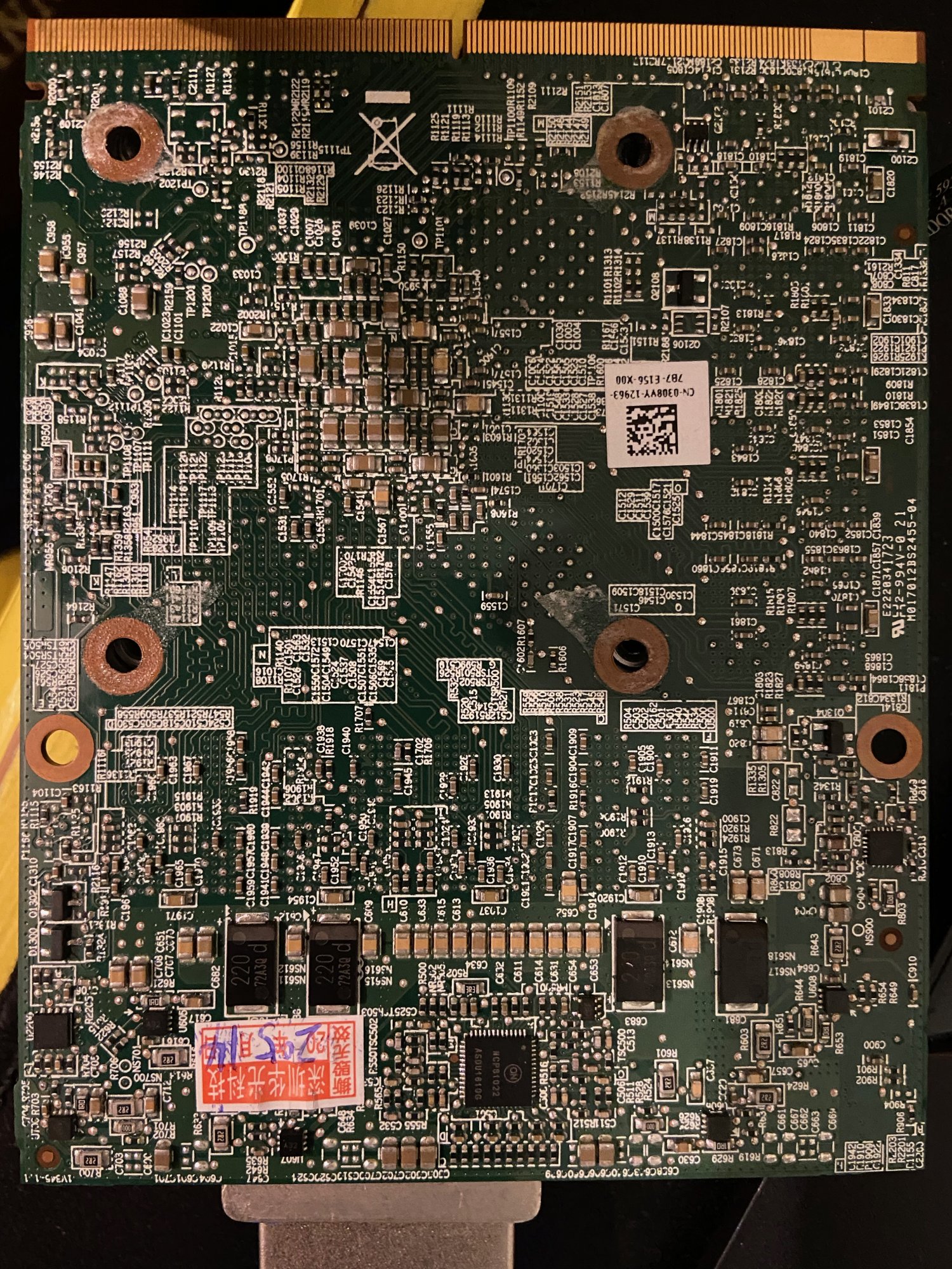

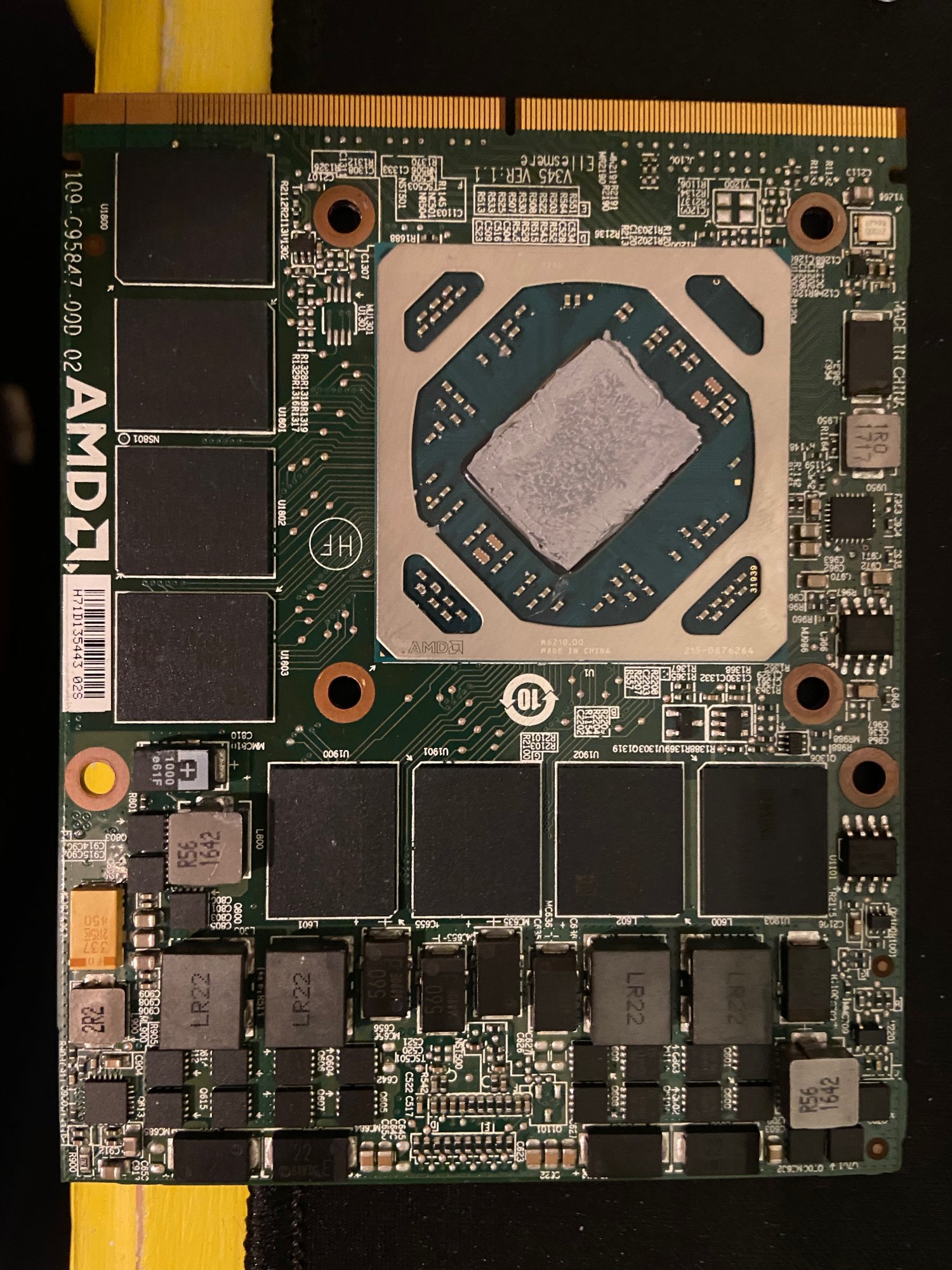

I ordered a card to have a go 1st card was gtx 765 2GB nvidia this worked well in both my 2010 and 2011 imac both are 27 inch so as I was happy with the results from the nvidia I wanted to try the wx7100 so I ordered the card as pictured below on from ebay.
It was listed as AMD Radeon Pro WX7100 8GB DDR5 MXM 3.0 Type B For Dell Precision 7710 7720 7730
The card I received is as pictured. Not sure if this helps in any way.
Thank you once again.

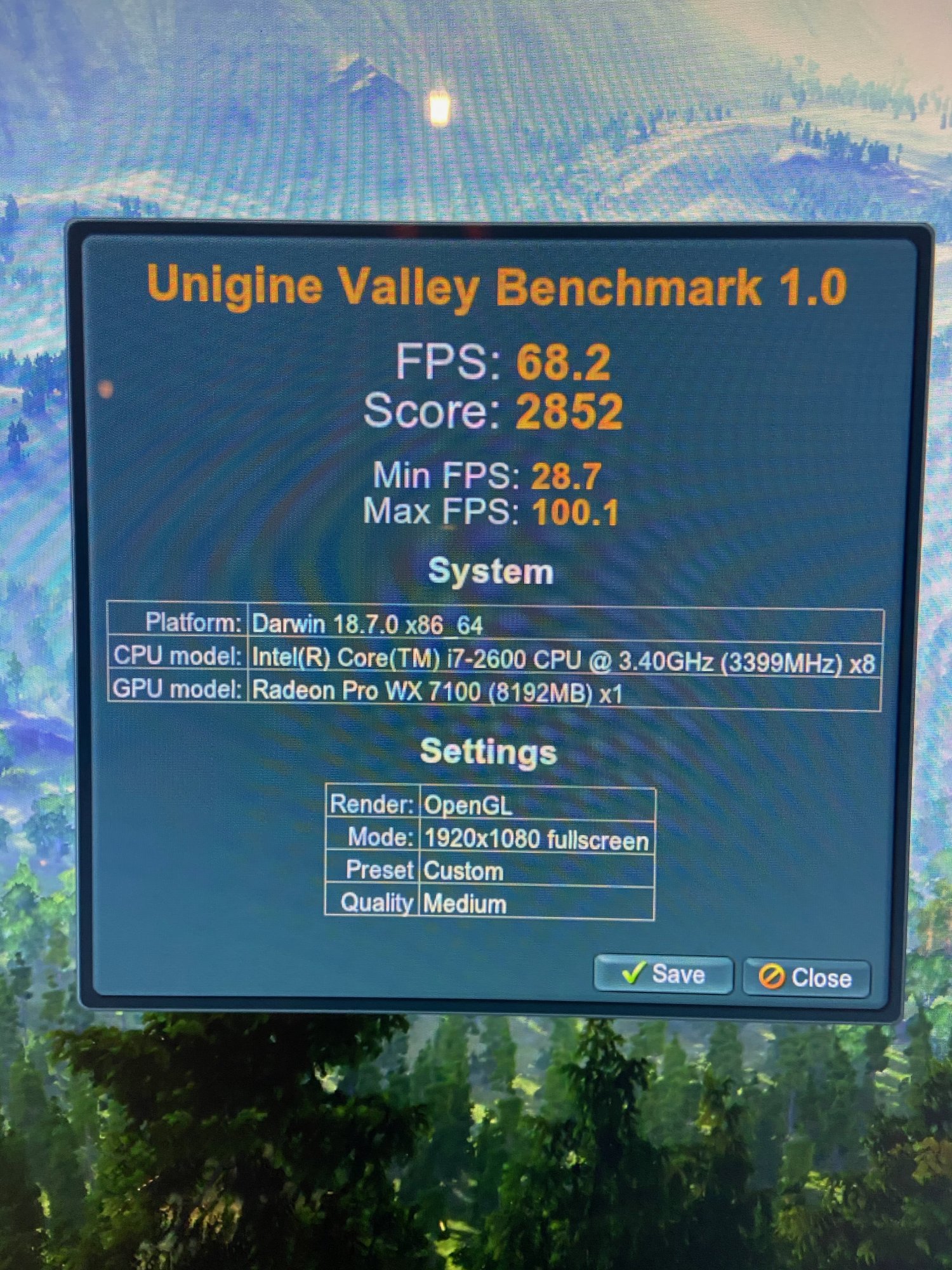

Can you clarify which of your 27" iMacs this WX7100 card is installed and working in? Is it in the 2010, or 2011? Also did you install the ROM with a clip and then it just worked, or were there any obstacles? Inquiring minds.
Edit: It appears to be the 2011, for the last screen grab shows i7-2600, and only the 2011 supports that, right?
It is very hit or miss with these cards and the 2011 iMac. Yes a 2600 would make it a 2011 iMac.

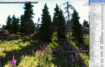

Im Mojave I got 1253/29.4 right after booting and 980/23.4FPS after letting the computer idle for a while.
In Catalina I currently getting 437/10.5 (I haven't tested systematically though).
I just I'noticed that the GPU clock is high right after boot and then lowered to 270 MHz after some time.
When running the Valley benchmark the GPU clock does not rise beyond these 270 MHz though it's rated at 667 MHz...however the CPU throttles happily from 1.6 GHz idle to 3.1 GHz.
So my issue seem related to GPU power management and not CPU PM.
Hi yes its the 2011 27 inch iMac its in I flashed it from within windows 10 on the iMac, no obstacles I used a clean install of windows 10 and this was the only hard drive attached IE I unplugged the OSX drive and made sure the machine booted direct to Windows
Hi yes its in the 27 inch 2011 12,2 imac I unplugged ssd drive with OSX installed and plugged in an SSD with Windows 10 booted to that and flashed the card from there, no obstacles just used the info from this post.
