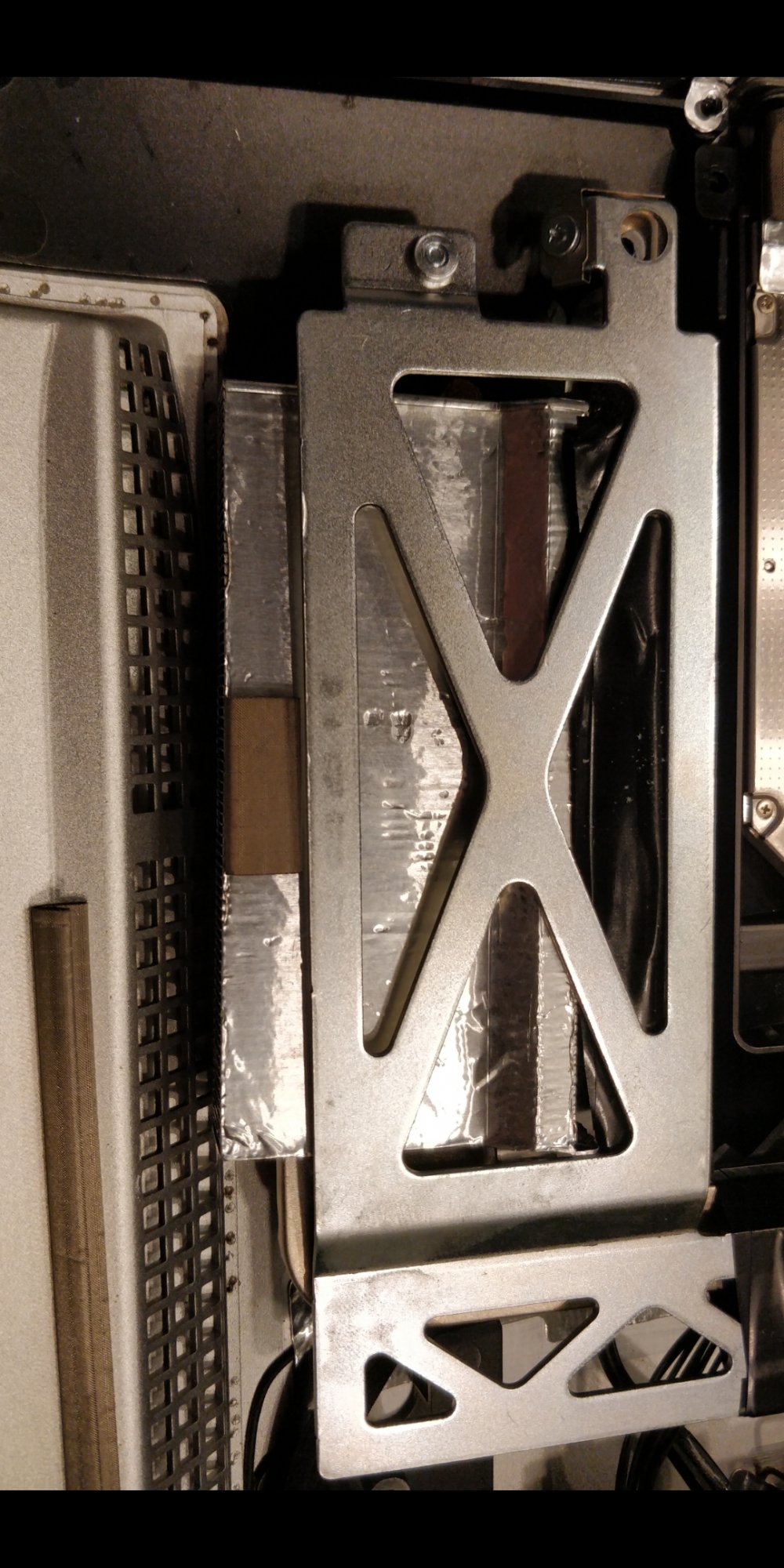

If your iMac 27" shipped with a 6770M installed then you're in luck, there was a 2 pipe heatsink used in those models. Personally I use a 21.5" heatsink in my 27" model, the 21.5" heatsink is actually longer than the 27" heatsink so I got creative to use materials inside to extend the duct.
I added a picture of how the heatsink will extend past the bracket and won't screw in anymore, doesn't bother me.

You only need to modify a heatsink for the larger MXM cards, the quadro k2100m is your best bet currently as you don't need any physical modification beyond either tapping out the xclamp or using larger mounting bolts as mentioned in the original thread

If you want a k610m/k2100m/k1100m or WX4130 the MXM-A heatsink that the 6770m uses fits those cards perfectly.
If you want to use an MXM-B card you need the 6790M heatsink and need to modify it by grinding down the upper area with a dremel, MXM-B cards are the 765m/770M/780m/k4100m/wx4170/wx7100.
