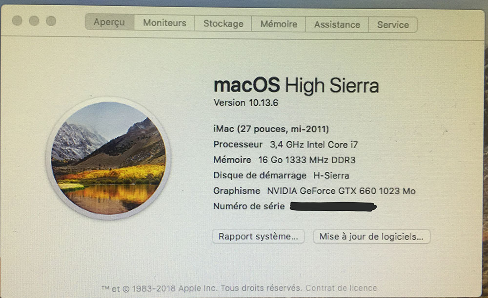

The news
using the second iMac 27 with a k2100m using an external screen
- black screen main screen, chime but no apple logo
- the K2100m flashed with Nick modded vBios is recognized as.... a Nvidia GTX 660 1023Mo !?!?
on the gpu it's written N15P-Q3-A1 and this means Quadro K2100M 2Gb, so what's wrong?
with the k1100m nothing 🙁

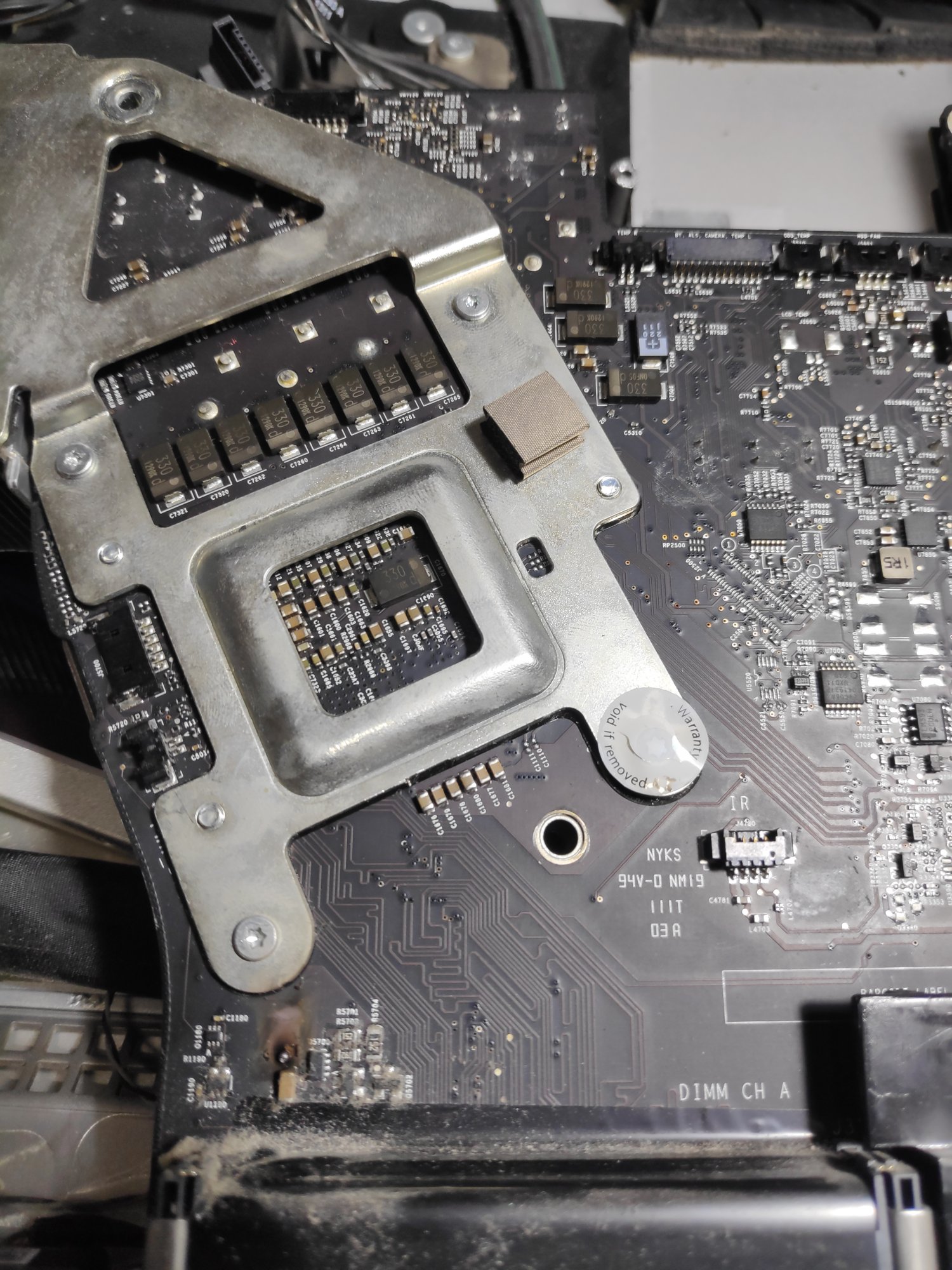

Hi, so I tried to upgrade my iMac 21.5 11' gpu to k2000m, disassemble everything, putting on the GPU and I try to check the led diagnostic before putting on the LCD.
At first there were only one led turn on. I unscrew the logic board and check evry cable at the back in case I miss something, then screw it back on and plug in psu and power cable.
As I was pressing the power button, I saw a spark on my logic board
As you can see on the bottom left 😣
I don't know what went wrong but yeahhh, goodbye logic board
