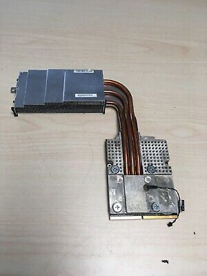

It's 2 heatpipe but it's still MXM-B. I can't find any 3 heatpipe MXM-B heatsinks for sale. They still have cards attached to them and want obscene amounts of money for what is basically hot garbage. A 2 pipe MXM-B heatstink is still better than an MXM-A heatsink as there are components that need to be covered for cooling.

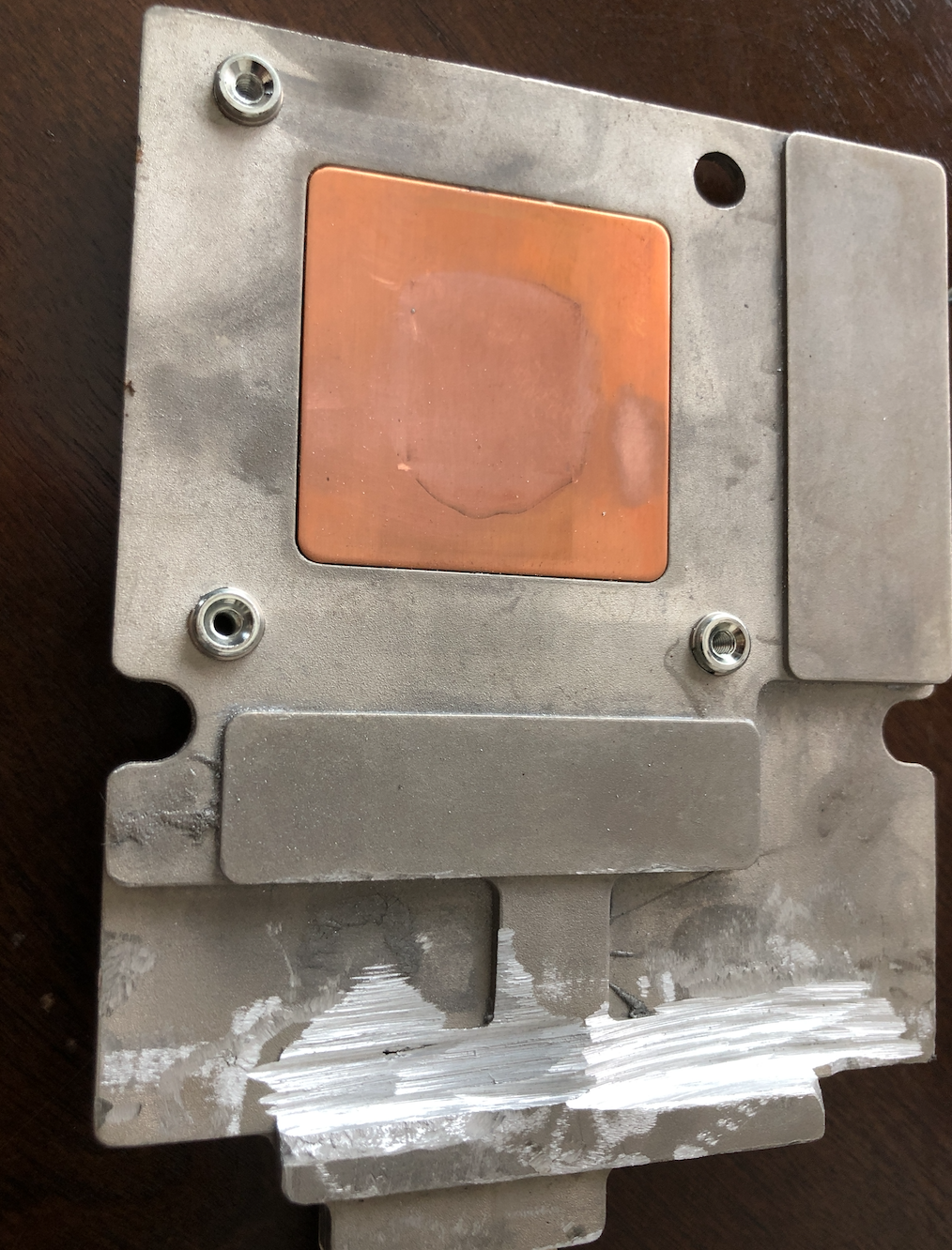

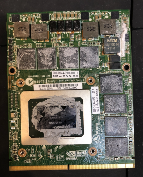

Well, sad news. I assumed something and once again it proves why I never assume anything.
I ordered a 3000m and not a K3000m. No metal support I'm told. Which was the whole point of this exercise.
Yes. I knew I needed a k3000m. Yes I read the 1st post. Yes I verified the chip was an N12E-Q1-A1.
But then made the leap to 'that cheap $25 3000m on ebay must just be so cheap because it doesn't yet have bios support for us imac people yet.'. And 'It's the exact same chip N12E-Q1-A1 mentioned by @nikey22 so that must be it!'. Nope.
Note to self: Again. Never assume. Every detail matters. You know this. Don't do it again. Even though I do it from time to time still when I get lazy. Lazy = costly in time, effort and money.
Hope this helps out those who come after me. Including my future self. 🙂
Also, just to share more lessons learned, I spent 45 minutes last night with a dremel enlarging the heatsink. Bit finally broke and I was still only half way done. It must have been too dull to be efficient. Today I just used a full sized grinder/cutter and did the whole thing in 3-5 minutes. Not pretty, but functional.
I'll attach pictures below for others' benefit.

You are using a big MXM B type 2009 or 2010 2 pipe heat sink. Interesting to see if this works out on the long run. I never found the TPD of the 4850 or 5850 cards used on this sink type before, but I assume that Apple changed the hardware design of the sink with the 6970M card for a reason. All MXM-B Nvidia cards listed on page will draw the same power as the 6970M on average and according to some widely unknown laws of physics (which cannot be bent by people) it will create heat in the same amount.
