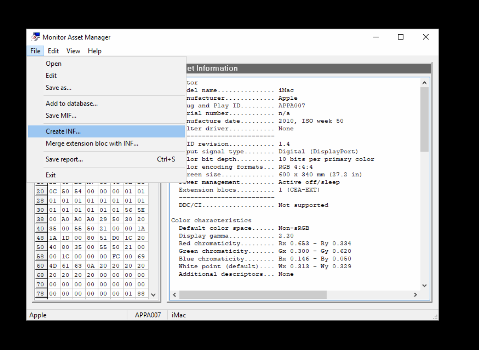

Long shot... but can someone with a working windows install/2011 iMac export their monitor settings as an inf for me?
https://www.entechtaiwan.com/files/mi_setup.exe
