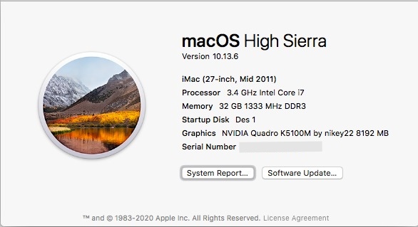

Done my mod last night after the second 6790m failed to work. I have replace the original bad 6790m with another 6790m a year ago. The second 6790m decided to rest in peace after one year, so now got myself a K5100M.
Also upgrade the CPU to i7-2600 3.4Ghz, the old CPU was a i5-2400 3.1Ghz.
Flashed the rom with SSH, everything went smooth. The new K5100M and the i7 CPU works like a charm.
I am staying with High Sierra at the moment, just to make sure everything stable.
Expected boot screen and screen brightness is working, sleep also works fine.
I am planning to move to Mojave later, so question is, is the sleep problem only occurs in Mojave and later OS? Because now seems fine with High Sierra. I didn't do any software patch or mod except flashing vbios.
I also use the original X bracket that come with the K5100M, just drill the holes to fit the screws.
Big thanks to nikey22 for the custom bios and xanderon for the SSH method.
