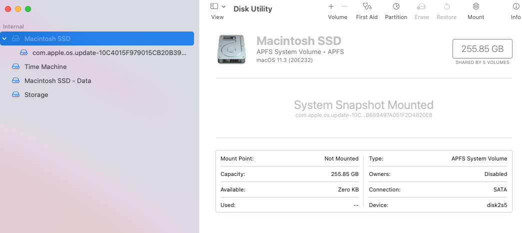

Another thing I noticed in disk utility is the presence of another container (com.apple.os.update...) inside my boot partition. It shows as a system snapshot. Is it normal?
