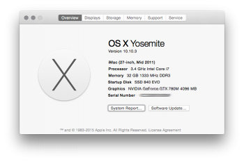

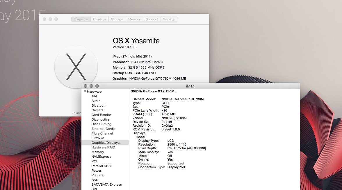

I did it. Thanks for all your guidance especially from MacVidCards.
