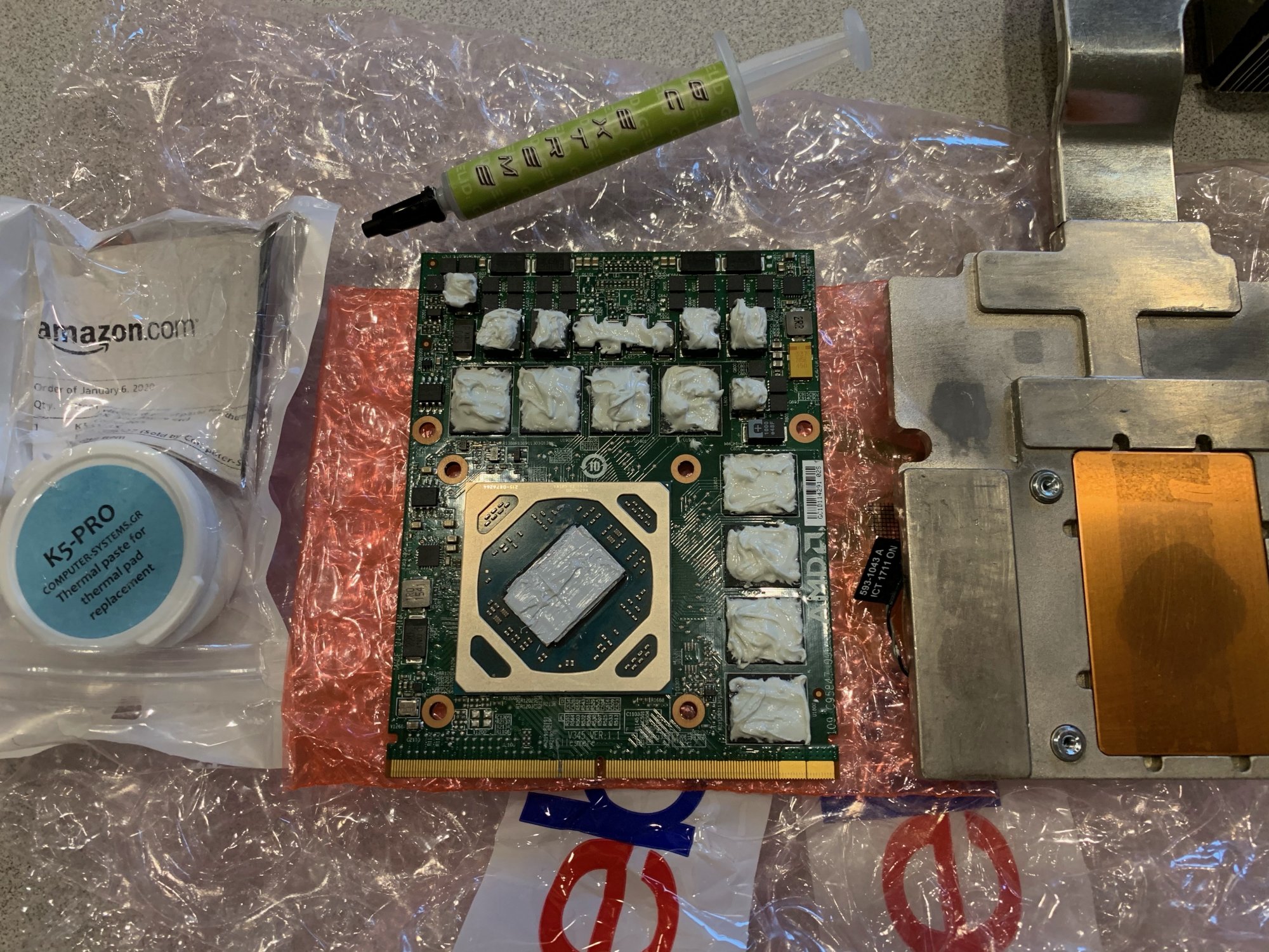

I'm about to embark on an upgrade of my second 2011 iMac 27" with a WX7100. I did my other iMac a long time ago when the GPU failed with a K3100M.
I see some posts that say I need a copper shim for the heat sink and some that say the WX7100 doesn't need it. Recommendations? Which size should I buy if I need one?
I've done two WX7100 cards and used a thin copper GPU on the second one. That said, the first one I did is in a machine I use daily and it has never given me any problems. I did use a generous glob of K5-PRO on all the non-CPU contacts during both installs and I suspect that helps spread the pressure out and prevent contacts that could result in a short with the 3-pipe heatsink. Here is a picture of the one I did with the shim which already has a thin coat of paste on both sides.
https://forums.macrumors.com/attachments/img_6864-jpg.1746287/
thanks, I have the same K5 goo for the non-GPU parts. It looks like I can do without the shim so I'm going to go for it.
