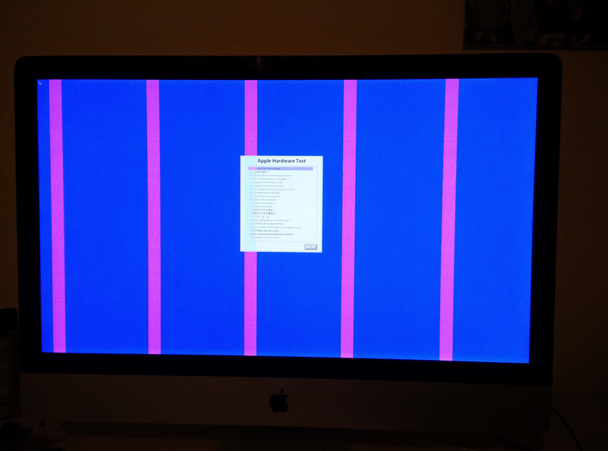

Hi all I'm having issues with my 2011 iMac see below:
Does anyone think this may be related to the gpu recall? From talking online with apple they said to book a genius appointment to get it repaired but I'm not sure whether it'll be costing me (if it's worth it) failing that it may be the excuse I need to upgrade to a retina iMac
Try to get it replaced for free under the program, even if you're planning to upgrade.
I was thinking that I could at least get some money for it if it was fixed.
Do you know what they actually replace? Will I lose data? (I've got backups so it doesn't matter either way)

Looks entirely like the GPU problem the recall covers, so you should get it repaired free of charge.
Don't expect them to preserve the data, even though that shouldn't be affected.
It is a known issue on the 2011 iMac.
Luckily for you, Apple currently have a recall on the video cards you probably have.
https://support.apple.com/en-us/HT203787
We had one of our 2011 iMac's repaired for free displaying the same issues just recently using this recall.

On my MBP (exactly the same issue) they replaced the logic board (and even the battery even though that had absolutely nothing to do with it... Strange). No data lost because nothing else was replaced. On the iMac, they can replace the GPU without replacing the logic board. I find it unlikely you'll lose data, but hey, they might follow a standard procedure involving an OS reinstall.

They did a week turn around on our machine. Buy they also had to replace the LCD display (for free also), as there was burn-in at the top corners which I assume was caused by the faulty graphics card, as the machine was out of warranty.
So could be quicker, if it is just a card swap.
As it seems that you are in London also[?], I always request to use AMSYS. I have used them a few times before with AppleCare repairs on our machines and are great. I do not always trust the Apple store engineers as I feel that they take things too personally and do not always look as objectively at an issue that an independent approved repairer would.
Just my experience of course…
Our display, was doing what yours is doing intermittently and would resolve on a restart [or 2], but always go wrong a day or 2 later.
So when I ran the AHT (Apple Hardware Test), it did not pick up any issues on the first 2 runs. So it is important that you have a photo of it going bad, as they charge £60 for a diagnostic if the machine returns with a pass.

Well they couldn't replicate it! But they have booked it in and I emailed them my photos of the issues.
Very happy. The genius was really nice and helpful
Well just heard back from apple.
Apparently it's my display at fault and it's not covered by the gpu recall.
£500!!!!
No thanks I'll save it and put it towards a new one, just a shame as I wanted to sell the old one for some cash towards it
OP: quote the SoGA when dealing with Apple. My mid-2011 iMac 21.5" displayed a pink line (at the bottom of the screen in my case).
I took it into my authorised reseller here in Derby (KRCS) and that's what they told me, that the LCD had failed.
They quoted me a similar figure (from Apple) and when I said that it wasn't fit for purpose and should last much longer (especially as it cost me £999 brand new) and Apple agreed to replace it free of charge under the SoGA.

Fired it up yesterday and within minutes I had issues.
I have now plugged in a thunderbolt monitor and it replicates the issues on the external monitor, surely this can't be the display at fault?
I am going to book a genius appointment for a second opinion if they'll let me?
I have photo proof and a video of both monitors flickering like crazy.
I hate to play devils advocate here - but from the ones I've seen that doesn't look like a symptom of the GPU failure in the recall.
With the thunderbolt display, are the lines in the same place, same colour, and do they change as the on-screen content changes?
It's very typical of a GPU failure. I've seen the same on the 2011 MacBook Pro with the same AMD 6000 series GPU issues.
